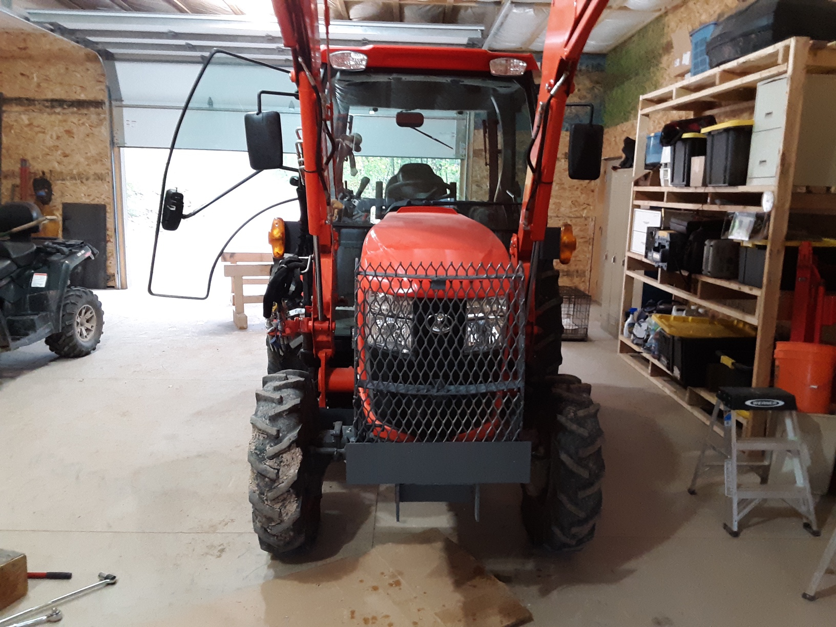

I agree that a good grille guard is needed but how much light do you get through it when needed? Some of the expanded metal mesh is pretty tight. Seems like something more easily removable might help. Or is the whole guard removed when the grapple is off?
/ Looking for the right Rake Grapple
#22
If fabricating myself, I might be inclined to try to make it in two sections so that the upper portion could easily be removed to clear the lights, but there would be no reason to remove the lower (or upper, if not needing lights) -- seems protection wouldn't hurt with loader bucket, pallet forks, etc. One good answer might be found in a video I recently watched where the guy was talking about finessing tractor work, and not bullying with a tractor. That alone could help protect your front end. He likened it to billiards.
/ Looking for the right Rake Grapple #23
Being able to easily remove an upper section is a good idea. Might work on one next year since I just bought a post/tree puller for the quick attach that may also be a reason to have some protection in this area. Was going to buy a grapple but the multiple month wait allowed me to evaluate other implements I could get in a much quicker time period. Maybe next year the grapple market will cool down.
/ Looking for the right Rake Grapple #24

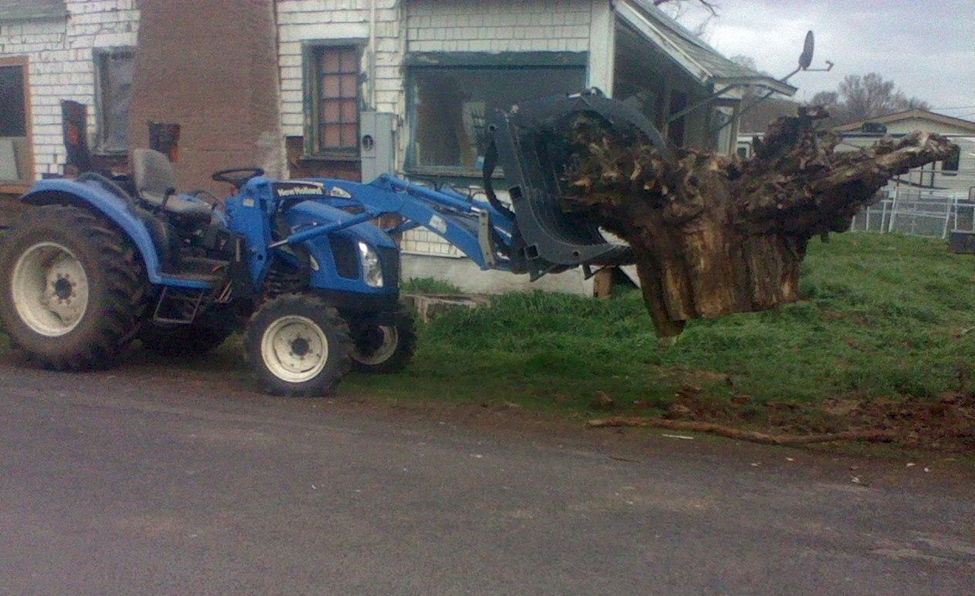

I just welded expanded metal on the guard that came with the tractor. Doesn't win any ribbons for beauty but is fully functional.
#25
Looks very effective, Citydude.

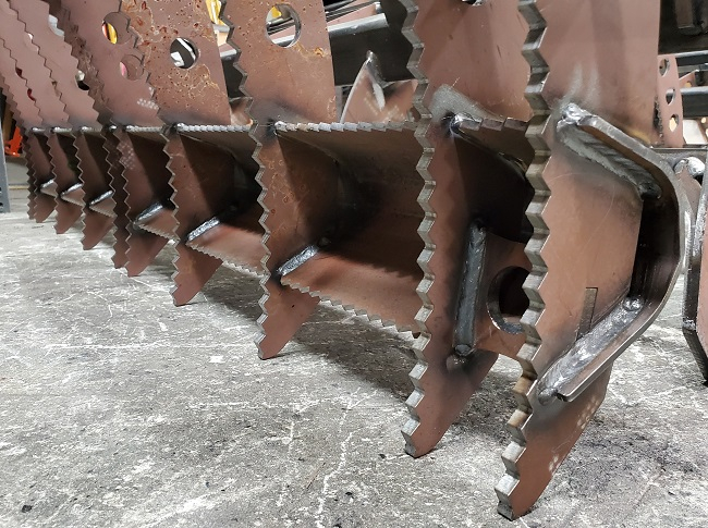

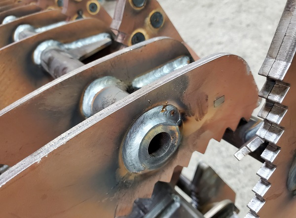

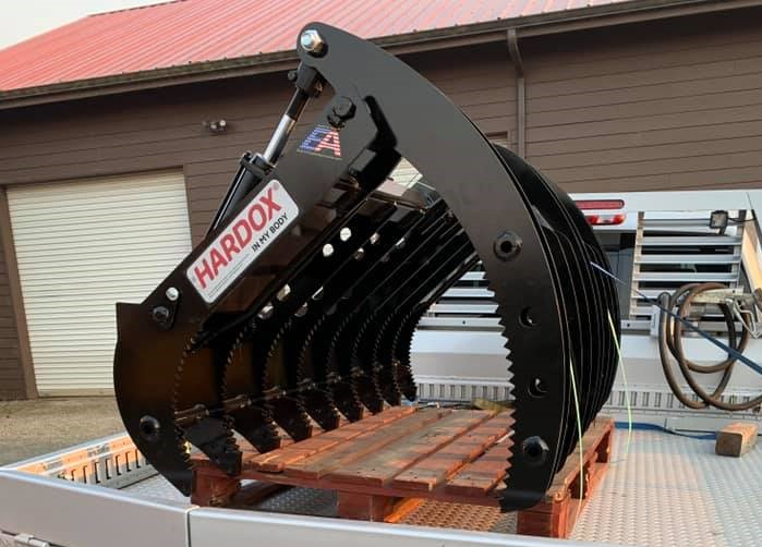

The Wickeder lid has a serrated horizontal channel spanning entirely across the leading portion of the lid, which greatly increases the lid's ability to rake loose material into a pile, or groom and smooth soil for seeding. Raking backwards, even if it is loose material, is something that most other manufacturers do not recommend, which totally defeats a valuable feature in which a true root rake grapple is designed for. WICKED is a TRUE root rake grapple.
Travis
If anyone doubts strength, even a little bit..
#27

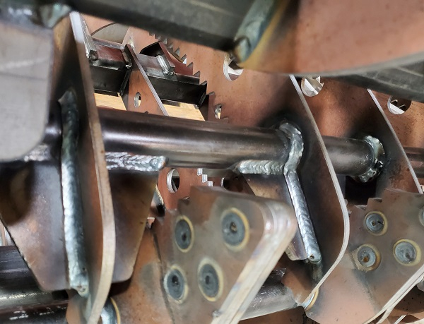

Travis, that Wickeder channel must really increase the rigidity of the teeth. I'd be a little concerned about scooping dirt in it when forward raking, but only a little. Is that feature available on all models -- how about 66"?
/ Looking for the right Rake Grapple #28
It does make it rigid, and the thiiick DOM tubing we use also does. Since it is on the lid, it'll be used for raking in reverse, and the lower tines still have DOM tubing for structural support. The Hardox channel Wickeder lid is featured on our Wicked 55 and Wicked 60 models.
Wicked 66 still has freakishly DOM, and not the Hardox channel.

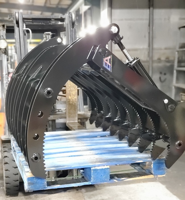

Thanks for the info, Ted. And not to give you a hard time, but why would you replace DOM with Hardox channel on 55 and 60 but not the 66? I know the DOM is super-thick, but it was that way on the 55 and 60, too, and your video said that the channel was 3x stronger than the DOM. Don't deprive us who need the 66! :)
P.S. - Makes sense that the channel would not scoop dirt on the top lid. I wasn't thinking.
/ Looking for the right Rake Grapple #31
The design change on our 55 and 60 was originally implemented due to necessity, because we couldn't get a particular thickness of DOM round tubing. It worked very well, and added another EA created puzzle piece vs outsourcing additional material, so it stayed, and gives us yet another feature which can't be bought elsewhere!
Concerning the 66, that beast is recommended for some heavy, capable machines such as tracked skid steers and tractors like our M6-141, which we punished it with, so if we changed its design, the Hardox channel would need to be thicker. If you know Hardox, you know it doesn't like to bend, so bending the thickness used on the 55 and 60 was really a first, and something they said couldn't be done, so I don't think tackling a thicker one is feasible.
Take a good look at this freakish stuff, and try to imagine any material being stronger. Also, try to find it on any other tractor grapple on the planet!!!

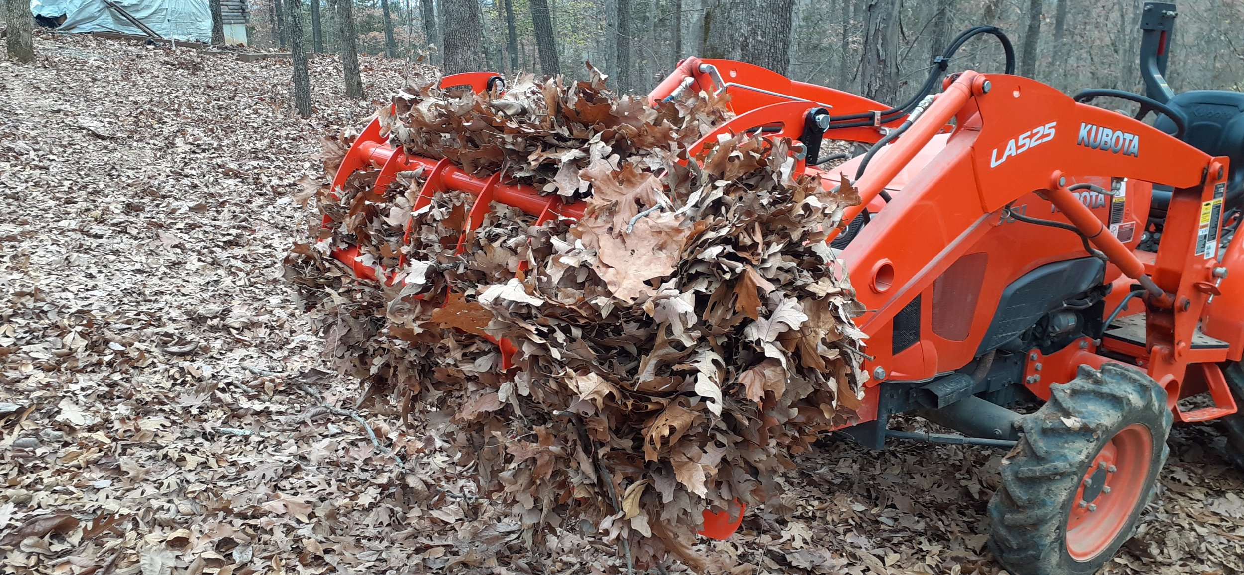

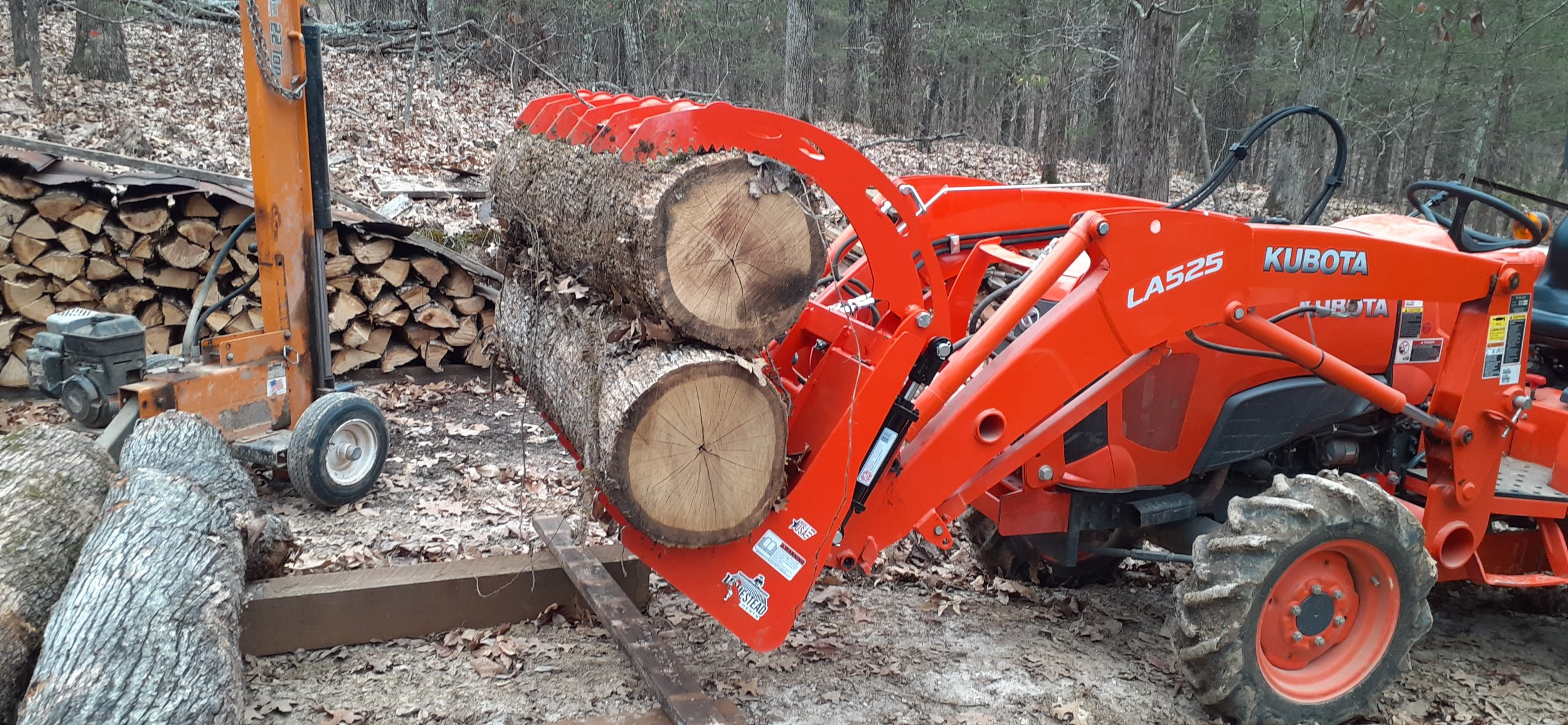

I know that the OP has already order is grapple, but I thought I would mention the Homestead Implements grapple that I have. It is the 55" Root Grapple Pinnacle Series.
I found that picking up leaves works pretty good with it. I wasn't sure if they would stay in the grapple or not.
I have been very happy with the grapple so far.
