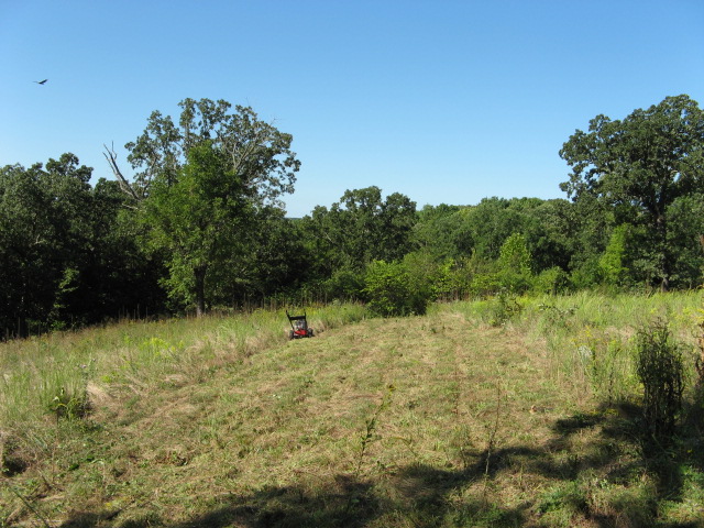

The Swisher walk-behind brush mower, yesterday morning:
Man I would call that "over and above the call of duty". Did you show Swisher your picture? Bet if you did they'd re think their position. Grin. You ought to be some kind of pooped out after cutting all that.
Mark
