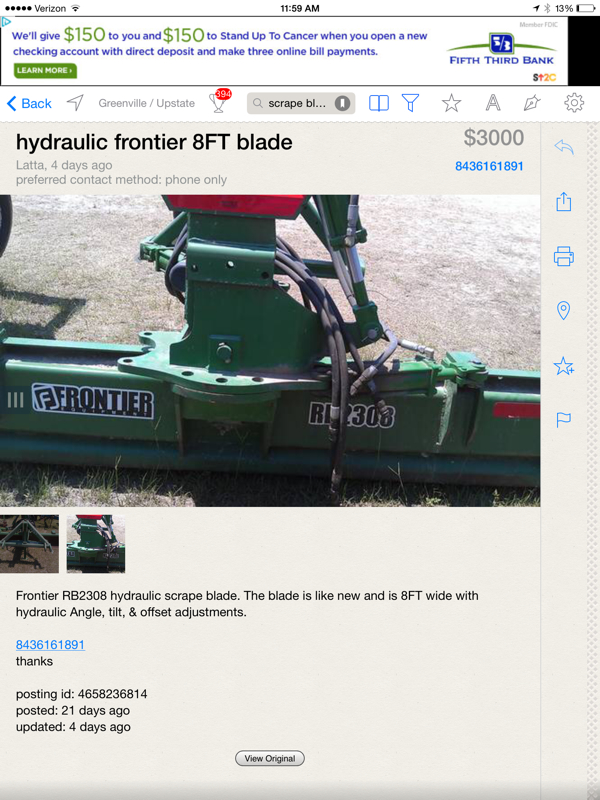

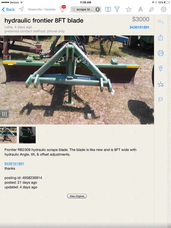

/ Looking for rear blade with hydraulic angle #4
Here's one for sale in my area. Wish it was mine. Have no idea if price is good

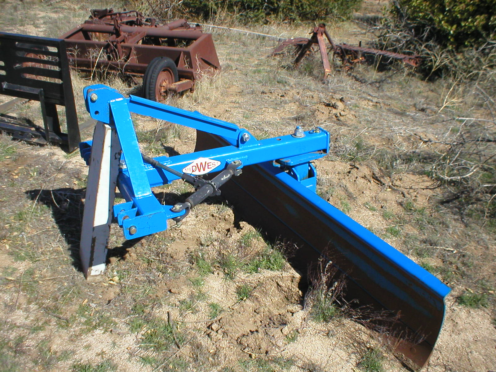

/ Looking for rear blade with hydraulic angle #6
IF there is a manually adjustable with a ratchet, just replace the ratchet with a cylinder? If you are comfortable welding, you could add eyelets for the cylinder as well.
What I think you are thinking about is the more economical off set models, and even then the way that those are set up, you only have offset to one side or change the hydraulic or ratchet to the other side.
I have never seen a ratchet system for angling the blade left-right. :confused:

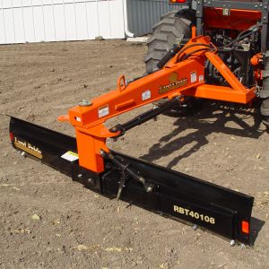

/ Looking for rear blade with hydraulic angle #7
I thought i was looking at some woods? or bushhog? blades that you could order with any of the adjustments as ratchets up to all 3? then you could add cylinders or switch them as conditions warranted? Maybe i'm hallucinating to?
/ Looking for rear blade with hydraulic angle #8
Edit: It was landpride. RBT40 Series Rear Blades | Land Pride They have two adjustments that could be swapped from manual to hydraulic.

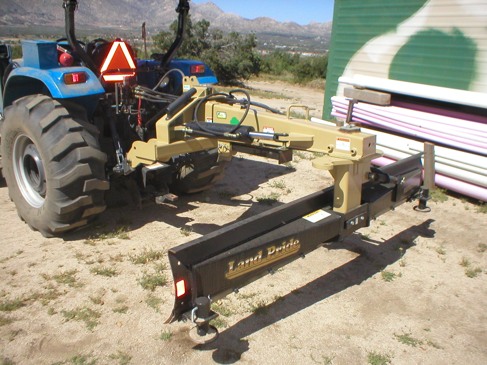

I'm not sure that you can get that blade for under $2000. :confused3: I'm pretty sure that the hydraulic kit is about $300. When you order the blade, get the skid shoes, they really do help out. :thumbsup:
Get the blade and skid shoes, you can have the cylinder and a hose kit from me for about $200 and that will be a welded cylinder instead of a tie rod cylinder that Land Pride provides.
