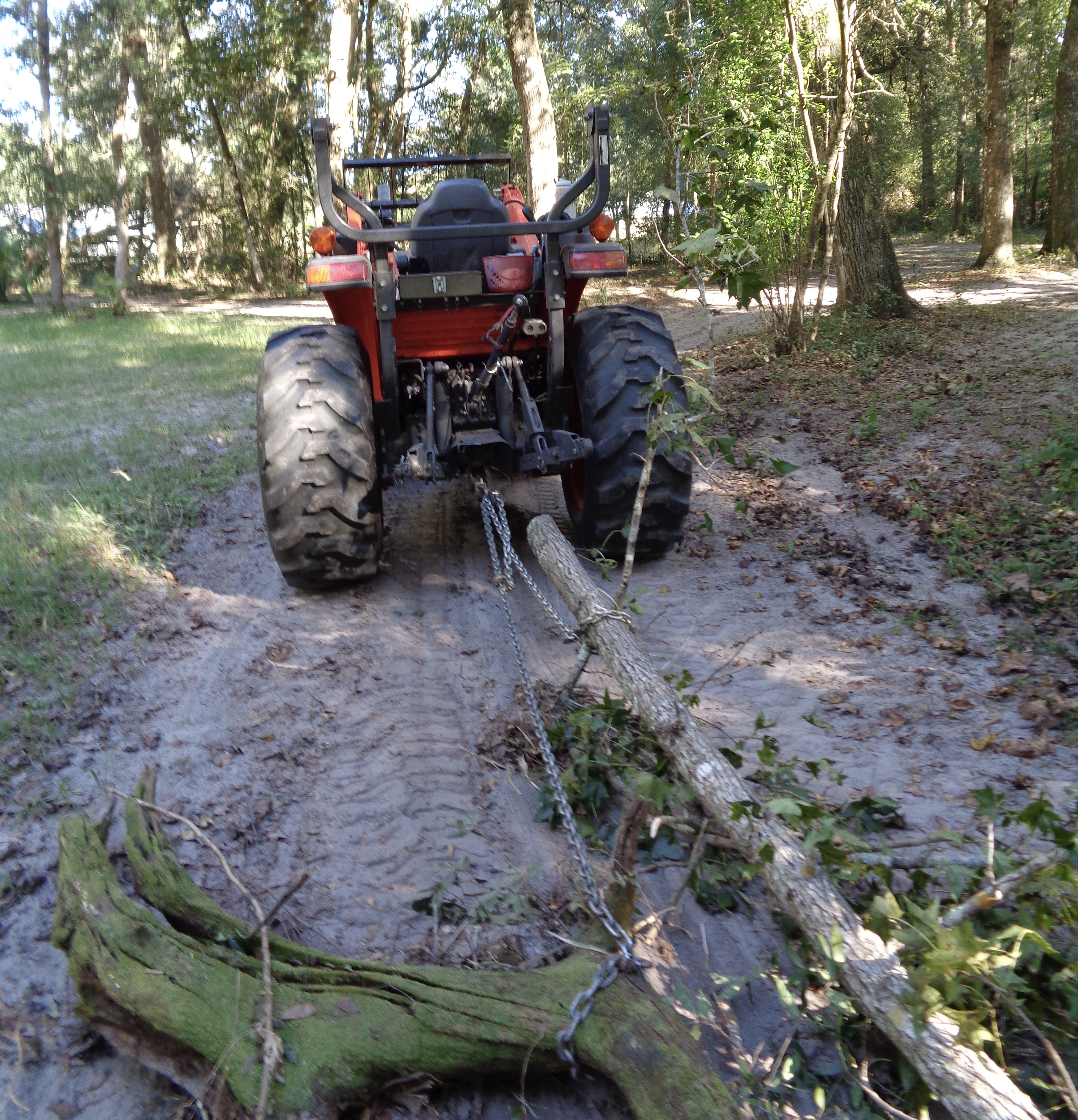

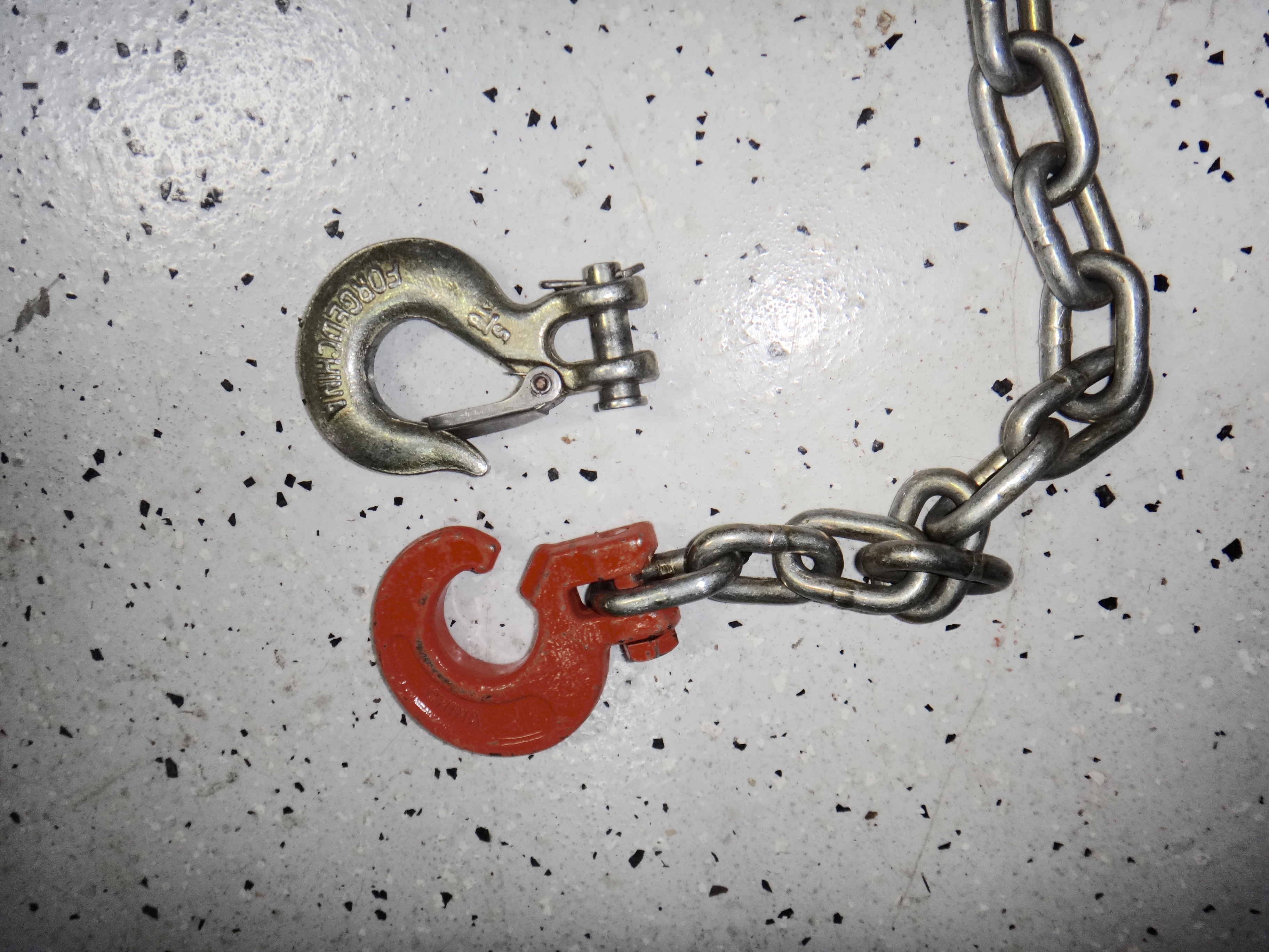

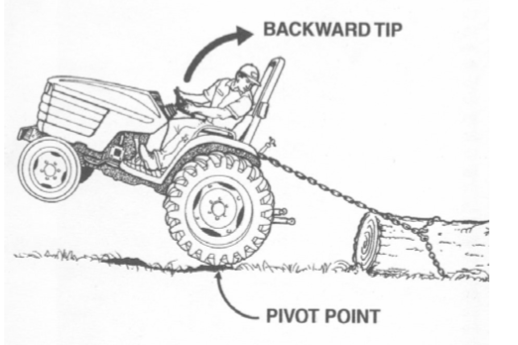

I went to a local farm today knowing they had one of each series (B, L, M). I like the size and capabilities of the L series.
I have trees to drag and brush to move so power and weight are more important than I previously realized.
L Series is a broad category: 25-horsepower/2,700 pound L2501 through 62-horsepower/4,000 pound L6060.

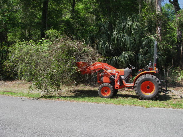

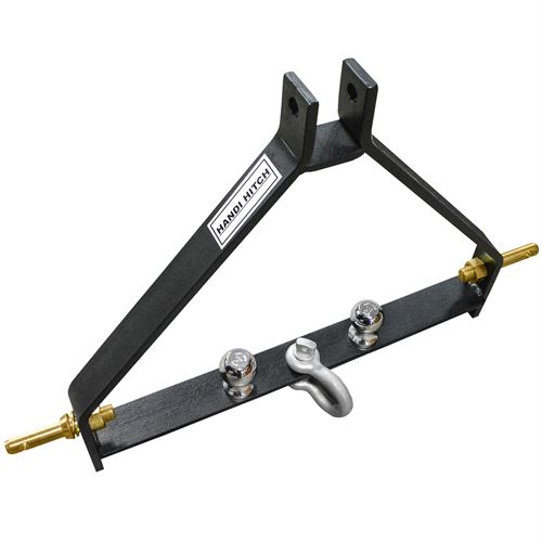

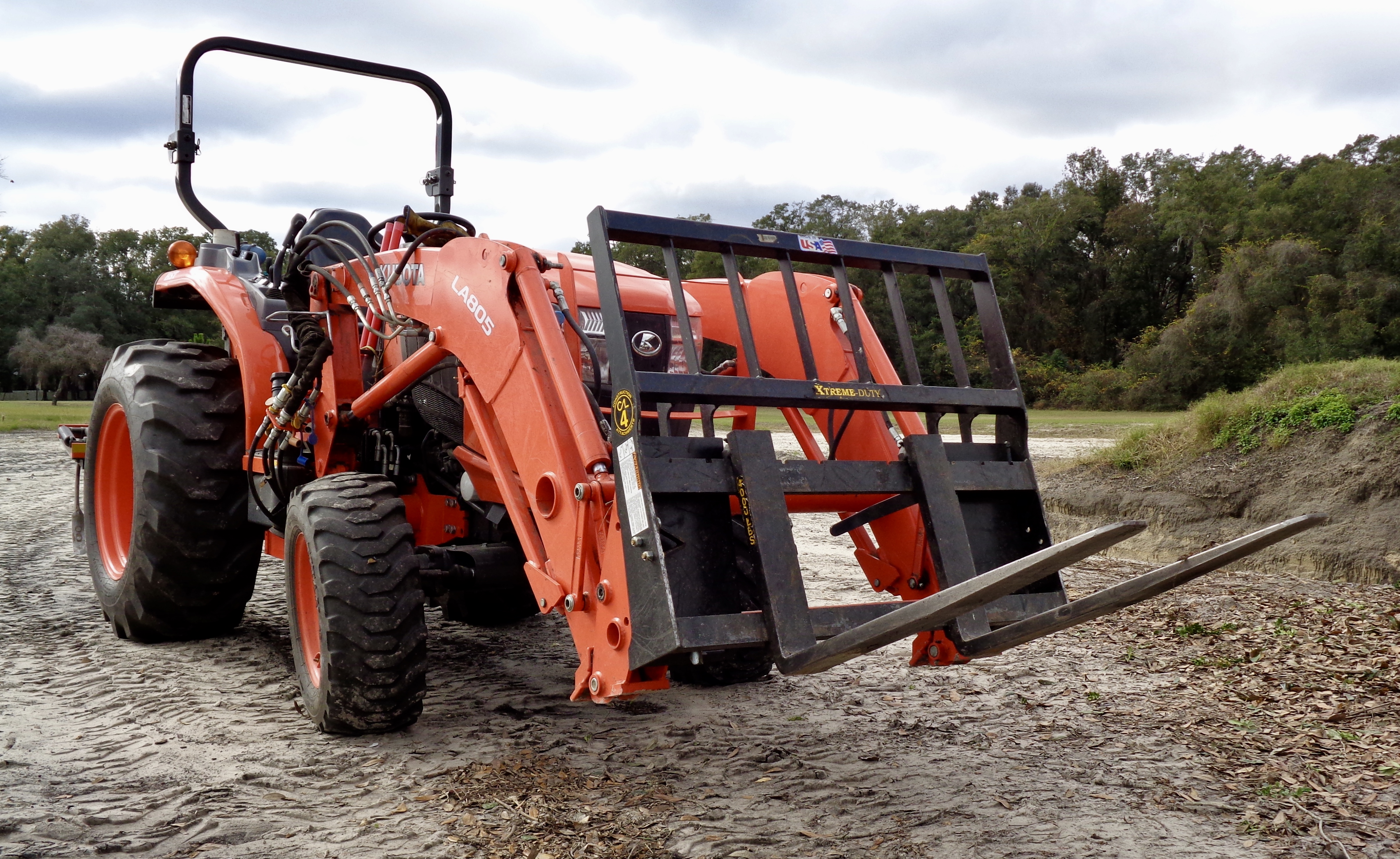

Neither moving brush with pallet forks (PHOTO #1) or debris forks (PHOTO #2, #3) nor dragging trees on the ground requires a bare tractor weight heavier than 2,700 pounds, however that would be minimum weight with your hills. Most would use 1/4" Grade 70 chain + Grade 70 chain slip hooks (PHOTO #6) in conjunction with some form of cross-drawbar (PHOTO #4, #7, #8) to safely drag tree trunks (PHOTO #5) moderately elevated at the tractor end to reduce log to ground friction and log dirt loading.
WEIGHT = STABILITY UNDER LOAD.
TBN ARCHIVE: https://www.tractorbynet.com/forums...ctor-drawbars-cross-drawbars-illuminated.html
