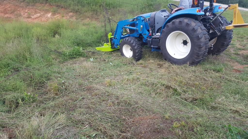

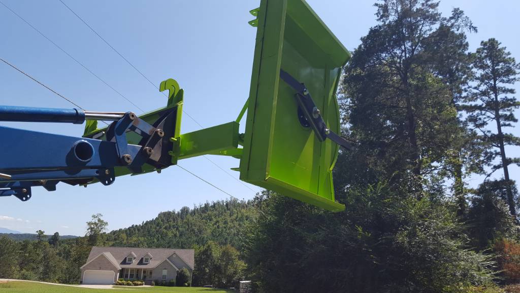

Have probably 15 hours on mine over a year and a half. I have 8 gallons of flow for attachments, no issues so far. I did add the return to sump line. I have the smaller LS3 which only requires 5-8pgm.
