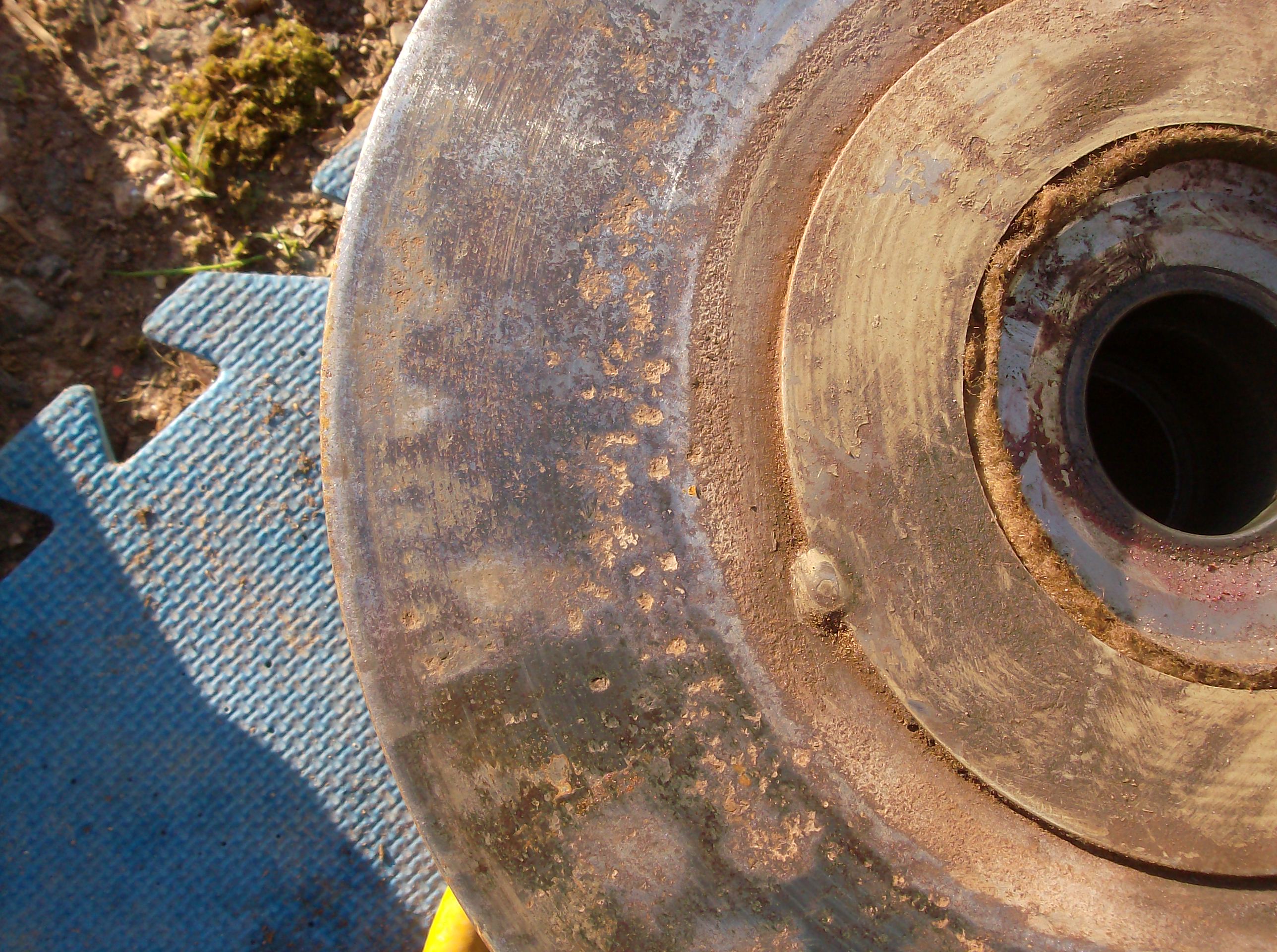

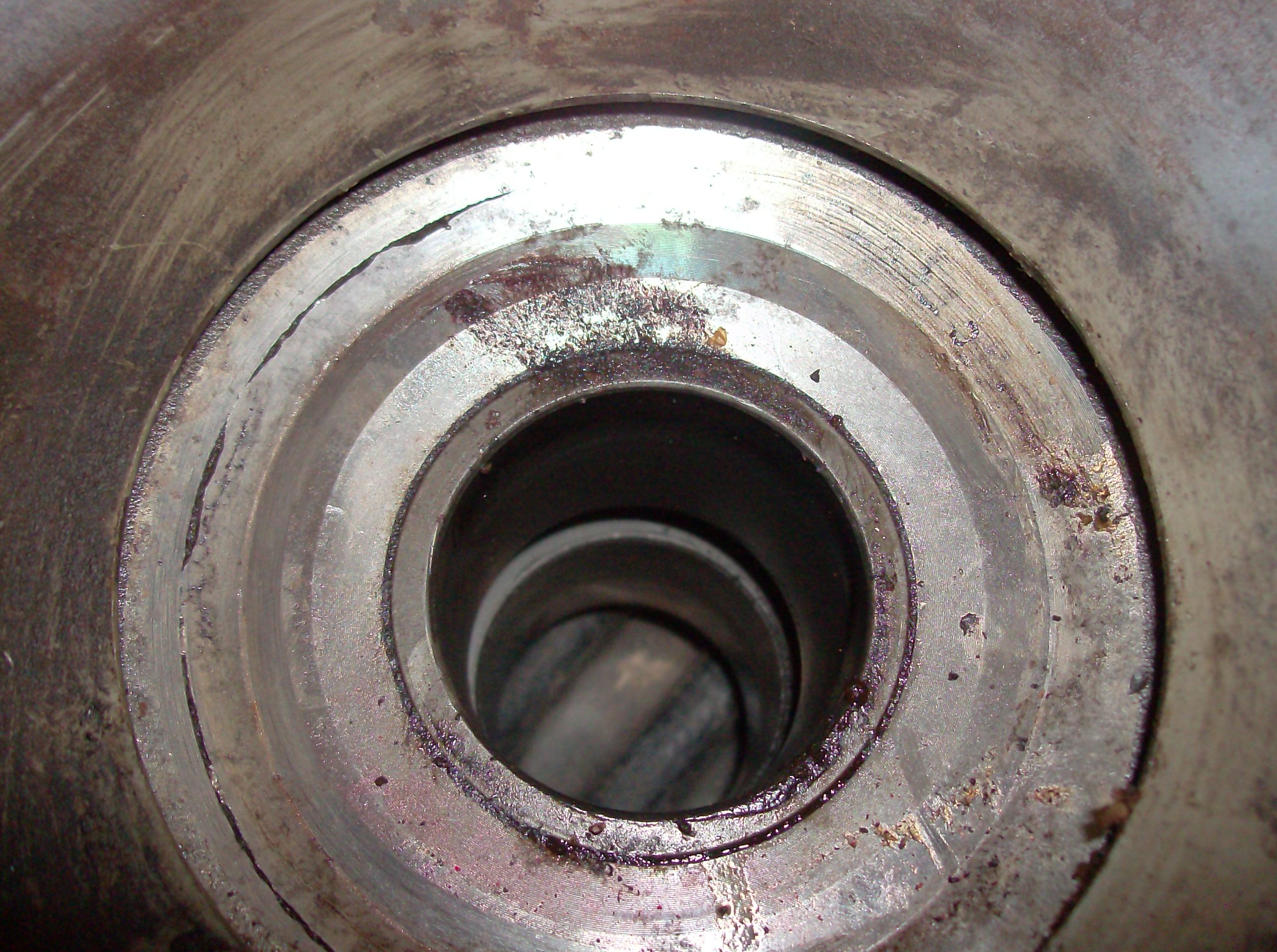

I stopped in at the Farmi dealer and had a long talk about this winch. Most of the discussion was about how the surface of the plate and the spool has to be flat to have great contact. I pulled it apart and I spray painted the spool and the friction plate to see if was not running flat one on the other . That's when I removed a build up a grease and dirt to see the crack. I would think that the spool is not getting an even pressure with the crack like this. Crack is just a hair line but is more then 3/4 the way around. I think a welder can drop a bead on there and not interfere with the operation as the crack is under a felt dust ring to stop dirt from getting in. Not sure as to how thick the piece is HPIM3912.JPGHPIM3913.JPGor how that would ever crack like that.

That's a crack? Looks like a gouge? That's a pretty thick piece of steel to crack, and a pretty concentric clean circle. I can't see how the clutch puts that much pressure against the flywheel.

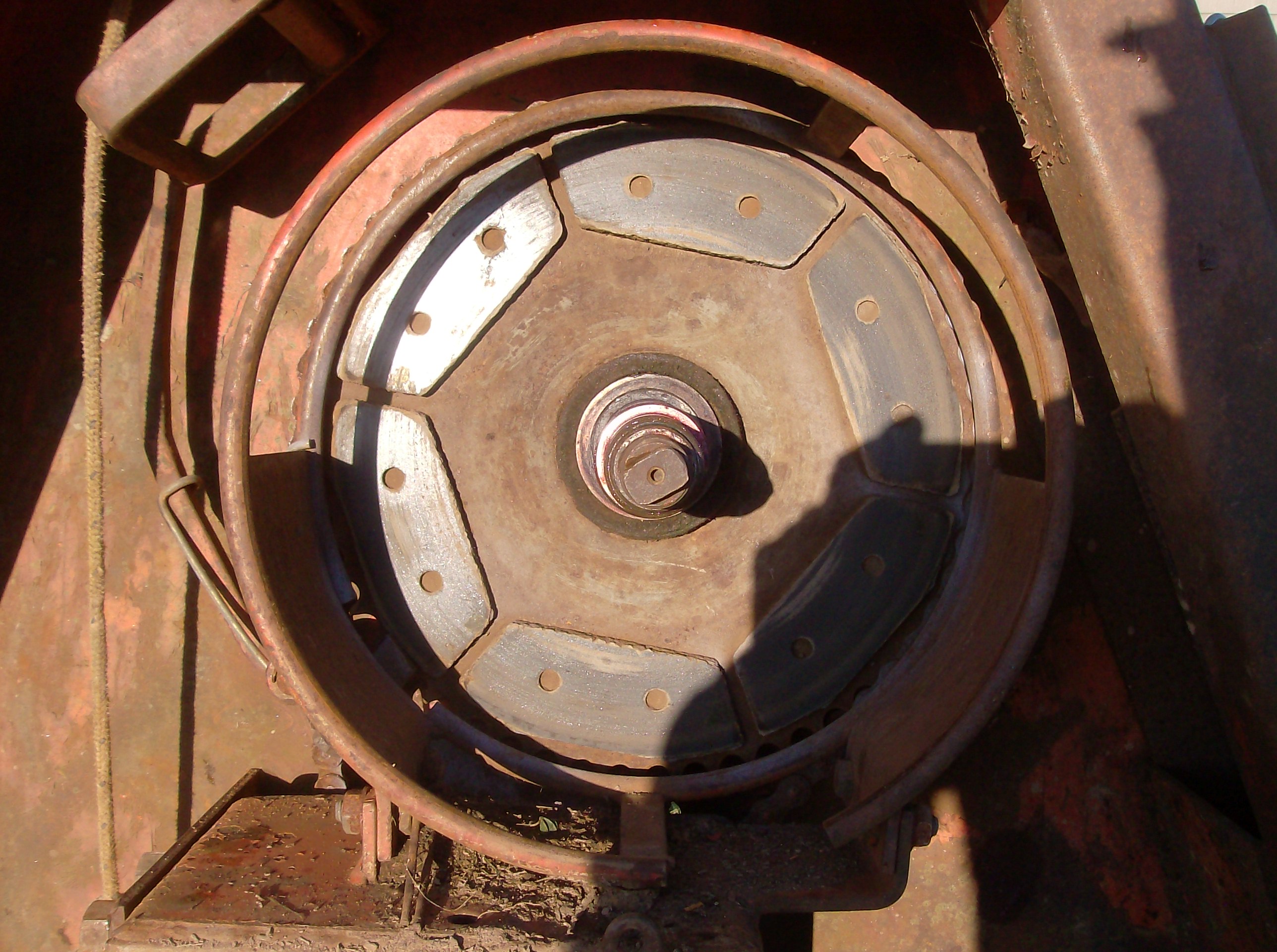

Here's what I'm thinking based on what you've said you found recently. If the bearing you described is not causing any issues or seized then I would look to see if possibly the clutch plate might have some oil/grease on it. If it does because someone did not heed the DO NOT OIL the chain instruction then the disk could be slipping due to it's being dirty/slippery with grease/oil. I know this from personal experience having greased my chain, before I was made aware not to, and it having thrown grease onto the disk and rendering the winch useless in pulling even the lightest load.
How did I solve this? I used Brakleen and sprayed it and used compressed air to dry the disk until all the grease was gone. I got my ability to pull back.
Also, it's hard to tell from your pics 'cause they're pretty close up, whether the disk mating surface is gouged up or smooth enough to engage properly. Looks to me like it might be a bit too rough for smooth and solid engagement.
I'd show the pics you have to the Farmi dealer, along with some others of the area with a little more distance so one can see the overall situation. Are you referring to the crack way out on the surface away from where the wear is? If so, I also have the dealer scope that out and advise whether it is of concern.

Well showed to my neighbor and he says its not a crack Its the end of the spool that was welding to the sides and then machined smooth. Lots of weld left on the inside where the wire wrapped. He thought the spool was rusted too much and may not get a solid engagement on the friction plate.
His suggestion was to sand it as best I can . Clean up the pads and try it . If it works better take itv all apart and go to a machine shop and have them lathe the plate smooth again. I don't want to remove much as the friction disc is 10 MM and replacement is 7 MM. I did price the pads and are $60 ea X 6 plus rivets.
I have cleaned up the plate and pads seems to pull better but have not had the opportunity to pull a heavy pull yet.

What did you use to clean the pads?Also your pics, what exactly are you showing us? All I can say from looking at the surface is there is a lot of rust and wear and what appears to not be a very flat surface from the outer edge of the big hole for some distance across the worn area and then, near the top of pic # 2 the gap between the shiny surface and the rest of the darker portion of the disk. If what you're showing us, the shiny rough area, is where the clutch pads are supposed to contact to pull the cable it should be perfectly smooth, or have a machined crosshatch pattern to grab the clutch pads securely to effect proper friction and allow the cable to pull it's intended load. IMHO, without the necessary smooth AND FLAT surface you will not be able to achieve the winch's potential pulling power. This may be why it was for sale? If by cleaning/sanding the pad contact surface and thoroughly cleaning the pads you achieve significantly more pulling power then you are on the right track and should consider having the surface machined, at a minimum. Again, just my opinion, but that's what I would consider if it were my 'wench'.:D
I used Emmery cloth to remove the crap from the pads. The pics don't show the area where the pads ride. but as you say its not a flat surface there either. The seller told me that he didnt use the winch for 4 years since he bought his skidder. and it was sitter in an orchard for 4 years not covered. I will remove the plate and have machined

Try it first before removing it to machine the surface. See if you have better torque on the cable to pull heavier loads. Maybe see if after testing for better load capacity if the machine shop can put a crosshatch or swirl pattern on the surface for maximum grip. Use some Brakleen on the pads too and compressed air to evaporate the solvent and remove the ground in rust and other particulate matter.

I did try it some what. It was unable to pull the tractor in neutral . After a pad cleaning and plate sanding it was able to move the tractor a little with the winch on the ground.

Nice pics. The outer disk surface in the first pic is pretty pitted. Is that pic representative of condition AFTER cleaning/sanding? Same question re the pads in #3,4?
If so, you may have trouble getting to a smooth enough machined surface without taking it down a lot to get rid of the pitting.

Plate is at the machine shop He said 30-40 thous should come off. May not be smooth but will be better then it is now.
