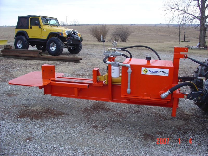

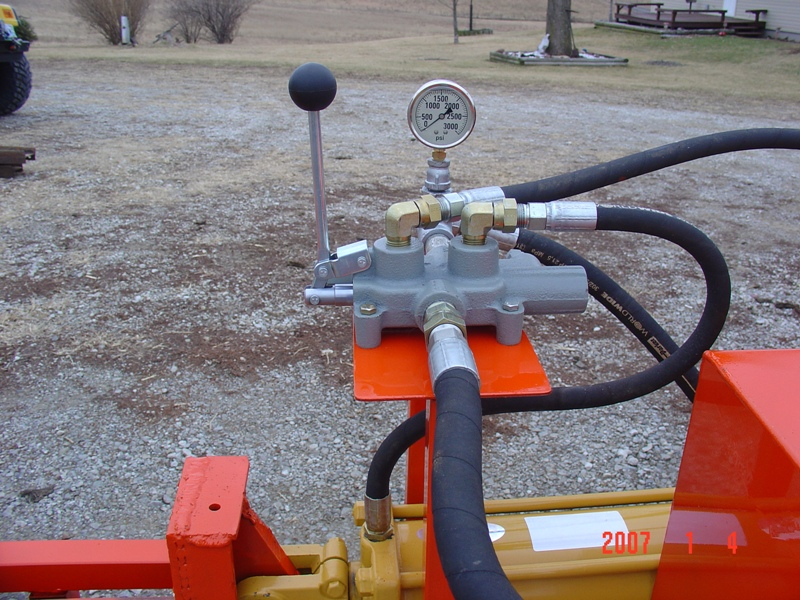

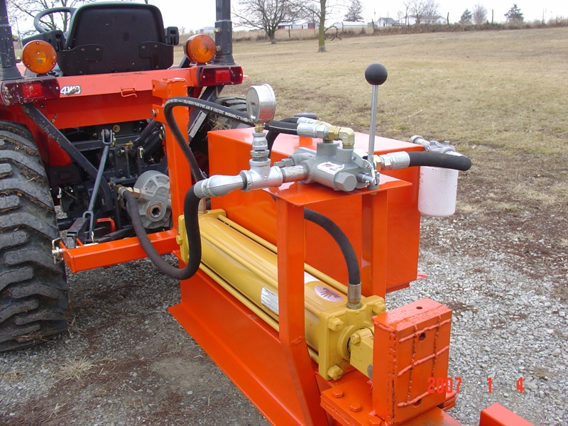

OUCH!....
And this one.

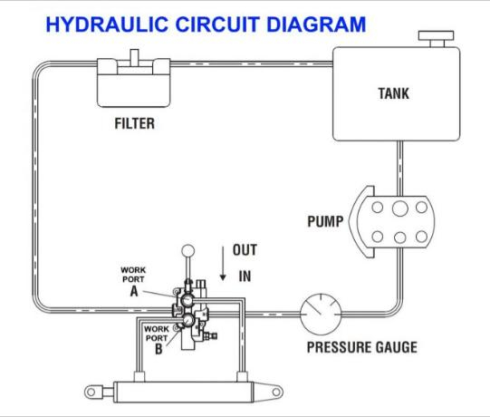

I sincerely appreciate all the replies and information. Would adding a tank and attaching to the pto pump be an option (similar to how my backhoe works)
Yes it would make it faster how ever if your buying all those parts new just go buy a brand new big box store splitter. It's going to be cheaper in the end.

I wouldn't trade my "more expensive" 3- point splitter for a dozen new, box store splitters!
That is, IF I had to use them!
SR

Dont forget to account for the added heat of the fluid that the tractor now has to cool since it wasn't designed to cool fluid in a splitter setup. Get a prince pto pump and a separate hydraulic tank to cool the fluid, and run new lines between it all. this will extend the life of the tractor and splitter parts. Fluid temp is a big concern on the splitter parts also. If you switch to a gas engine on the splitter itself, you have to buy all these parts anyway...

If you already have a PTO pump for your backhoe, I wonder if you could put it on quick disconnects (make sure to get ones that can handle the pump's flow rate) and use the same pump for your splitter. Then all you'd need to add is a tank & filter.
