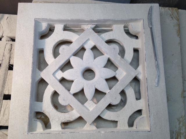

All,
Thanks for the suggestions. You ever want/need a tool that makes you wonder, "why don't they make that?". I often want a tool that is in between what is available. Like, Dremal vs. router. I use a Roto-Zip as a router for carving limestone. Standard wood bit work great, for a while. The wire base pretty limited.
So when it comes to electric impact, the range is very large. Small engraver modified to remove grout,
Hyde-Tools | For a better finish, start with Hyde.
or larger hammer drills. Something twice as robust as the grout removal would fit the bill for what I do. Fine detail stone carving.
I carve stone relief panels and they are fragile because they can be as thin as 1/2" thick, 16 " by 16". I work with as thick as 2" slabs as well, but in any case I must be very careful not to crack the stone.

Sounds like you need a laminate trimmer. Pretty much fits smack dab in the middle of that dremel/router gap. Takes standard 1/4" router bits but easily held by one hand if you want but still big enough to grasp with 2
/ Looking for hammer drill with non rotation feature #13
Texas Cream?

Ray66v,
Indiana Limestone. We have quarries and mills all around. Mill cut Odds and ends can be bought for $20/ton. Just a hobby, making dust. Good time take ones thoughts away from work...
