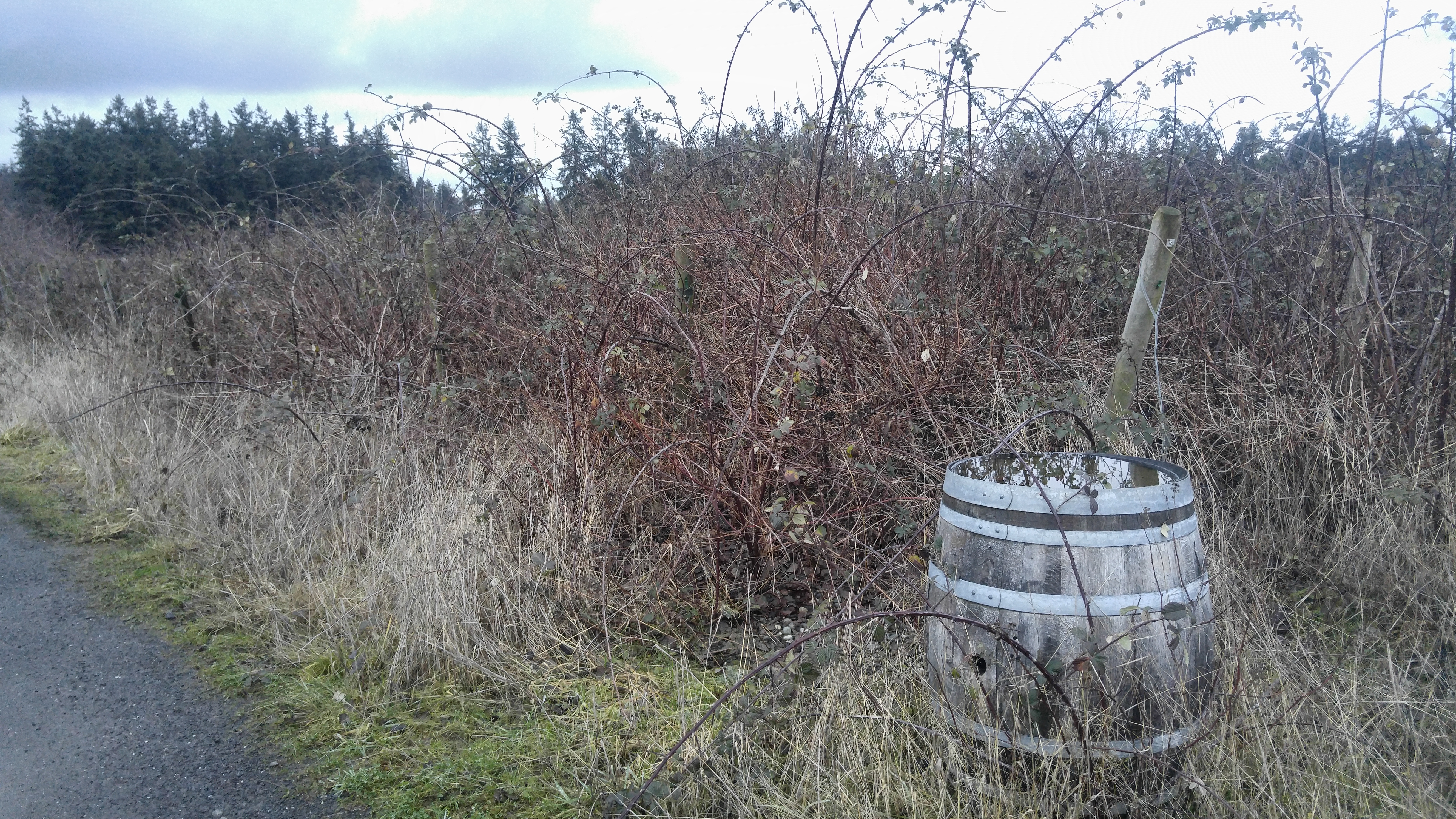

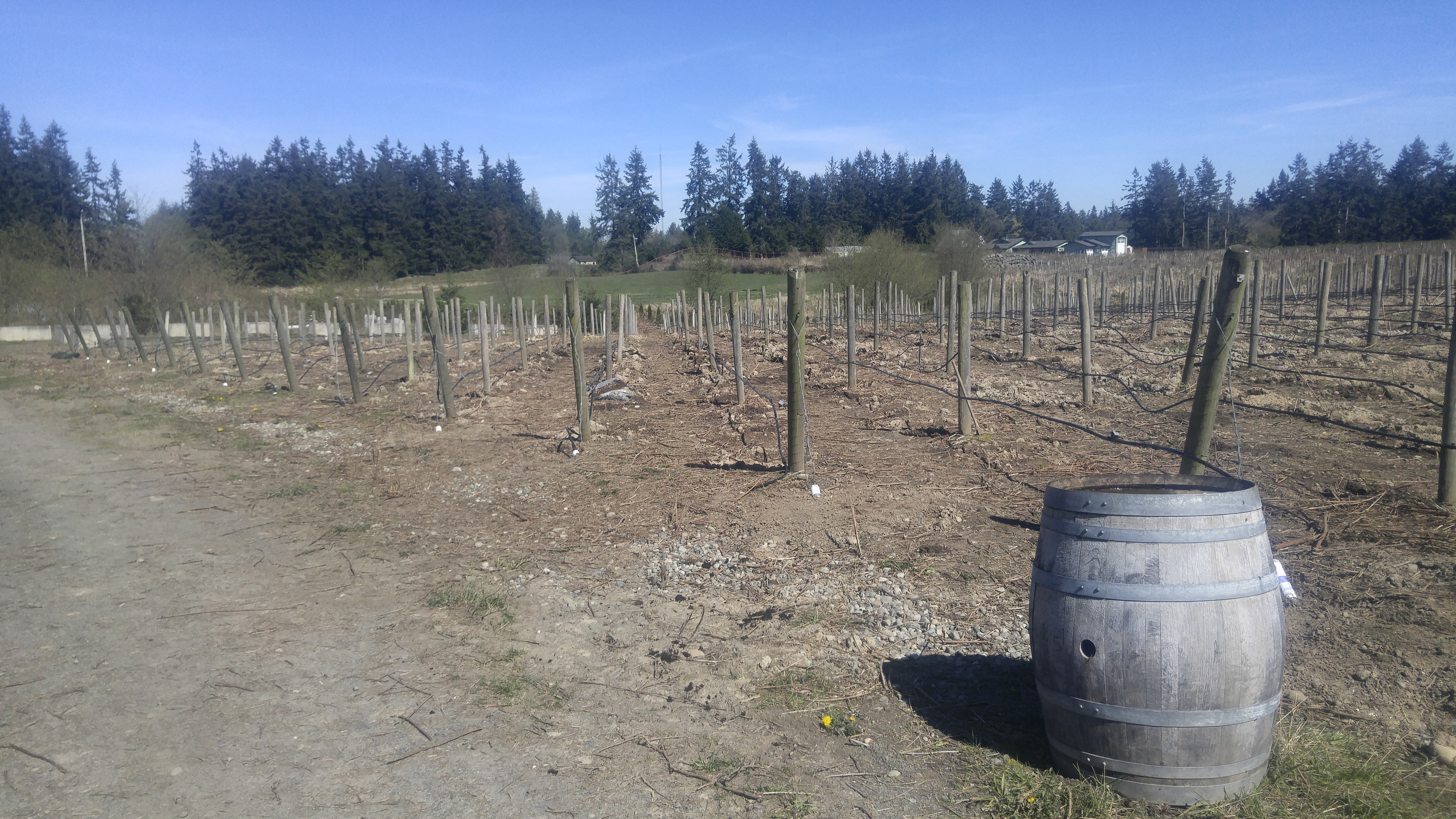

Now here is the after. I used a small excavator to scrap them, ball them up then grab the ball to pile them up somewhere else. Then used after1.jpgmy tractor with a flail mower to clean up what was left on the ground in between rows.

That is an amazing transformation!
   / looking for guesstimates for how long it would take to clear 2.5 acres of blackberry #67
Looks good. How long did it take?

I started in January and finished last week, working on the weekends.

Looks good.
Look like a two wheel tractor or small skidsteer w/ a front mounted brush hog (or mulcher) would have have done it quickly.
