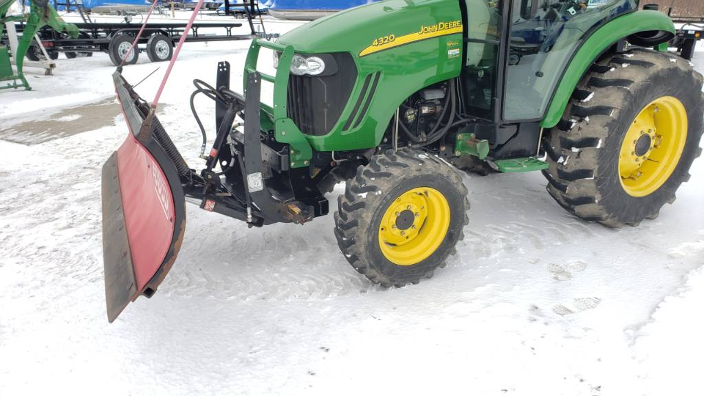

It's not what you are thinking, but it works 200% better than a loader plow.View attachment 748478
   / Looking for front blade to plate attach ideas/designs #14
Looks like only one attachment per post
#15
It's not what you are thinking, but it works 200% better than a loader plow.View attachment 748478View attachment 748479
Looks pretty neat. Not anything I can use since I will be using my FEL. Is that a homebrew setup or something commercial? Ah ok, that last picture did not post when I asked if it was commercial.....it looks like it clearly is.
