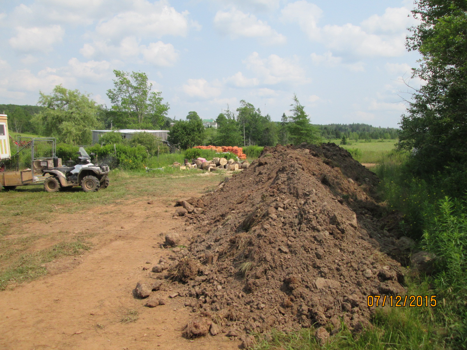

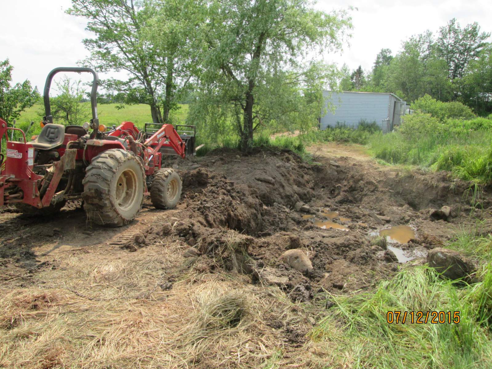

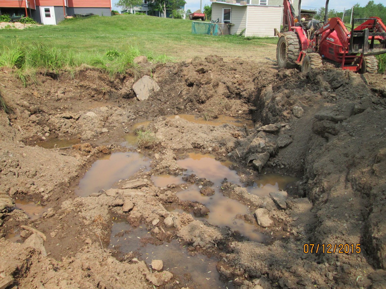

What I ended up doing was I dug with the hoe about 20 ft long by 6' wide then I moved the pile with the bucket to the holding area That area was about 1 min away.
Think it was about as fast as loading the trailer with 5 scoops attaching and dropping it off then having to push the load back from the dump. I guess the distance to the drop area would have made a difference if it was 5 minutes away.
Here is a pic of the hole and some dirt. That is probably about 1/10 what I want to dig. At least now when it rains the ducks will have a pond.

Smooth it will be as smooth as the top of the water later.
Biggest issue is all the old culverts used as fill. Need to be away from one spot to dig along the rest to pull it the . My plan was to get my atv in there and knock down the higher spots. If only the rains would come I could stop digging .
