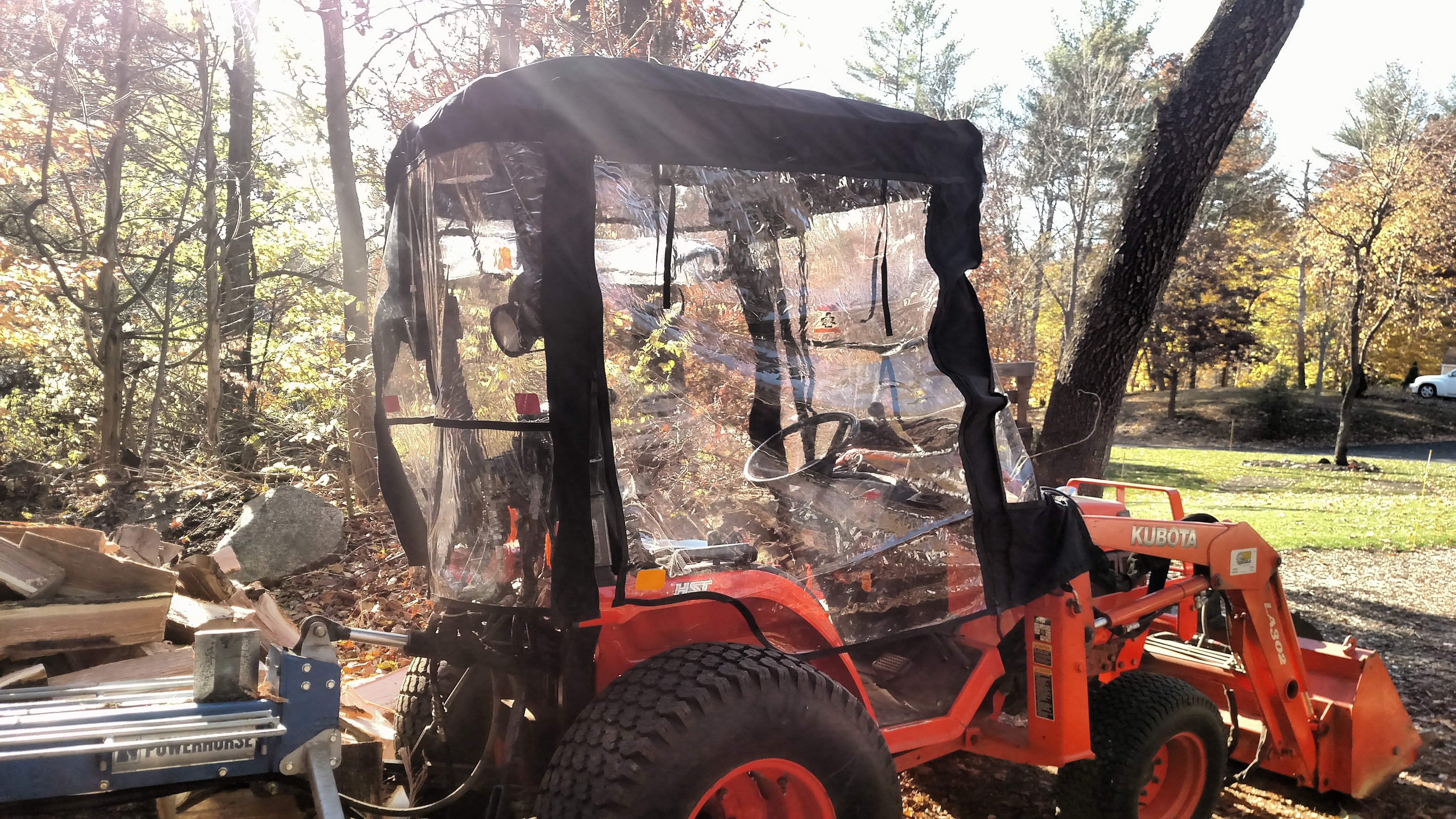

Like you I use the FEL for firewood but also didn't want to break the bank with a front snowblower... used $1200.
Also have a sun shade and wind blown snow sucks so I bought a $300 soft cab the dropped over and keeps me pretty protected..
