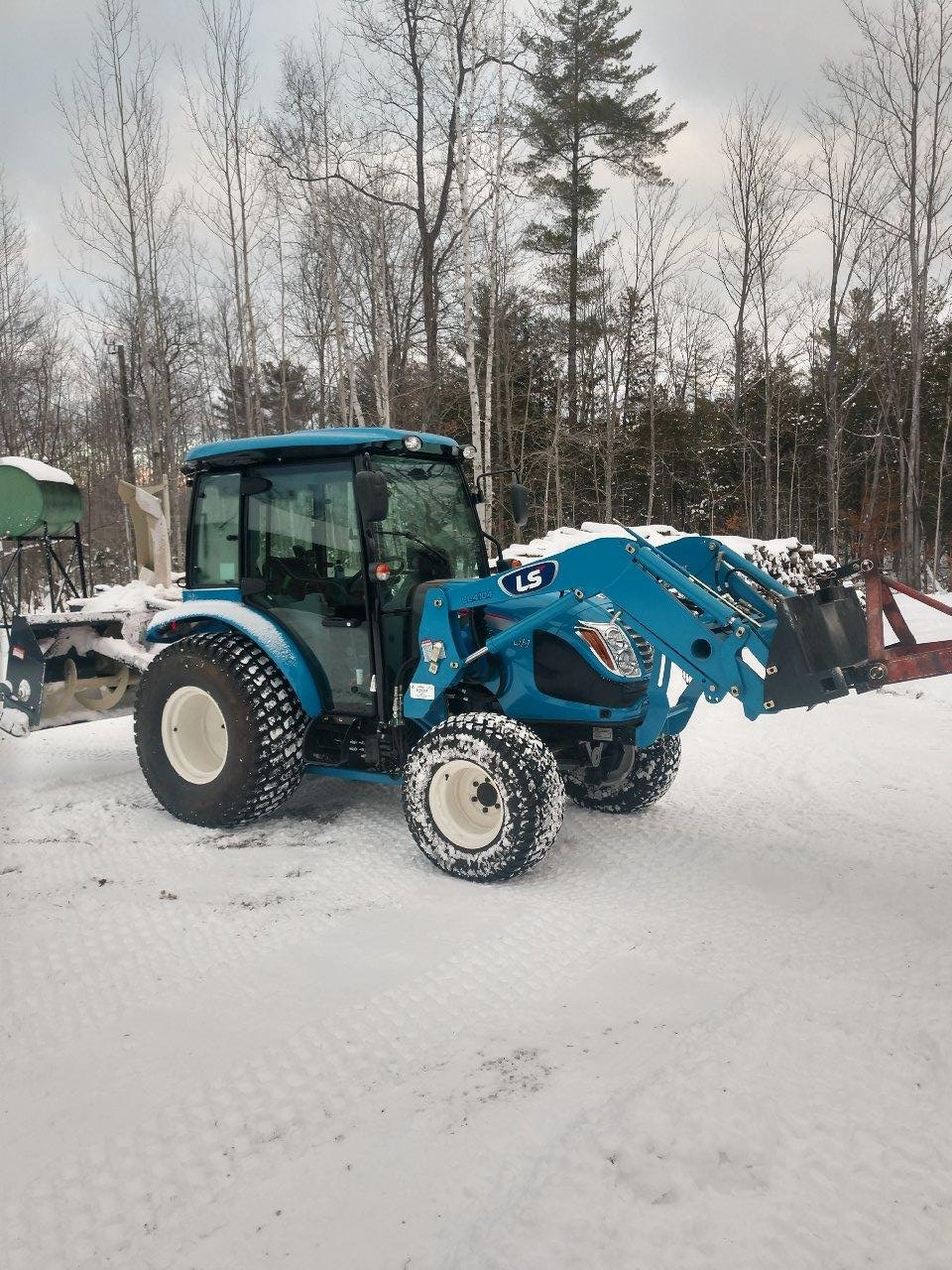

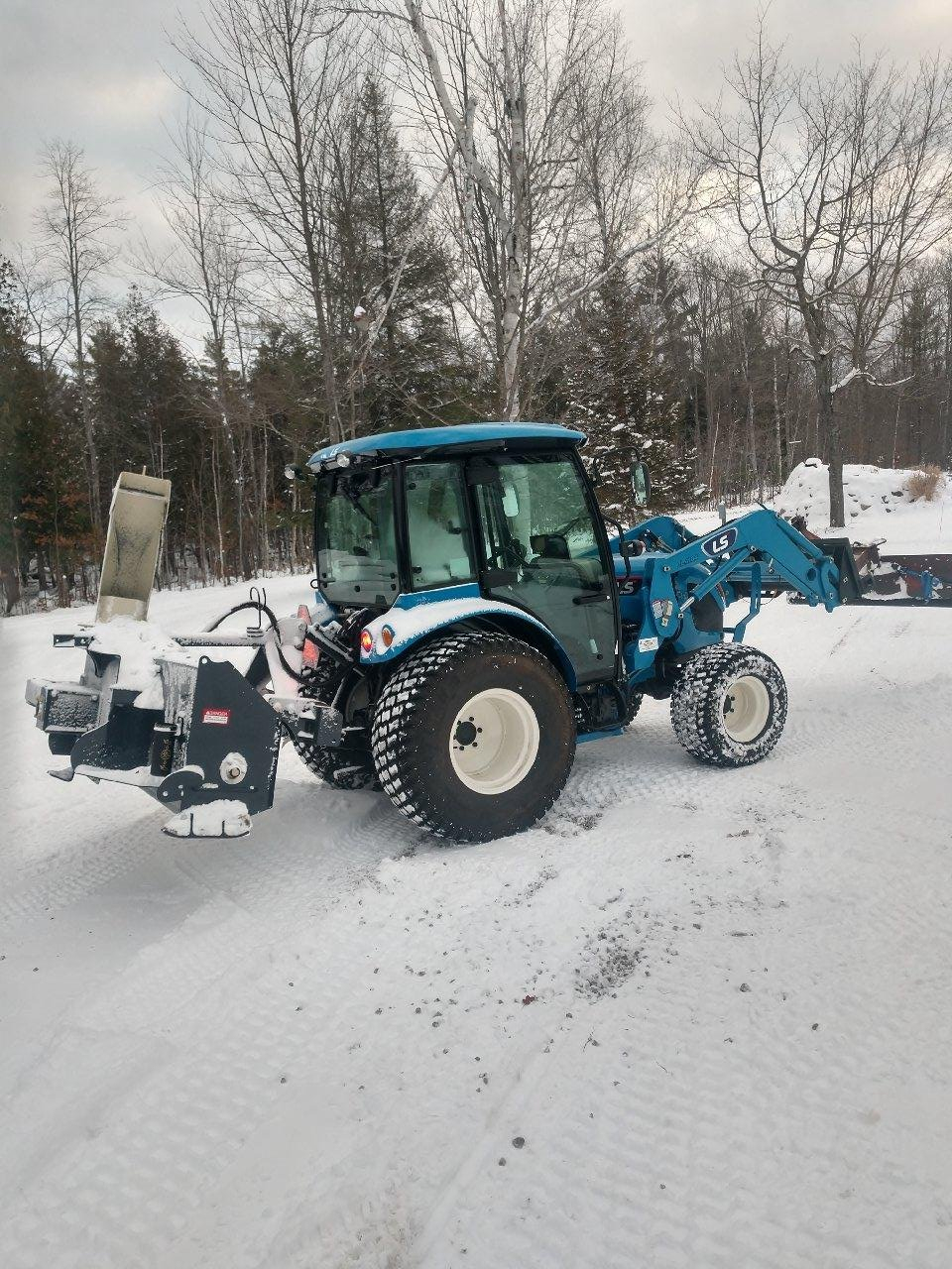

Pushing snow is cheap if you have a place to push it. If you are not dealing with deep snow, a rear blade is effective and cheap as well. I get about 120" a year so it was not a great option for me. I went with a blower. I ended up mounting and old rear blade ($100) for back dragging on the SSQA using an adapter for 3PH to SSQA...$220. Best of both..
   / Looking for angle snow plow or snow pusher #13
Shooter, I assume you are using the rear blade curve backward, vs curve forward which would dig in unless you have shoes or something? I have a typical snow plow blade from Kubota on the FEL arms. Pushing it forward cuts into the snow and hangs up. And I don't want to back drag 3/8 mile of a curvy gravel driveway. Jon
   / Looking for angle snow plow or snow pusher #14
Near the garage I have a cement pad so I turn the blade backwards to back drag and cut down to the cement. If we get a light snow and before I get a base on the drive, I leave it backwards, drive forward, and angle it to windrow to the center of the drive. Then use the blower to clean the center.
Using the curl function, it is easy to change the angle of attack.
