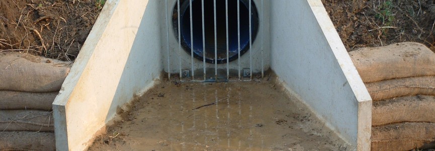

I would form and place a concrete head wall (needs it anyway) then bolt a slide gate assembly onto the head wall. Probably need to reroute the 4" PVC to clear the gate.
Ron
Thanks, I'm still leaning towards trying to insert something to extend the culvert into the pond simply because it'd be a lot less hassle, but if that doesn't work out I'll probably go with what you're suggesting. To make sure I'm clear on what you mean, you're talking about something like the picture below, but on the pond side, correct?
