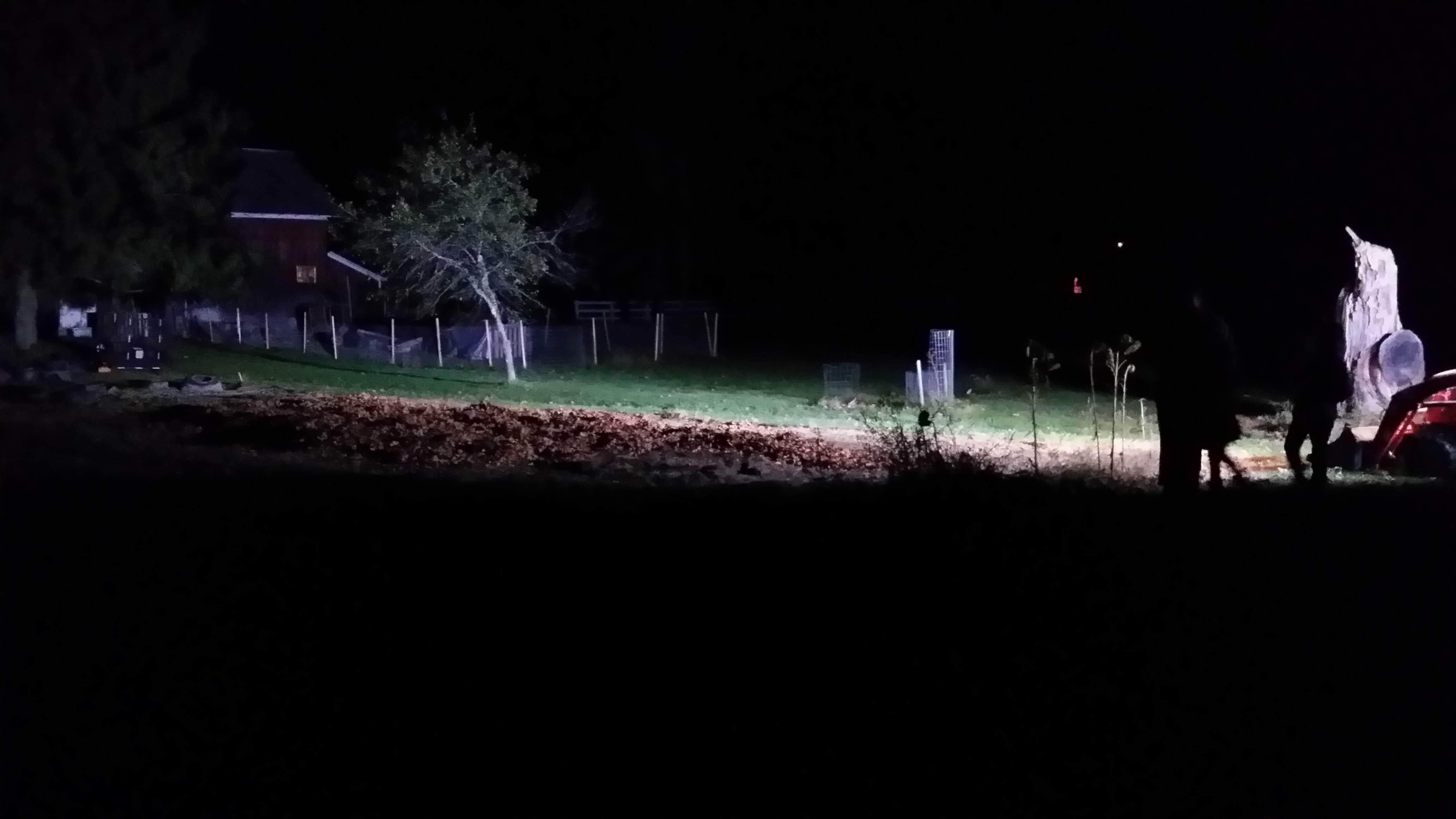

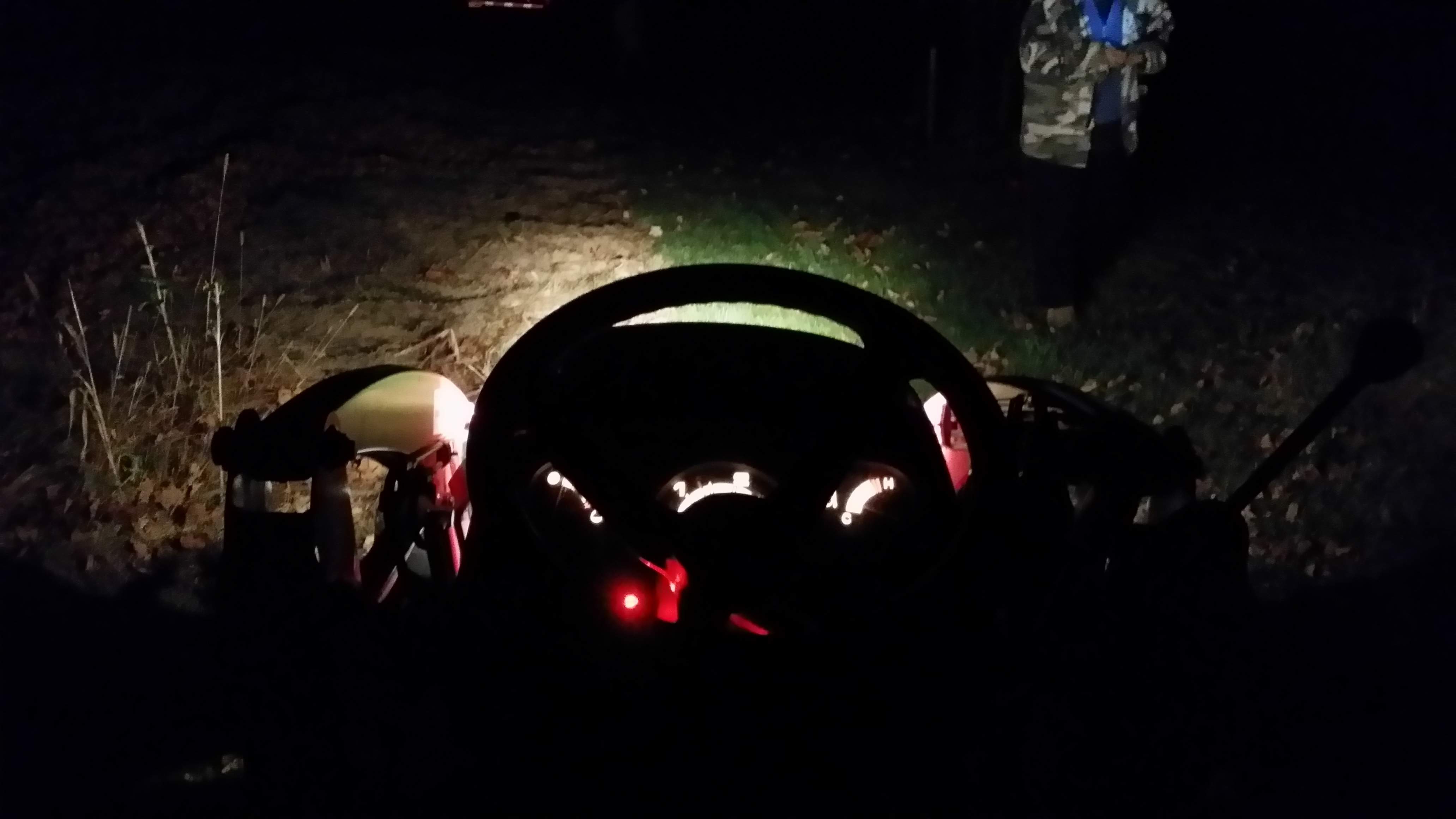

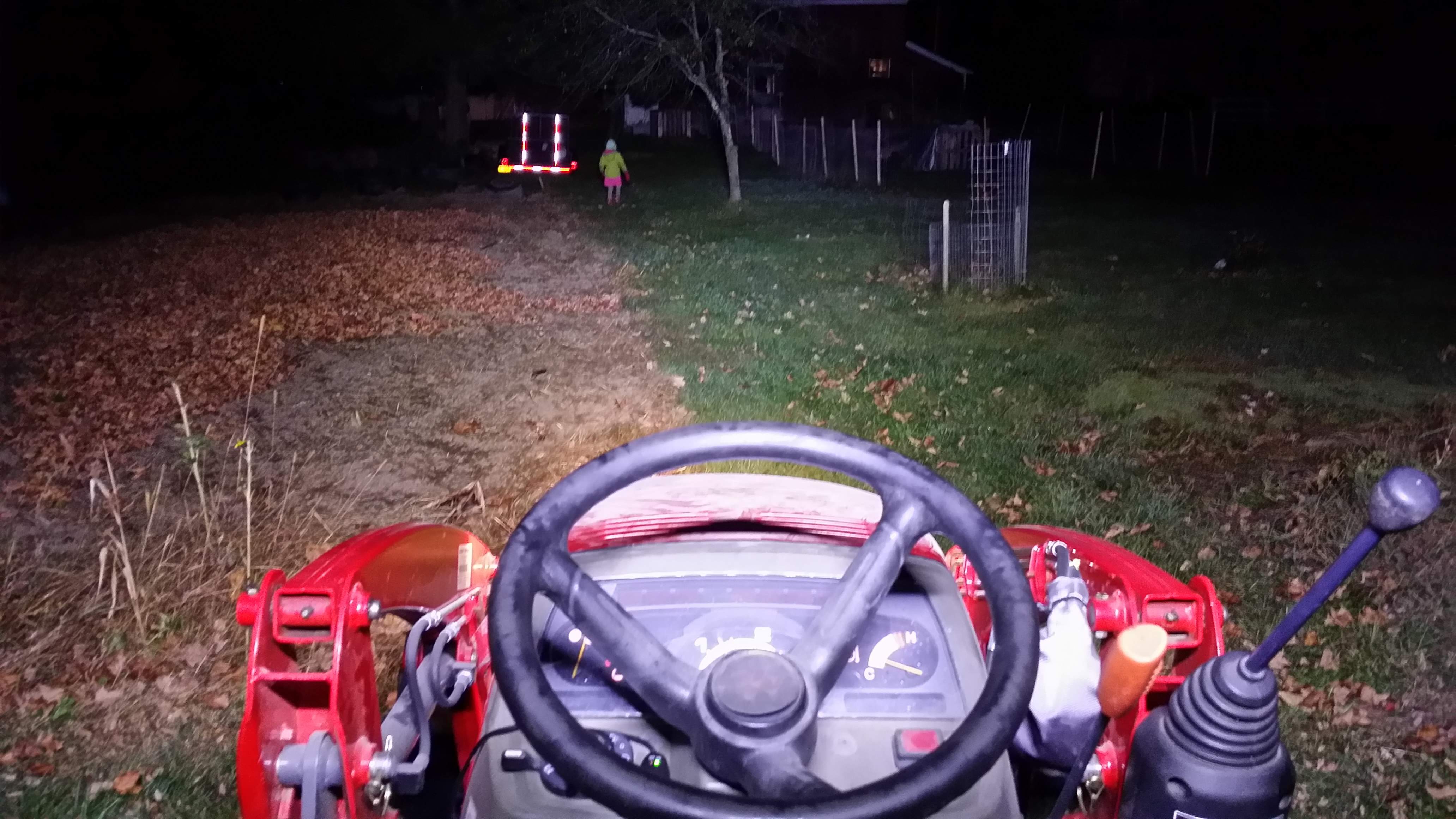

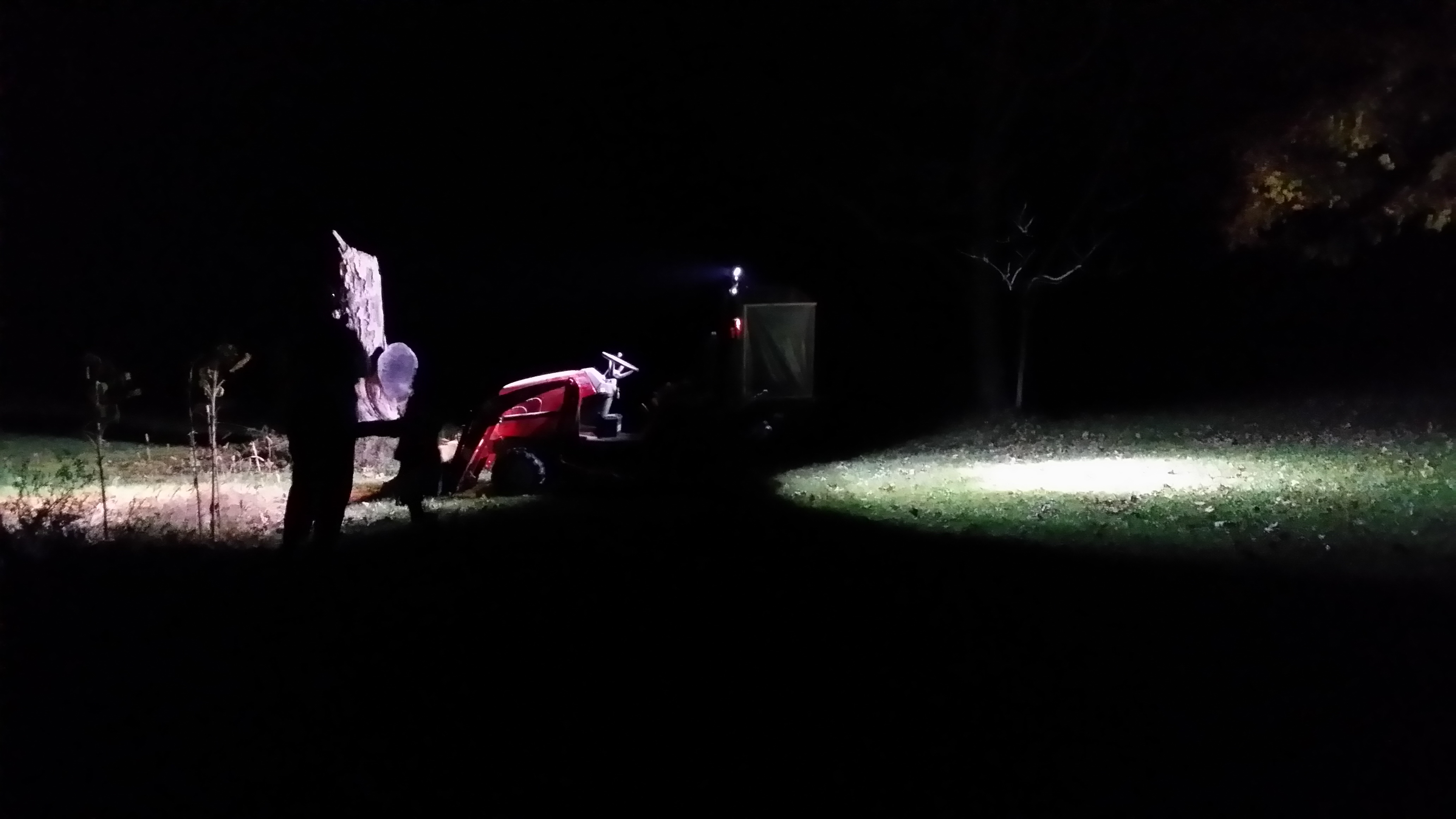

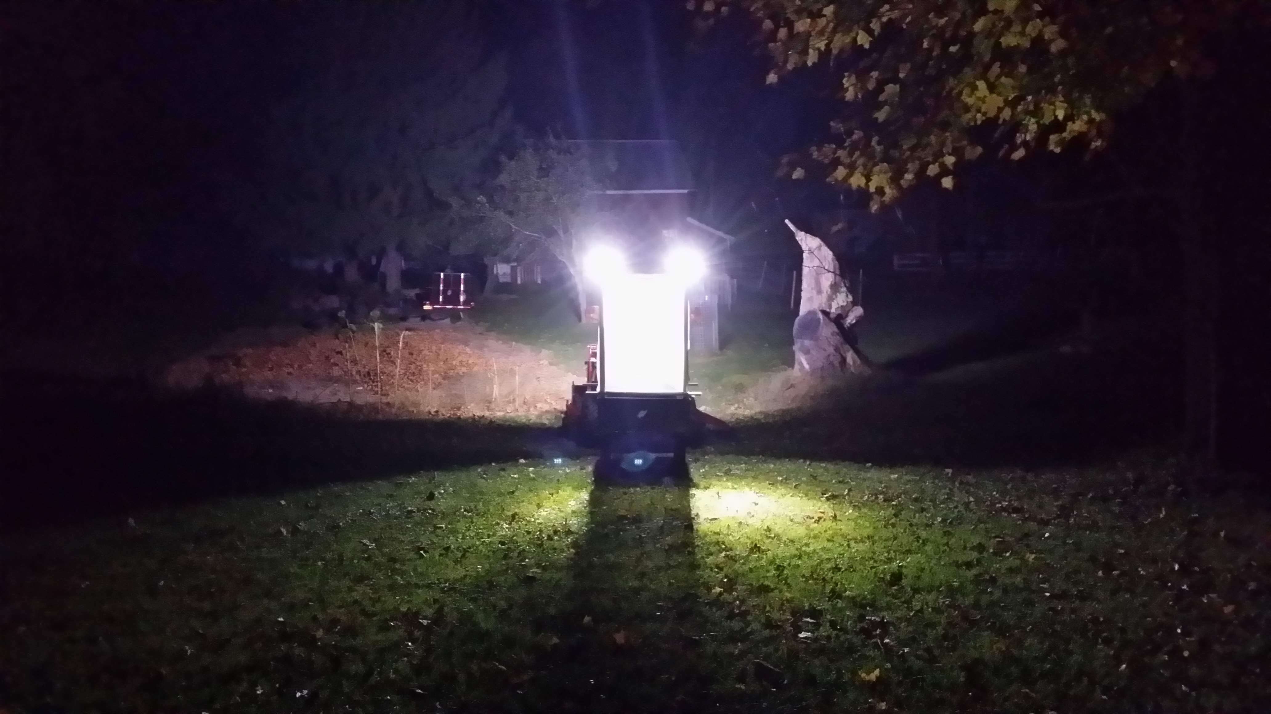

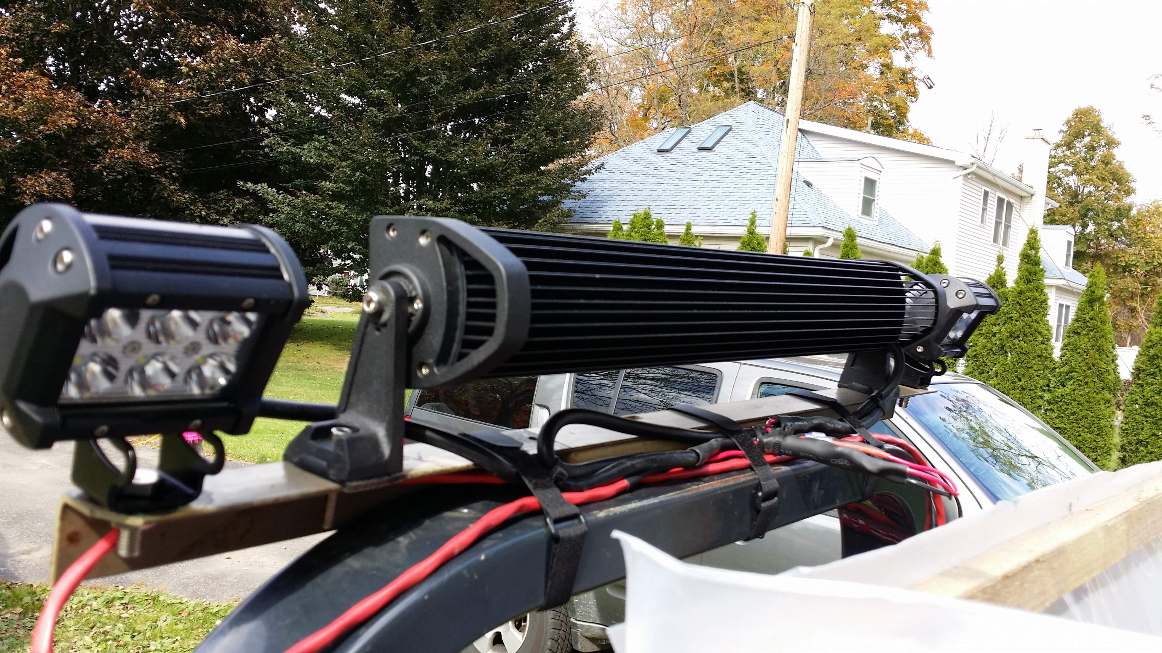

I bought a 24" bar off Amazon for around $50 with shipping, and 2 2x4" lights for around $30/pair with free Prime shipping. I bought a $18 wire harness with terminal ends, fuse, relay, and switch just to make things easier as well. Some spare wire to reach the ROPS, some angle iron, and velcro straps to hold it until I decide on a permanent mount.
These LED's blow away the factor lights, and use much less power than halogen ones. Also nothing really to burn out or need replacing. :D
Edit:
For reference, the parts I got.
Bar: https://smile.amazon.com/gp/product/B00D8RYGOI/ref=oh_aui_search_detailpage?ie=UTF8&psc=1
2x4's: https://smile.amazon.com/gp/product/B00G620ZVU/ref=oh_aui_search_detailpage?ie=UTF8&psc=1
Harness: https://smile.amazon.com/gp/product/B00D1CQVIY/ref=oh_aui_search_detailpage?ie=UTF8&psc=1
