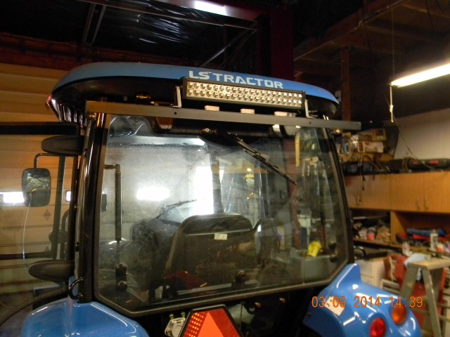

In my opinion, the LED light bars are the only way to go. There are a few write-ups on here I believe. I purchased mine on ebay. Chinese knock-offs yes, but the real deal is several hundred bucks. I'm even a dealer for the top of the line ones, and they are too rich for my blood. This one is a 32" and it fits perfectly. Its like turning on the sun. I loved it so much, I ordered a handful of them, another to point backwards, for the golf cart (I don't play, more of a utility buggy, you'd piss off other players no doubt), 4 wheelers, etc. Sorry I don't have a better picture. As stated, inside the ROPS is a good place, good protection. I'm even thinking of building a mesh screen of sorts to save the glass, see how much light diffusion it causes. The 32" was around $80 if I remember correctly, just search ebay for 32" LED Light Bar, I narrow it to Buy It Now auctions, and only buy from US stock, otherwise you'll be waiting for China Post for weeks.
EDIT: Good Lord, don't click on the picture! Lol. It took forever to upload so I opened it on my computer and its HUGE. So I edited it and figured out how to shrink it but the damage was done, the big one is attached to the post. I'm not sure how to remove it. Its just showing up as a link on my end though, so just don't click on it

Thanks, went on Ebay and found some that would fit my tractor. The ROPS is not 32" wide.

As bright as these are, smaller probably wouldn't hurt too much. I live in rattlesnake and scorpion country, it's a big no no to walk around after dark. With this thing turned on, I'm not too terribly afraid to keep working as long as the grass is short and hiding spots are minimal. Something I wouldn't dream of with the factory headlights. Or even my truck's HID headlights, which are pretty bright...

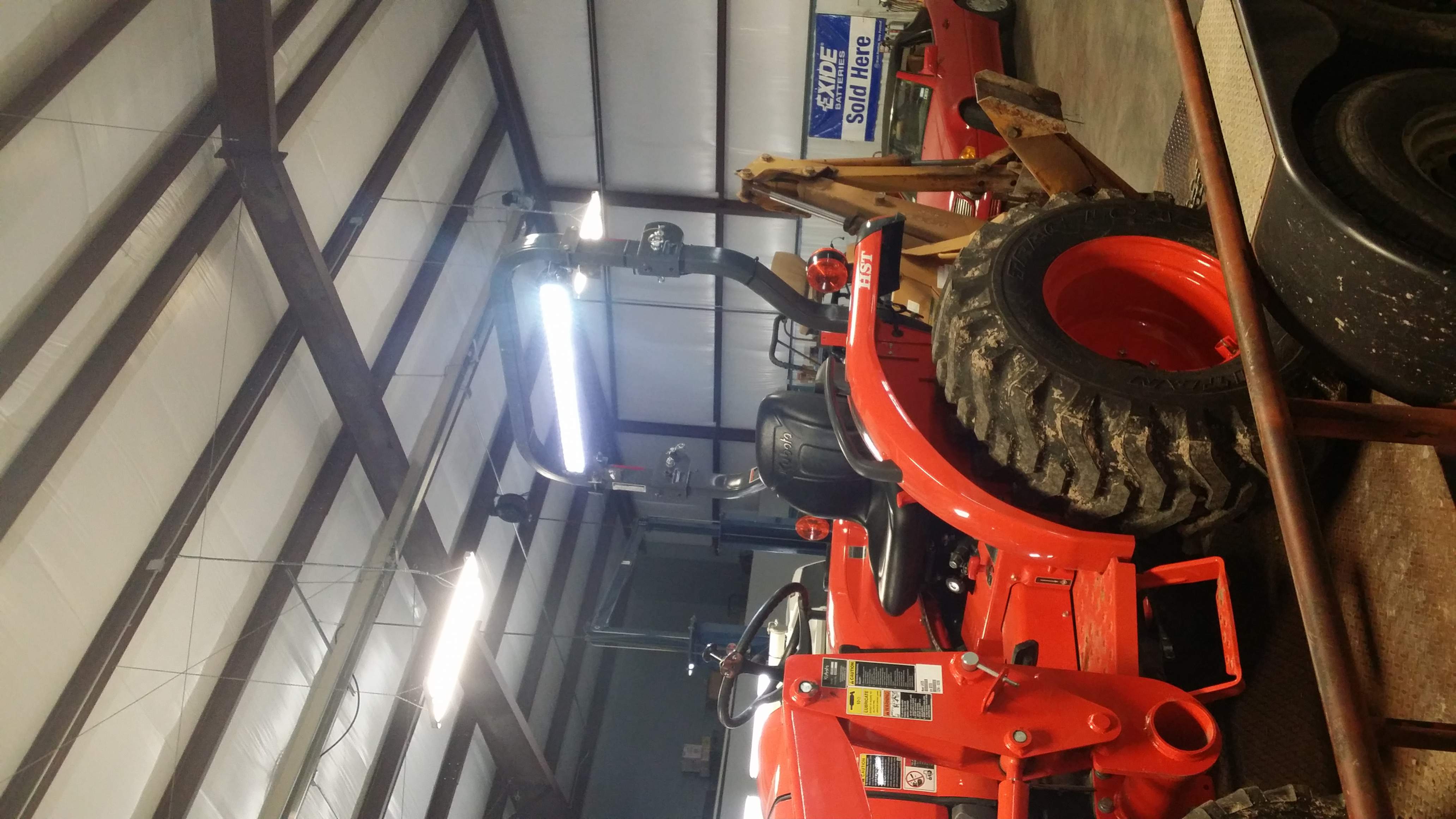

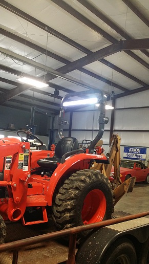

I bought the 24" LED 120W spot/flood and mounted on the rear cab of the tractor. I plan on buying another for the front. I think I paid around $70-80 for the light.
