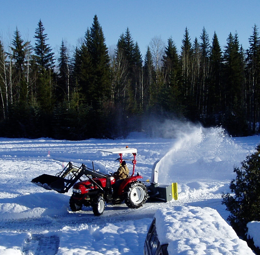

The house came with a small MF tractor and a 5' 3pt snow blower. The snow blower was too much for the old tractor and would over heat. The snow blower works well but doesn't fully cover the tires. Still waiting for a heavy snow of 1' or more than I should get a good idea how well the snow blower works
If the blower works good you might try adding 'wings' to the sides of the blower.
I did this once to a 4' Woods that didn't cover the width of the rear wheels and it worked out real well.
I added 12" to each side and incorporated drift cutters onto them... the blower handled all I could cram into it.
Just a thought.
   / Looking for a rear snow blower for my new Kioti RX6010C tractor. Live in Colorado #35
Here is what I did to my blower (73") that was too small for the width of my rear wheels. Works well now but I really need an 84" blower to be satisfied.
