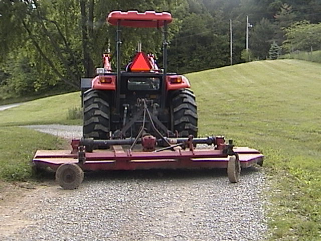

Make is Bush Hog. I have it down by the road right now with a For Sale sign on it, and I know it has a tag on it, but I'm to lazy to go down there and read it. Not sure of the age.
We have always called it a "brush-hog". It has 3 gear boxes. Not sure of the front to rear length or the weight. I can pick it up with my loader and pallet forks and not have the rear of my tractor come up. This is with nothing on the rear.
I'll see if I can get this picture up.
RedDog
