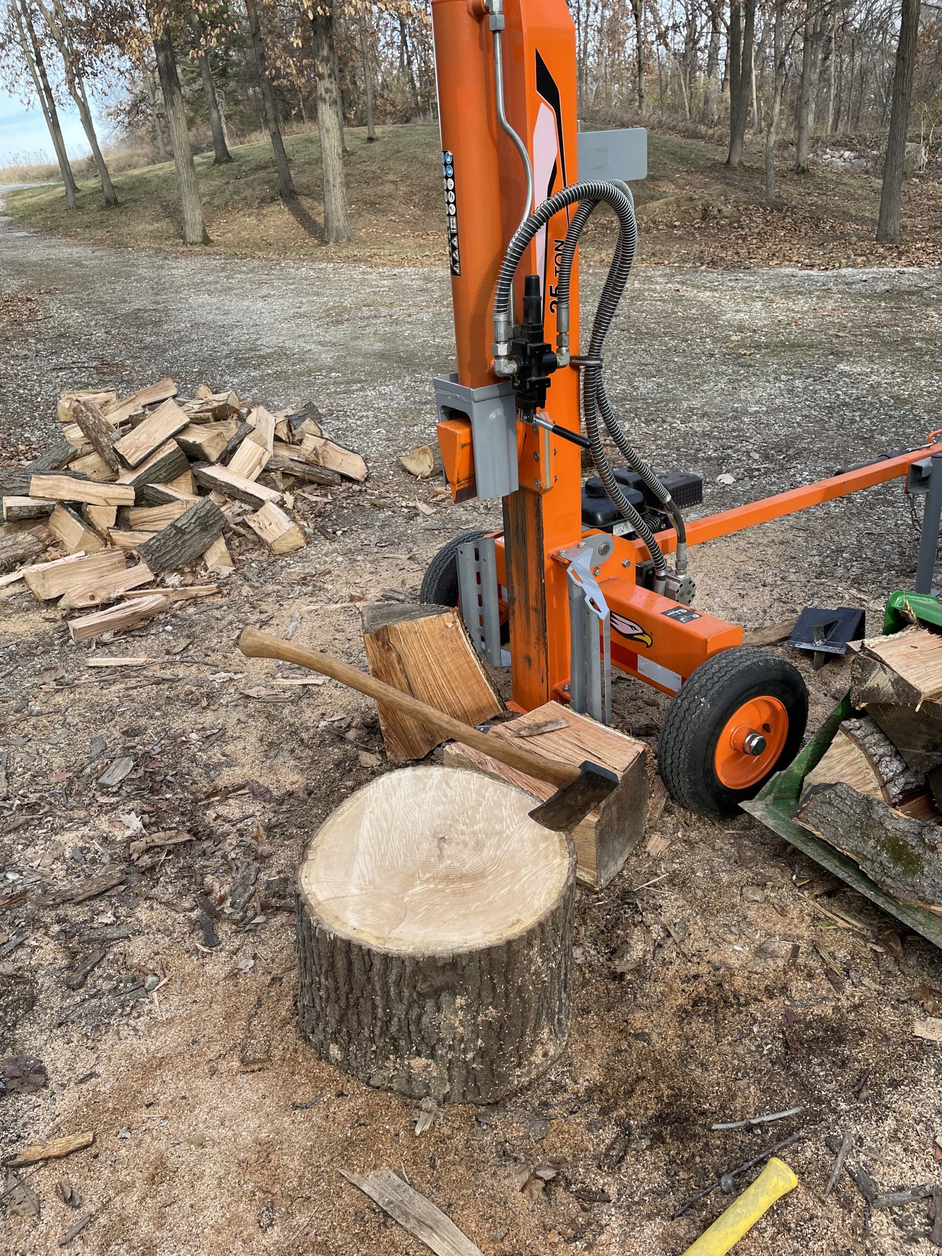

I got lucky and bought this used about a year ago for $800. It was lightly used and goes both horizontal and vertical. I prefer horizontal but for large rounds I go vertical. In the picture I sit on the large round to split. The axe is if you get one split but it won’t come apart all the way. From what I’ve seen a splitter like this will go for $1300 to $1500 now.
What make is it?

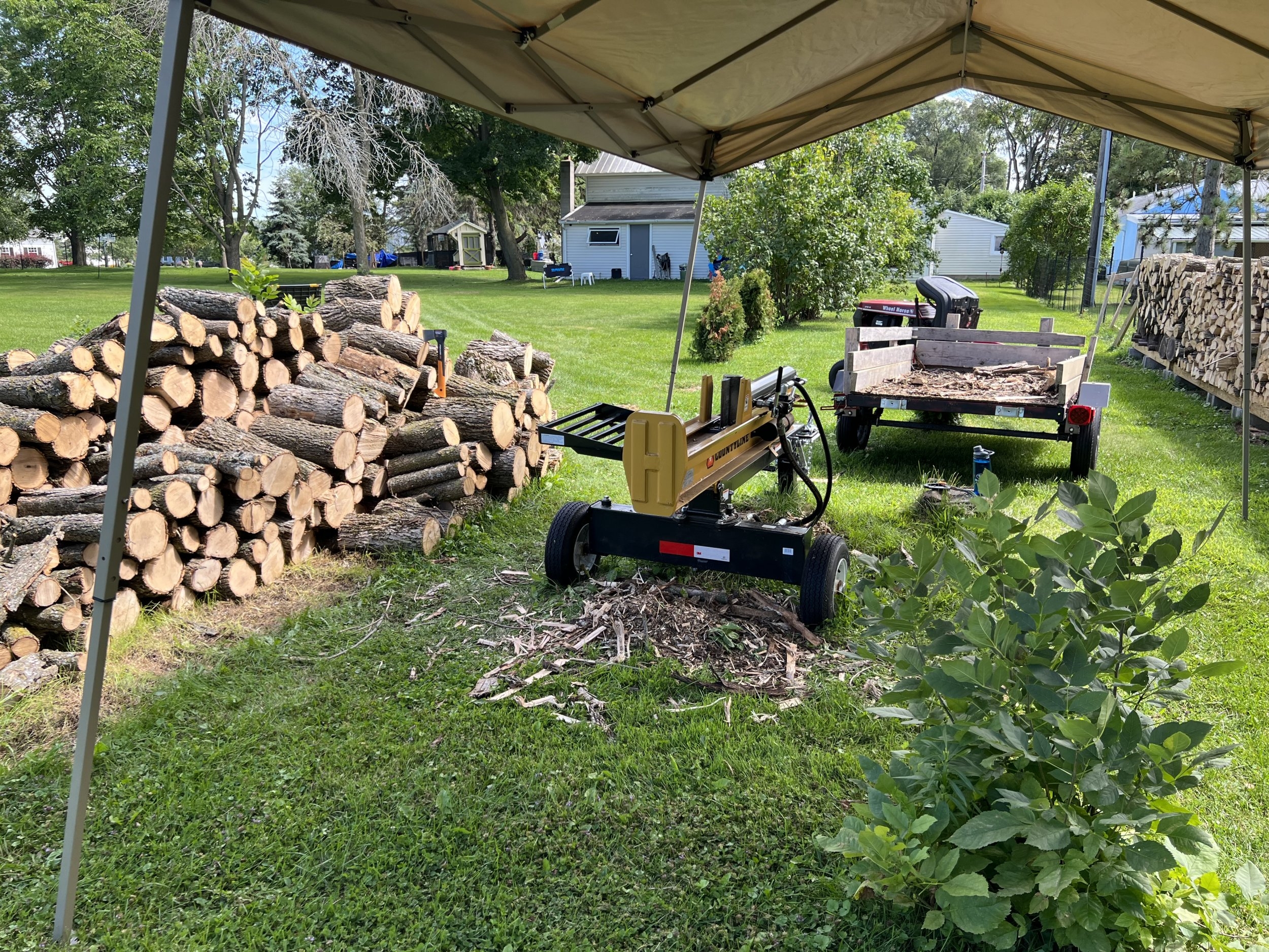

My countyline from TSC has been a solid unit and has split cord after cord. It’s easy to start and works well. It works vertically, but I almost never use it this way.
I pull it around my property, but the wheel bearings can’t handle speed and I think it’s rated at like 25mph max so it should be trailered for any distance. I’ve looked at some of the pro ones and while they are amazing, I could literally buy 8 or 9 of what I have and it works well.
