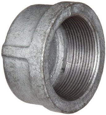

I've got a 3" gas water pump from Harbor Freight. Unfortunately, the gas cap vibrated off and landed on the engine. I arrived to find a melted plastic pancake. An email to HF was met with a "Sorry, parts no longer available" message.
The OD of the threads on the gas tank are about 2 1/4". A generic 2 1/8" cap sold at places like Home Depot is too small.
Any bright ideas on where to look for a cap or ideas to make one out of common materials? :confused3:

maybe a 2-1/4 npt black iron pipe fitting ? or plastic/pvc npt fitting?
or even brass my bus uses one about 2-3" in dia

Ding, ding! We have a winner. Turns out it is a 2" NPT thread. I found a PVC cap that screws right on. Now I need to cobble some kind of gasket and make a little vent hole
