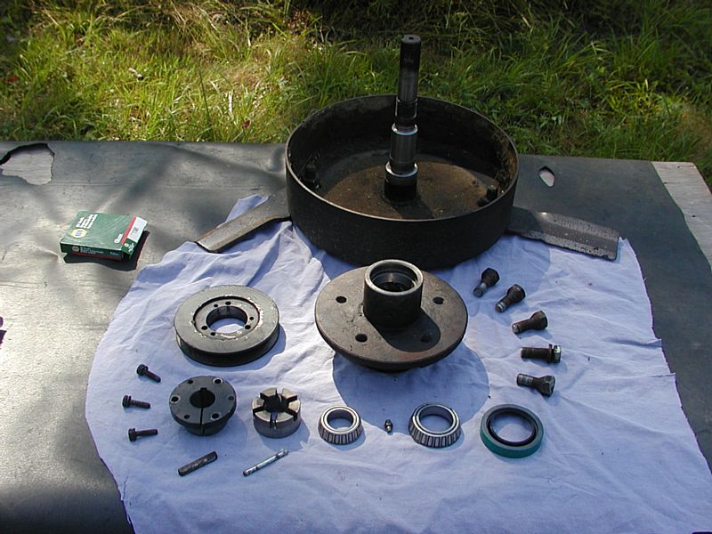

FYI, Here's how the spindles in my 72" roughcut are built. It looks like PT took a simple 5 lug trailer hub and welded a stump jumper "bucket" on the stub end and called it a day. It works well except for the tapered lug bolts drawn into straight holes in the deck they use to mount it - it keeps loosening up from the limited contact area.
I'd wager Charlie is right that these assemblies would bolt right on a finish mower.

thx sedge. i remember seeing that along with your exceleent research and writeups on deck and blade improvements. I've been looking into used pt decks. asdie from blade configurations they all seem to be typical PT bulletproof construction. I'm thinking about a three or four foot rough cut deck on the front and finish mower on the back.
While our fields are tall in weeds, poke and locust saplings right now, we'll eventually get down to maintenance so perhaps finishing mower would be fine for the six foot pull behind...I don't recall if you ever just had finish blades on yours...any insights into how the finish mower handles high grass...how big is the difference between finish / rough cut mowers?
