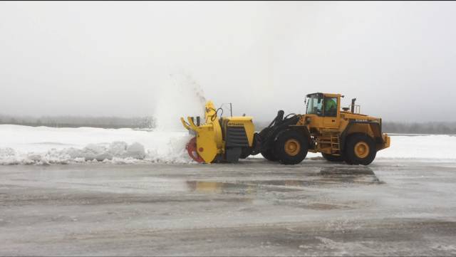

If it gets real bad with snow this is the front blower that works very nice. 550hp blower is quite effective.
But to be serious, almost all blowers here in Scandinavian is the pulled type, and they works, period. img_2485.jpeg
   / Looking at pull type snowblowers #73
Well, that's a very small tractor with almost no ground clearance, on such tractors a pull blower makes very little sense, but on a normal, small tractor 40 to 80 HP with proper ground clearance there are very rare you can't drive in the snow.
That end loader the neighbor uses has been overwhelmed before with the drifting snow. Then he gets his grader out.....

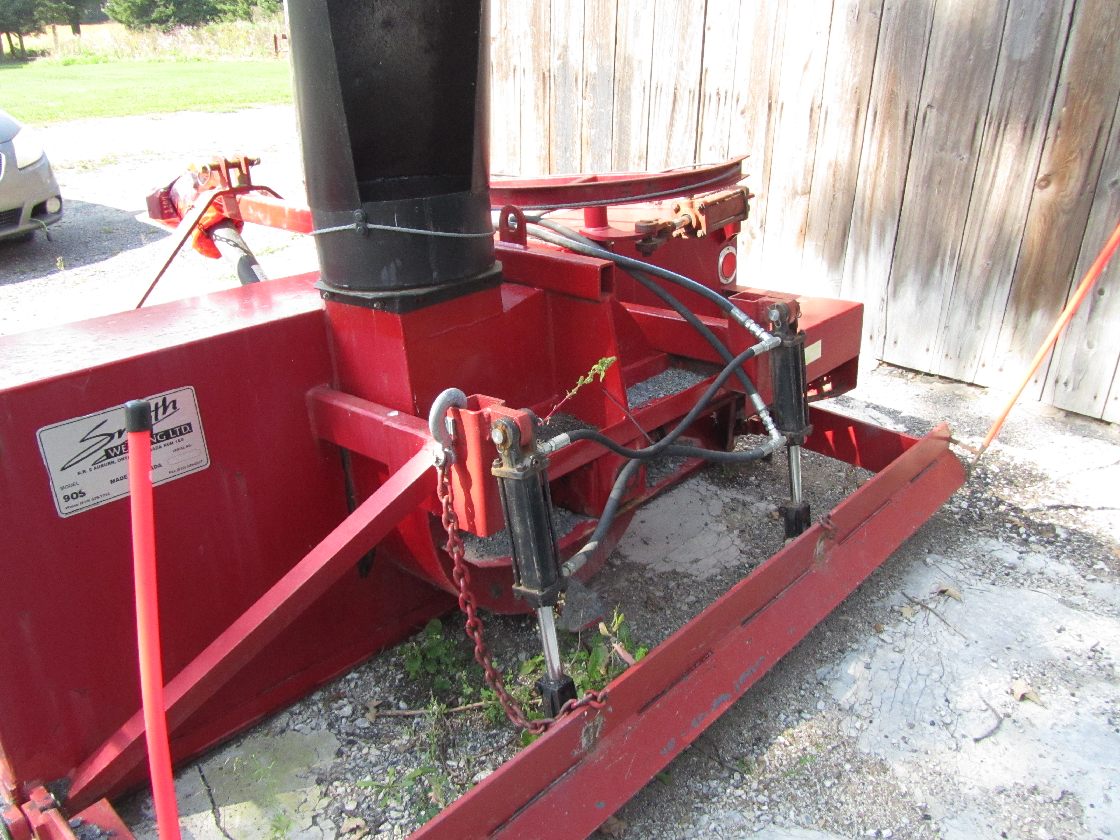

A pull style blower with a back blade will do most any job.
A real great feature is being able to back right up to doors and pull the snow forward a bit then back up and blow it.
For my two brothers homes, I have garage door remotes in my cab. I open their door, back up and lower the rear blade on the concrete floor and pull all snow away from the garage.
No shoveling ever necessary.
Deep drifts, back into them with the blower up high and pull the snow forward using the rear blade.
I had a traditional style back up blower for 20 years+ . The pull style is one I would never leave.
I even use the blower and its blade for leveling top soil and gravel.
