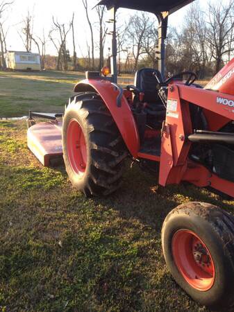

Hello everyone. Next weekend I will be looking at a Kubota M5040 2 wheel drive FEL with 7 ft bush hog. it has a little over 100 hours on it and it comes with INS. Looking online and not finding much price information. Do you think 16k is to much?
/ Looking at Kubota M5040 #2
Tractorhouse.com has several kubota M5040 listings. The majority are DT models (4WD). 16K does not sound too high for only 100 hrs., loader and cutter; essentially a new tractor. You can offer less, say 14-15k and see what happens. Just keep in mind a 4WD will do more FEL work in less time and hold its value better if it is well maintained.
/ Looking at Kubota M5040 #3
Well, I feel it may have been top money but I gave 18K for a M4900 last year. It had just under 600 hours on it. I think it is the predecessor to the 5040. This one is a 2005 model. Good used tractors hold their value. I think if you click on the image it will enlarge.
/ Looking at Kubota M5040 #4
might check what was done for the 50 hr service. are the rear tires loaded (good idea being 2wd) how many rear remotes? the M xx40 series are great tractors w/o all the current emission stuff. price seems about right but agree w/coolnature to negotiate. best

great, doing your homework always pays off. again, w/a 7' hog, might look into loading rear tires for stability esp on slopes. best regards & of course, must have pics here if you go for it ..... btw going w/a 50 hp tractor in the M series imho is far better than one in the L or Grand L series but that's just my bias. M series is a league unto itself..... :)
/ Looking at Kubota M5040 #7
One thing for sure - the tractor is brand new. 100 hrs - it isn't even broken in yet. Loading the rear tires with rim guard will give you 567 lbs/tire.

Well I got to look at the tractor this morning and was impressed with it. Saw a couple of small things broken like lights,seat loose and the PTO gauge not workeding. Owner agreed to bring it to the dealer and have fixed before I buy it. It was his idea and that was one of the things that sold me on it.
Going to pick it up next week. Thank you all for the help. I will post a pic Sunday
