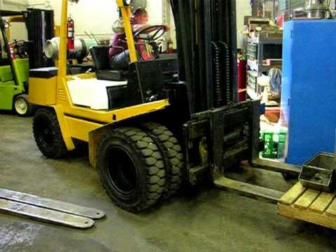

If you need to be outside on gravel more than inside and have room inside, I might look at one of the ones that is built with dual wheels in the front like this:

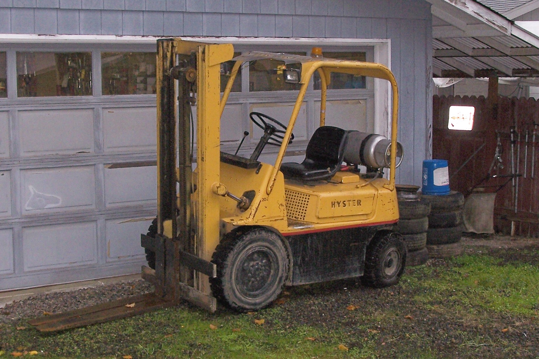

Sometimes the bigger ones are better deals because the smaller ones are in demand more. Mine is a Hyster H50H of unknown vintage, but it was only $500 from work, saved them from fixing it up and running it through the auction. 5000 lb capacity, had a weak cylinder (in the engine) and the steering box is sloppy to where it wants to groundloop but it works fine for my use.
