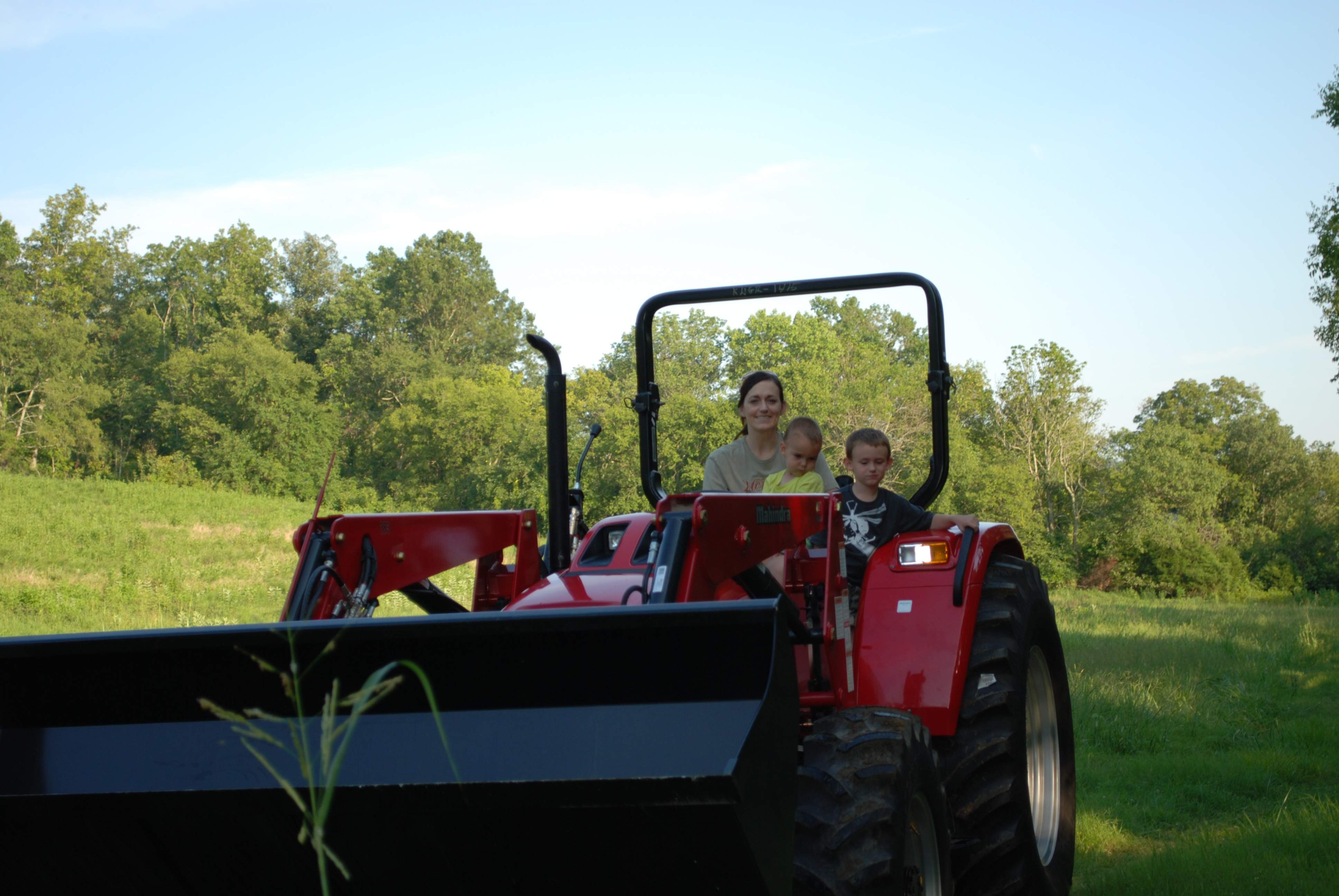

Couple of pictures of the Boss's on the tractor
Sirchancelor,
Nice looking family, along with Y'alls new addition. Get your bucket reinforced ASAP. Because it is easier to reinforce a straight bucket compared to a bent one. You will bend it or at least twink it. Weld an angle on the upper lip, side plate reinforcements, along with chain hooks and a receiver hitch tube.
Your loader joystick sure looks like it is too high. Is it just the camera angle?
