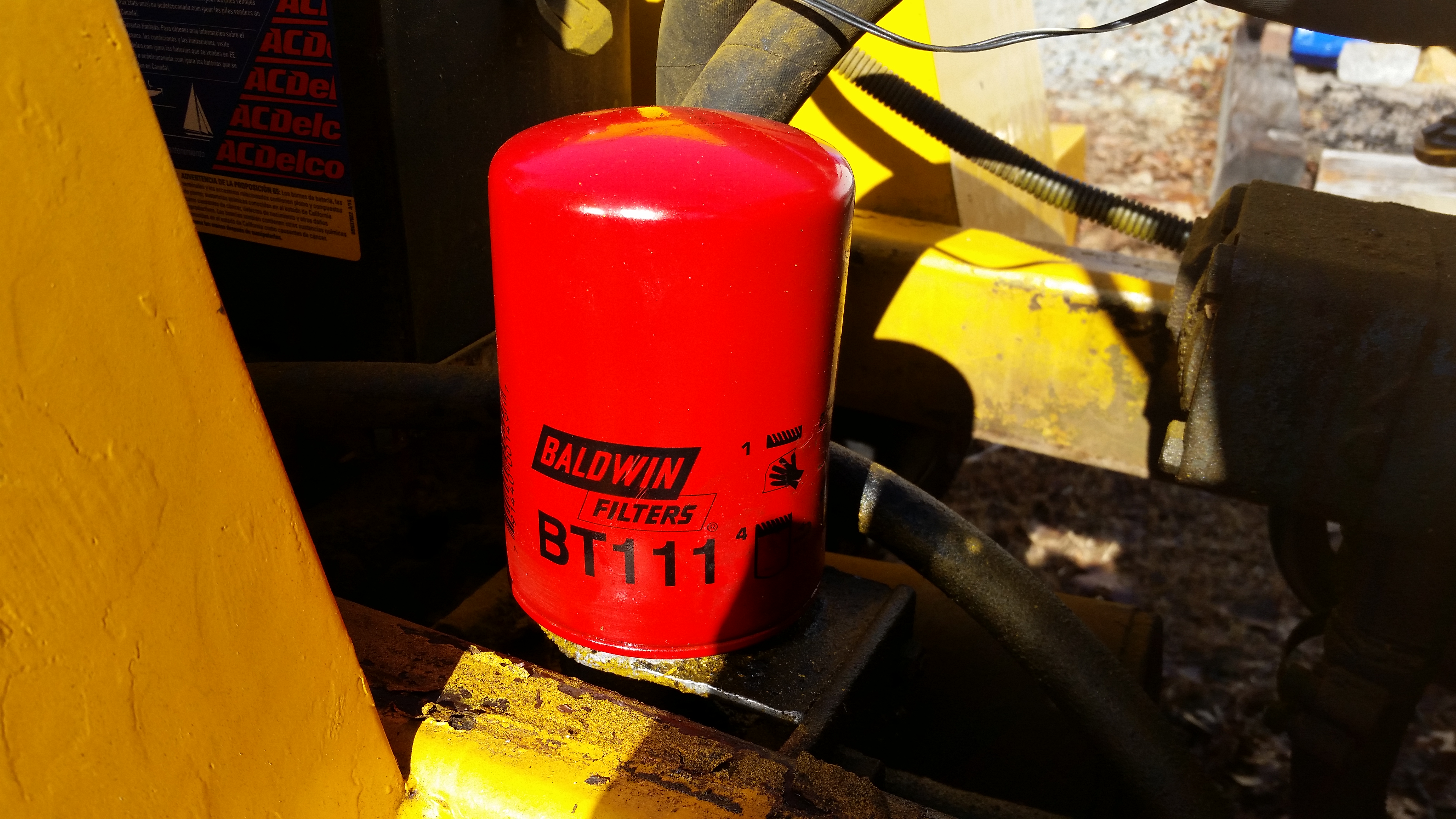

This is the filter currently on it...but I doubt it is the correct one, even though it fits the pump and is only labeled as a hydraulic filter and not a dual acting motor oil/hydraulic filter. I also think that that some hydraulic filters differ from motor oil filters in that they do not have the by pass feature if the filter gets to be to clogged with contaminents. filter1.jpg

Here is the BALDWIN BT111 mounted on my machine...I would say it is about 2x taller then a normal car oil filter...
It does not have any writing / markings on it that indicates if it is a oil filter or hydraulic filter. filter3.jpg

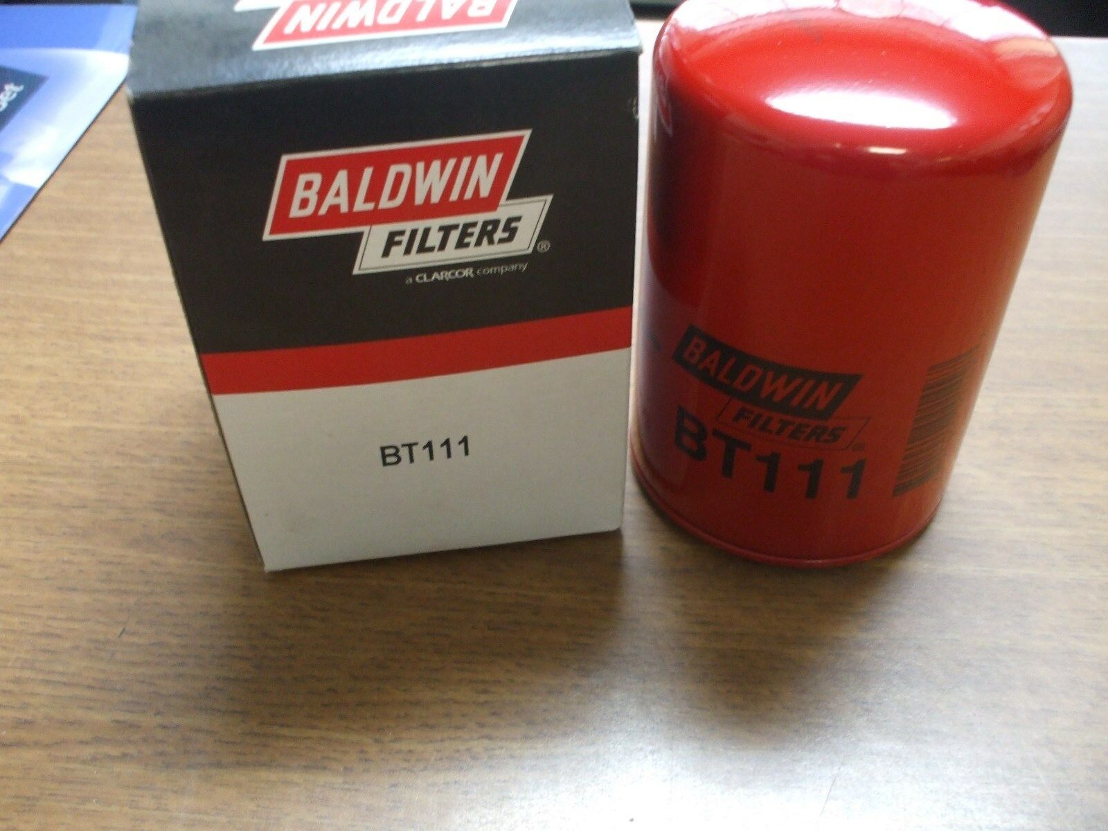

On the Baldwin site it is called a lube filter. But if you Google it you will find different sellers calling it a lube filter and others calling it a hydraulic filter. I would email Baldwin and ask them directly. Explain that it's a hydraulic system using motor oil. Let us know what they say.

I did some poking around on The Wix site and found the lookup by size. The Wix 51545 dimensions are the same as the Baldwin BT111 (thread, gasket size and overall size) and it's listed as a lube/hydraulic filter. Maybe this will help.
   / Look at this old T5 from the mid 1970s, I just purchased... I have a quick question #27
I crossed the Wix 51545 over to a Baldwin B252 which is listed as fitting an Allison transmission. I keep mentioning Wix because they have a good reputation for making a quality filter. STP and other brands like that are made by another company with more attention to price than anything. I think I would run a couple of cheap filters a few hours each to clean up the system then change to a quality filter and call it good.
