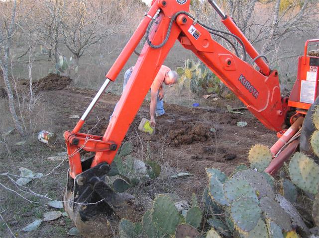

I replaced the 4 way connection with a deeper lip 3 way connection and drove in a 6' T-post to hold the line in place. I have check the water meter 4 times in the last 4 hours and each time the wheel is still
I hereby declare the leak fixed!!!!!! /forums/images/graemlins/smile.gif
Thanks.

Don,
Congratulations!!! That can sure be frustraitinng and I'm glad to hear you found the problem.
I'd mark the place that you put that PVC union on the line. I'm not a big fan of them and it's now the week link in your line. Put a brick or something destictive in the ground so you can find it five or ten years from now.
I'd also replace those palstice PVC ball valves while they are uncovered.
Lastly, I just found out it's a good idea to put severl bags of readi mix at the end of the water main when it ends. The T-Post is probably plenty, but for a few bucks, you'd never have to worry about it ever again.
Thanks for posting the pics, it was fun following along with you on your search, plus all the great suggestions.
Eddie

Eddie those are new ball valves. What would you suggest they be replace with? The metal valves corrode quickly here is this sand. When I went to turn on a metal valve in the field, that I had not used in a while, the handle crumbled in my hand. I always wonder which is best the brass or PVC valves for underground use. For valves exposed to sunlight I always go metal. I also really don't like the unions. Is there anything better for a splice? The only thing I could think of was to uncover about 20' on each side of the break and try to bow the line enough to slip on a coupling and a cutoff valve. WWED?
Egon, the thrust blocks are a good idea. There was a lot of pressure that broke the back of the box and allowed the first leak. (see attachment)

3rrl, good idea and they are part of the assembly under the box. (see attachment) The brass/stainless steel is the better shutoff and I might replace them later. there is also another cut-off at the house 10 feet away and at the barn so the PVC usually aways stay open.
The bad news: I now have another leak.
The good news: it is small, and I know where it is.
You were right Eddie those unions are cr$%p.
I went to the local Ace Hardware store and got a different type of union that all the people around here use because they work so good and are easy to install. It is PVC but there are no threads to tighten to hold the connection like the one on there now. It can expand and contract so the glued connections do not break.
I will find out tomorrow if it works.
Jim I did not see your post earlier. Lesson learned. When I connected the backhoe I told Karen that I am either going to find the leak or make one. Since I would have had to go to the store either way I took the chance. The big lesson I learned is if I don't have repair materials on hand do not work past 4 P.M. I could have saved about 40 miles of driving and would not have had to work in the dark.
