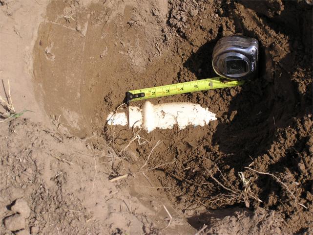

Thanks TBN members! All the advice and thoughts you have given me have been going through may head as I was trying to find the leak. I checked about 50 slip connections starting with the ones closest to the cabin. This was the sandy hilly area with a slight turn and a tree and some rocks. Since there was a leak here 2 months ago it seemed the logical place to start.
I got down the first hill and saw all the connection, including the first slip joint past the cutoff box I had repaired 2 months ago, had not moved. I then thought it would be where the soil change and the beach sand becomes black gumbo. After the second hole in the hard hard black gumbo/red clay the wife told me to hook up the back hole or we would never finish.
Well On the fourth hole the last hole of the day on the last scoop of the day, just to clear out the hole, and not dig any deeper, I heard the wife scream.
Water came bubbling out of the hole. It was 7 PM. All the local stores were closed. Darn Darn Darn... I was cussing all the way to the front gate to turn off the water and all the way to the the hill to tun off the water at the cabin. See attachment for the damage I did to the water main. /forums/images/graemlins/blush.gif
/ LONG Water Line Question
#38
It was about 10 PM when we got back from the closest Home Depot with a temporary union to install. (The cut off valve would have to be installed in the daylight.) As I was standing in knee high water bailing out the hole by flashlight I thought about what Jim said about liking the night sky. I looked up and saw the stars on this moonless night and then coyotes started yelping in the distant and I thought this is almost as bad as country life get and it is not too bad. In fact I kind of enjoyed the experience. At least it was 69 degrees and not 39 degrees. The wife and I flushed out the lines and I installed the union and stopped the leak by midnight. See Attachment.
