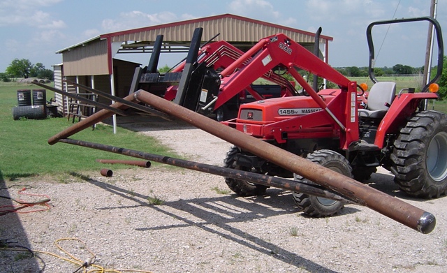

Sucker rod is usually 25ft long solid rod. It has a threaded coller on the end to screw each section. It comes in from 1/2in up 1in or more o.d.. Its used to go inside well pipe (oil or water well) for pumping of liquid from the bottom of the well. Mine was used 1/2in rod and the price was around $6 a stick. The pipe was 2 7/8in o.d. used oil field pipe and the last time I checked was $1.25 per ft. New 2 7/8in schedule 40 pipe I would guss is aroung $1.75 per ft. Problem with buying used oil field pipe is the length. Its usually 30ft to 32ft in length so it takes a long trailer to hall it. New pipe is 20ft length and much eaiser to handle. Personally I liked being able to screw the used oil field pipe together and not have to weld.
Hope that gives you some idea on material costs but your area the costs will most likely very.

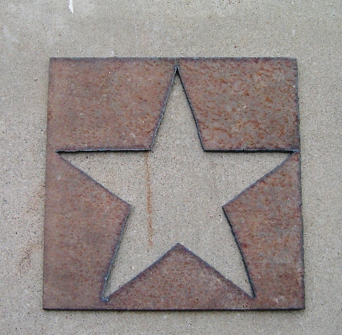

Here are some pictures of the stars place inside the sucker rod. There will be one on each side of the gate and one every 6th section. The stars are cast aluminum with weld tabs. I made a frame out of 3/4 square tube. This allowed be to be able to weld the sucker rod anywhere I needed it. There are a total of 10 stars.

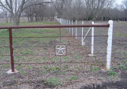

Stars installed in the fence.

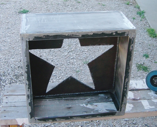

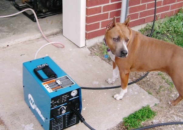

Starting to work on the light box that will be in the center. This is a picture of the new plasma cutter and my helper. She's good until dinner time.:D

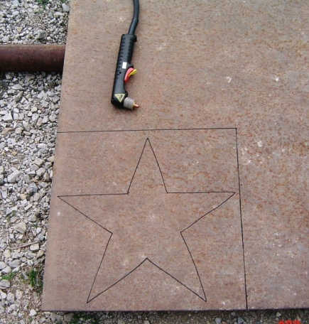

Started out be laying out the pattern on a piece of flat plate. Then cutting it out.

This picture is of the box mostly complete. Time to add the extra's.

I have stainless steel screen to cover the star and the bottom of the box. The bottom will be open so the light will shine down on the gate as well as thru the star. The hole in the upper left corner is for the sensor. I wanted the light to come on automaticly at dusk.
