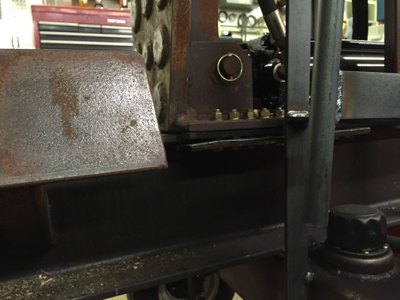

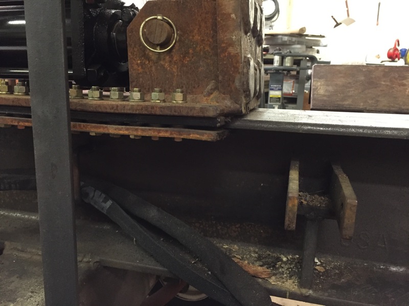

Meant to post these two pics yesterday. They show the plates on the underside of the push block, that capture the push block to the beam. I think the plates are 3/8" thick x 3" wide.
Notice the edge at the very front, where there isn't a bolt and how it's bent down:
The side shown in the first photo seems to be the worst of the two.
I think this was caused by trying to split rounds that wanted to cause the push block to rise up off the beam.
Questions are:
1. How concerned should I be about this ?
2. Should I trim those plates on the bottom back some, closer to the bolts that secure them to the push block ?
3. Do I need to consider using a thicker plate for those pieces ?

/ Logsplitter 2.0 #424
I'd put a bolt in the front and squeeze it back down.

/ Logsplitter 2.0
#425
The photos are kind of deceiving as far as the setback of the bolts from the edge ... I don't think there is enough room there to drill a hole and get a bolt with its head (and/or a nut) ... due to interference with the upright portion of the push block.
If memory serves, I think I actually had it drilled for another bolt in the front of the bottom of the push block, but ran into the interference issue and filled the holes in.
In hindsight, I probably just should have ground back the weld a little and went with it.
Or made a better design decision as far as hole placement goes.
