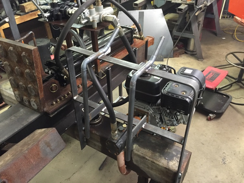

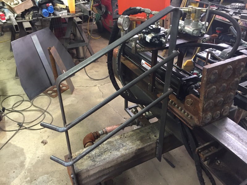

Rear guard, log lift side:
Rear guard, engine/pump side:
Still need to stick a cross bar between the two rounds just above the pump ...

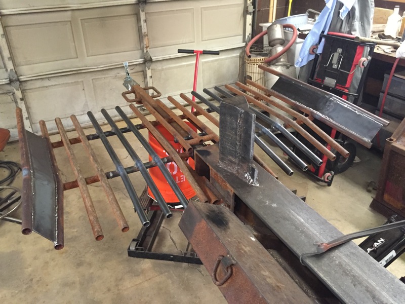

Widened table grate, with the new tubes bent down so nothing catches them (hopefully) and some 10 gauge sheet on the sides ... so nothing catches the solid round stock that supports the outside pipes:

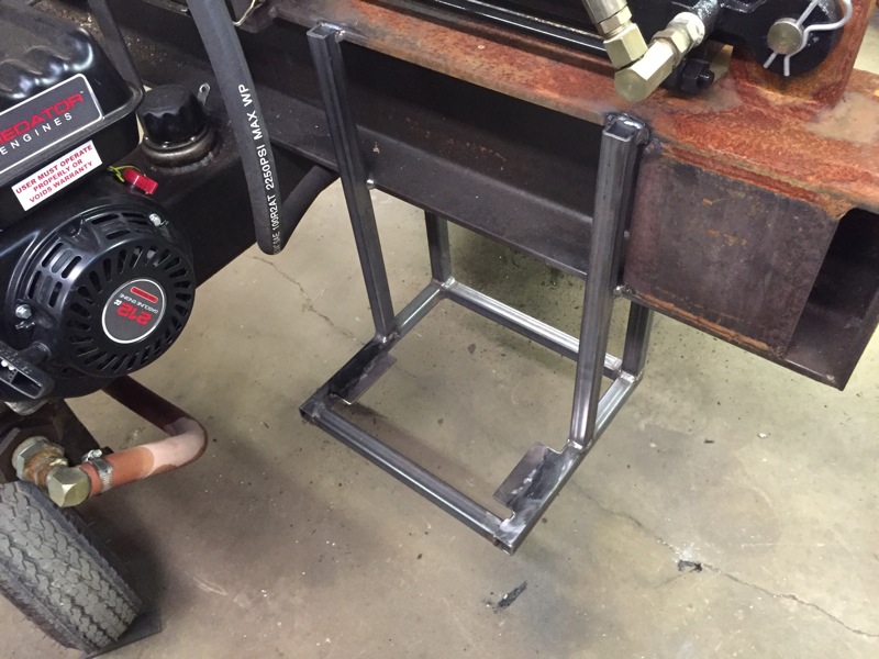

Tabs welded on the mounting frame for the 2nd hydraulic tank, so it can be bolted down:
I drilled the mounting bolt holes for the tank after I took this photo. I also tapped them (5/16-24) ... mostly because I wasn't sure I could get a nut on the other side (a design oversight) ... without it hitting the square tube.
Did a little more welding on the tank mount as well, to make sure it was tied in good. Still need to cap/plug the tops of the square tubes.
I have a number of minor little welds to make here and there ... but they will not get done until the unit is disassembled and the engine/pump/hydraulics are removed so it can be painted ... primarily because all that stuff is in the way.

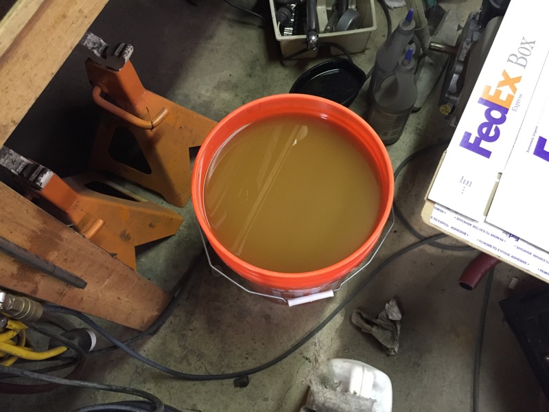

Got the hydraulic fluid drained yesterday ... looked about like coffee ... with cream added :(
Assume that is water from condensation, in emulsion. IIRC, I think the splitter sat out over this past winter.
Reasonable to assume that it can be run with this water-laden fluid - without damage - and the water will evaporate once the oil gets hot enough ?
I will be adding at least another 5 gallons of (new) fluid to bring the tanks up to a reasonable level.

In regard to the water in the oil...unless there's a breather or fill cap that would allow some splash by during storms...I'd assume it was condensation...
Don't know about it evaporating...where can it go?...seems like it would take forever to evaporate and vent out through the tank vent?...the ambient humidity is a factor...

Here's the fluid after 24 hours ... the water has already started to settle out a considerable amount ... it was much more "milky" when I originally drained it. The top inch or so is now much clearer.
That's my guess as well.
Part of the problem may be short run times ... which I have been doing a lot of lately: use it for an hour or so ... which might not be heating things up enough to drive the water out of the oil.

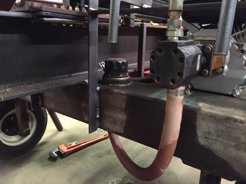

Here's a pic of the fill/vent on the original reservoir:
It sits up about an inch or so off the surrounding surfaces.
Out the vents is the only place I know of ... I do have a vent on both tanks.
I dunno ... could very well be ...
But then I'd think this could also be a problem for our tractors as well.
Yup ... we've had quite a bit of rain over the last 30 days or so.
