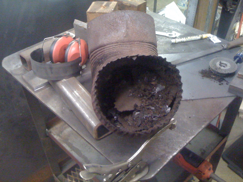

Ran into a little situation the night before last: had some creosote/debris fall down into the 90 elbow that connects the chimney to the double-barrel wood stove in the shop, almost plugging it ... which prevented me from really getting a fire going. So I spent some of yesterday cleaning out the stove/chimney.
Ultimately ends up being a good thing as it needed it (overdue) and allowed me to discover that the 90 elbow really needed to be replaced, as it was almost rusted out ... up inside the pipe that it connected to.

I had the same thing happen with the elbow,rusted thru.
Yeah ... the way this elbow sits, the curve ends up being a low spot ...
I've had some water dripping down the flue pipe at times ... dunno if it's a flashing issue, the Selkirk chimney cap, or just condensation that froze and then melted once the chimney got hot enough ...
Need to check it tho' for sure.

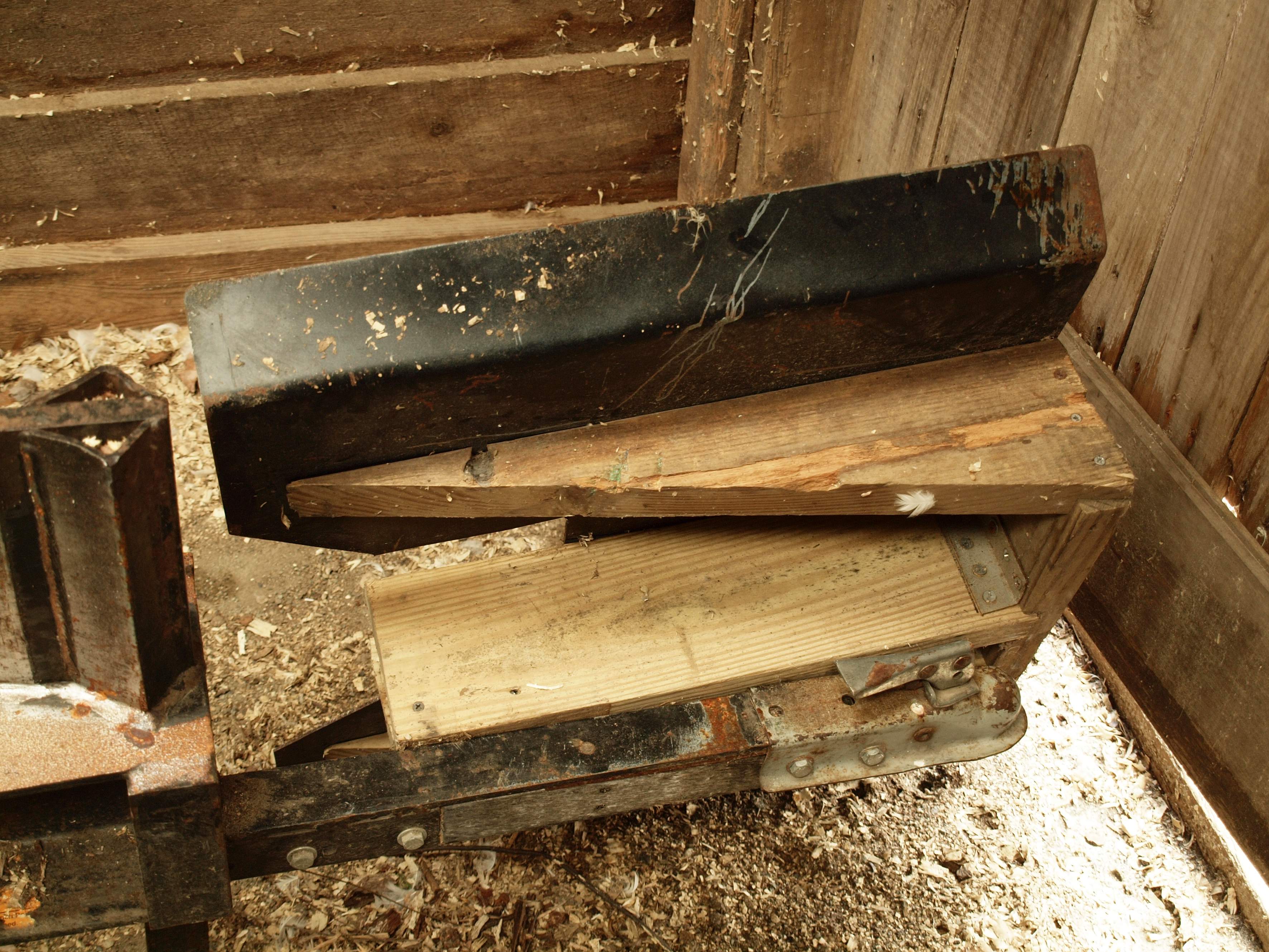

Did a little work with the o/a torch cutting the bevel into the plate for the splitting wedge today ... should save some grinding ... along with some work on the square tube the stub axles will mount into.
Also got the drop-down/fold-up leg assembly for the front fabbed up and the brackets for it welded on ... the holes still need hit with a adjustable reamer to clean them up a little, and the exact length of the leg is still not set in stone (need to get the wheels on it before I do that)
The "foot" is a piece of the web that was torched from the H-beam drop ... I marked it out and then trimmed it with a zip disc to remove the slag/dross from it being cut and square it up, ground the corners round, then cleaned up the edges with a flap disc.
Measures 13 1/4" x 5 3/4" x a little better than 1/4 thick. Hopefully the "footprint" will be large enough to keep the nose from sinking in, when loaded, even in somewhat soft ground.

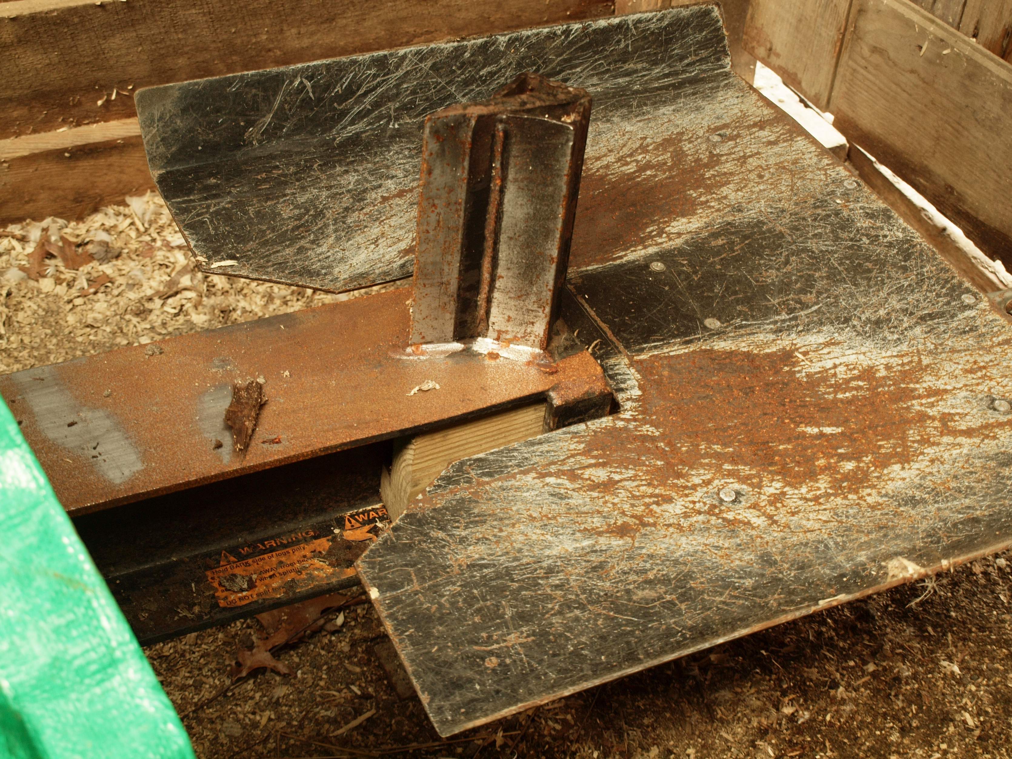

Took the back half of the 18" HF 2" receiver that I cut in half and took some 1/4" x 3/4" flat stock that I had lying around and clamped it on the end of the tube.
Used the o/a torch to heat it up and I then bent it around the tube, clamping it as I went ... the length turned out to be just right.
After that I welded them together:
This will be the receiver for the tail end.
Still have to drill a hole for the 5/8" pin.
