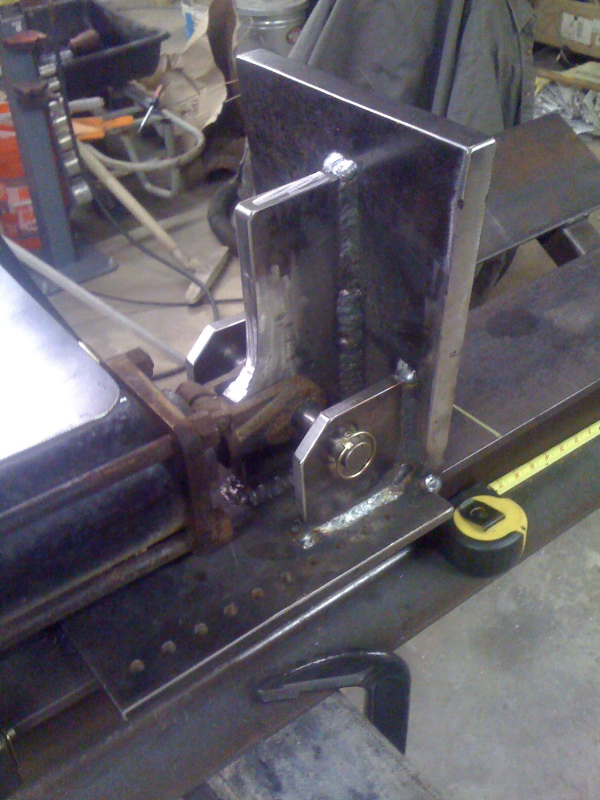

and as for the weld breaking, from your picture it looks like a bad weld, no penetration on the solid, grind it out re-weld it and stick a fillet on for good measure, keep on building
Yup ... will grind it out, bevel/fillet it and turn up the juice. Will also gusset it.
The chart on my welder only goes to 1/4 for .035 wire ... the voltage tap for 1/4" is "E" and with a wire speed of 320.
When I was doing the 4-way yesterday I set the tap up to "F" and cranked it up to 400 ... nice sizzle ... :D

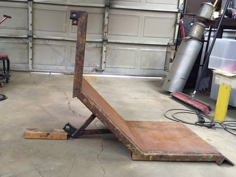

Side profile of the log lift, show the relation of the hinge pins and rod end cylinder attachment point:
I would change the log lift design to one long side, one angle and the base. I think that would give you a better push angle for the log lift.
The one long side works well to stage smaller rounds to be split.
