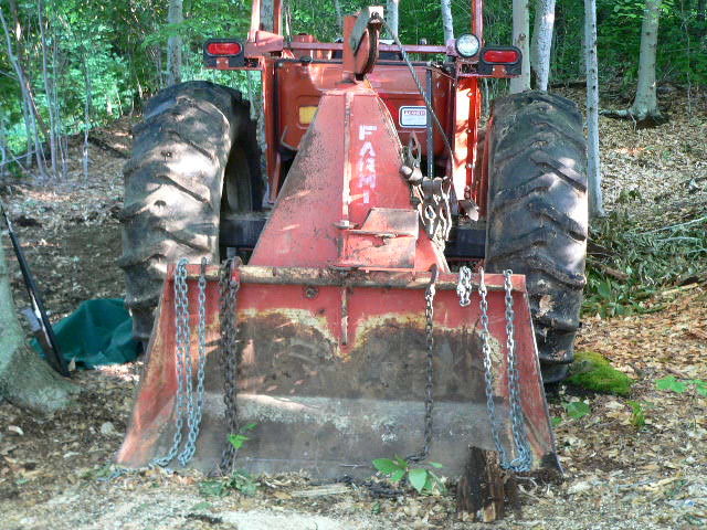

I generally run my tractor at 1,100 rpm (which is about 60% of 540 pto speed) for a single large pull. for a multiple pull or a very heavy single, I will spool the rpms to 1,500, mak torque, but still below the 540 pto speed of 1,800 or so rpms.
   / logging winch question[Farmi] #4
One other thing to look at, is the clutch properly adjusted? I have the Farmi 290, and had to have the clutch adjusted.
   / logging winch question[Farmi] #5

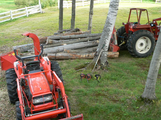

I double checked and the 540 PTO speed on my tractor is 2,150 rpm's, so I am running the winch at about 50% of that speed most of the time and even when I am running the tractor at max torque, (1500 rpms) I am well below 540 rpms on the PTO.
Some implements are not run at full pto speed. for example I run my tiller at about idle or as slow as I can go and still move the tractor. saves banging the crap out of it and the lift and the pto shaft. On rotary and flail mowers, snow blowers, chippers, yeah full pto speed. On the winch....
slow is faster.........
And I had to adjust the clutch on my Farmi 601 too.
Do NOT put oil on the winch drive chain by pouring it from the top, down on to the chain. You will get oil on the clutch and that will ruin it. If the chain needs oiling, spray wd40 on it lightly from the bottom of the winch, while you turn the spool. Don't use too much oil.
