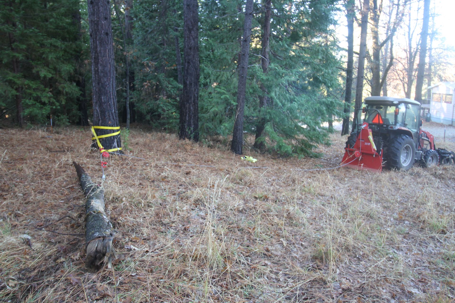

Update:

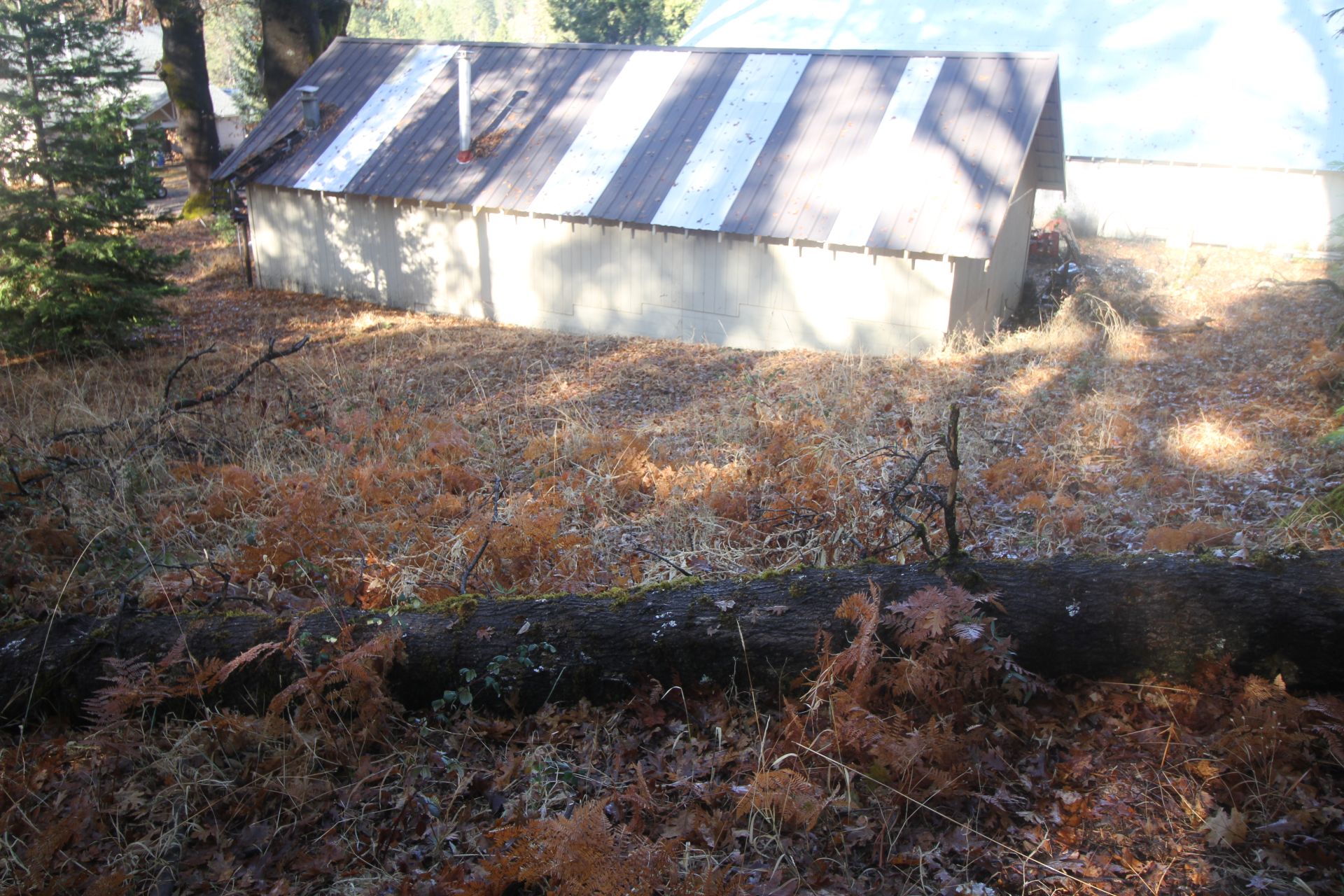

I cut 3 sections from the small part of the limb, about 8-10 ft long each. Diameter up to 10". Very small stuff compared to other pictures here. Pulled them one at a time, no problem. Not much sideways roll.

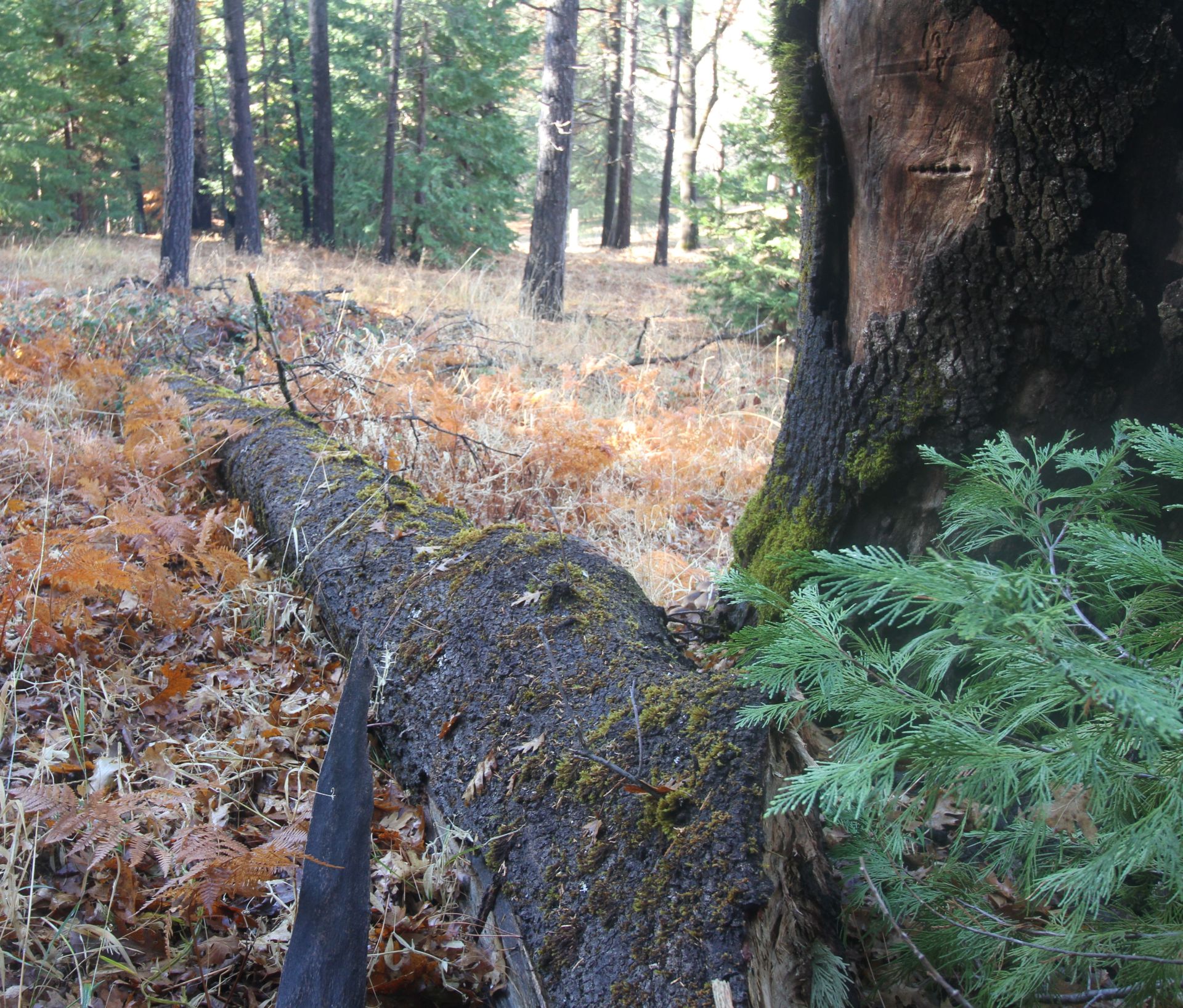

Now, I am hooked up to the "small end" of a 20' section. 10" diameter at the small end, 18" at the large end. My winch won't pull it. When I engage the winch, the line tightens, then the clutch slips. Limb doesn't move.
Not sure what is going on. The Farmi manual says there is a clutch adjustment possible, but this *is* a brand new winch?

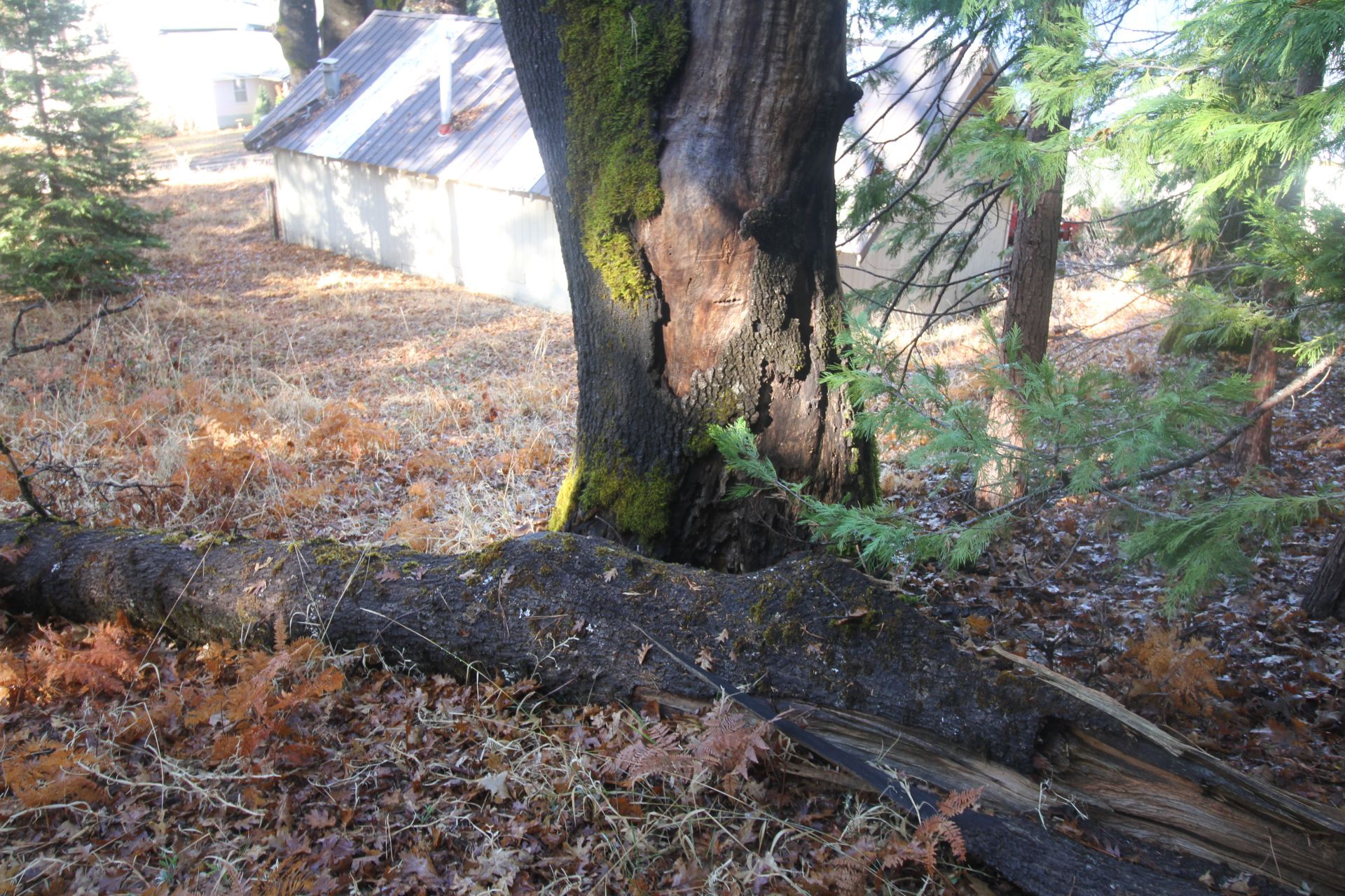

Since it is a fallen limb, maybe when it came down, a side limb burrowed into the ground and is acting like an anchor?
My cable is routed through the top pulley, then the bottom pulley, then through a snatch block at about 90 degree turn, then hooked onto the limb. Any ideas?

As a side note independent of the clutch question often a log gets stuck or frozen to the ground if it lays a while. Also braches stab into the ground as you mentioned. It can be real tough to get these started. It helps a lot if you give it a small sideways pull first at the choker end to break it loose. Or you can wrap the long end of your choker chain around the log and hook the slider at the very end so when you start your pull the wrapped chain makes the log roll to free it. Not good on a side hill maybe. Sometimes you can roll it out from behind a stump this way.

I did find an "anchor limb" underneath the 20ft log, although I think it should have pulled through that. It wasn't bogging the engine nor pulling the tractor. I cut the anchor limb off, cut the 20ft limb in half, and it easily pulled each 10 ft section. The next limb starts at 18in diameter and gets bigger. So tomorrow I will pull hard on the rope.

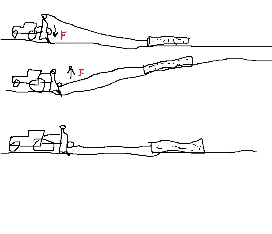

PlowHog I noticed this statement but didn't say anything because of your more important clutch issue but now that you have put that to bed I would like to make another comment. Your winch is designed with a high top pulley for a reason. When you are winching in a log, ideally you want the winch to take all the pulling force and the tractor to just sit there acting as a counter weight. To make this happen you need to drive the winch dozer blade into the ground so that the ground is holding the winch back and not the tractor. There are two things that drive the blade into the ground. The weight of the winch, 400 lbs or so for a 351 I think ??, and more important the tension on the cable. You want the cable tension to drive the winch into the ground. If the cable leaves the top pulley at a downward angle the cable tension will pull the winch down into the ground. That is good. And as a side benefit it will tend to lift the front end of the log making an easier pull. Conversely, if you winch from the bottom pulley and your cable runs uphill to the log so that the cable makes an upward angle leaving the pulley the cable tension will actually try to lift your winch off the ground. That is
bad. If the cable runs out straight at 90* you gain no benefit from the cable tension. The only time I use the lower pulley to winch is when I have to much side angle on the cable. Remember always to winch straight back only from the top pulley. Winching at an angle you loose the counter weight effect of the tractor and you can pull it over very easily. You can also mess up your 3ph very badly with side forces.
Just be aware of these principles. Nothing is absolute as there are way to many variables and you just have pick the setup that seems best and make trade offs.
Here is an older Farmi doc on the 351 which mentions the pulley uses and a crude drawing of the cable forces that might help make sense of what I was trying to say- but maybe not.
Thank you for that. The Farmi manual, and a pin on the lower pulley, were somewhat misleading. The manual does say: "usually the logs are winched through the upper pulley.;" However, in a prior section, the manual discusses tip-over danger, writing: "the falling danger can be reduced by winching through the lower diverting pulley." I formed an impression that using the lower pulley was safer.
The winch was shipped with the cable routed through the lower pulley. On my first "tensioning" pull, I wanted to re-route to the upper pulley. But a pin was preventing the cable from being removed from the lower pulley. It could not be removed without using a tool, which seemed odd. (Tapered pin, pounded into place.) I will replace that pin with something that is easy to remove and replace.
