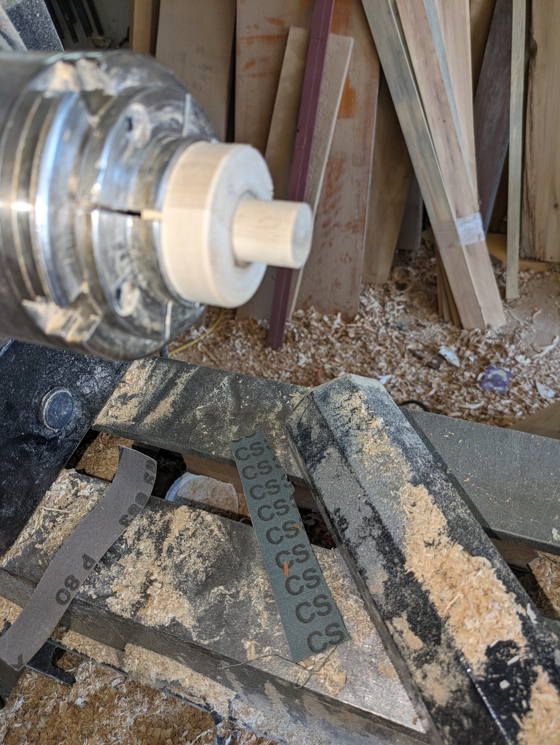

Case 448
The wheels on my Log splitter are very cracked and I found a new pair of wheels very cheap ($20 for the pair) at Mardens (if you're from Maine, you know about Mardens). Problem is the splitter axle is 3/4" and the wheels are 1". Is there any reason not to get a steel bushing to make them work? New wheels are probably $100 for a air and bushings shouldn't be more than $10 +or-. Appreciate any advice. Larry

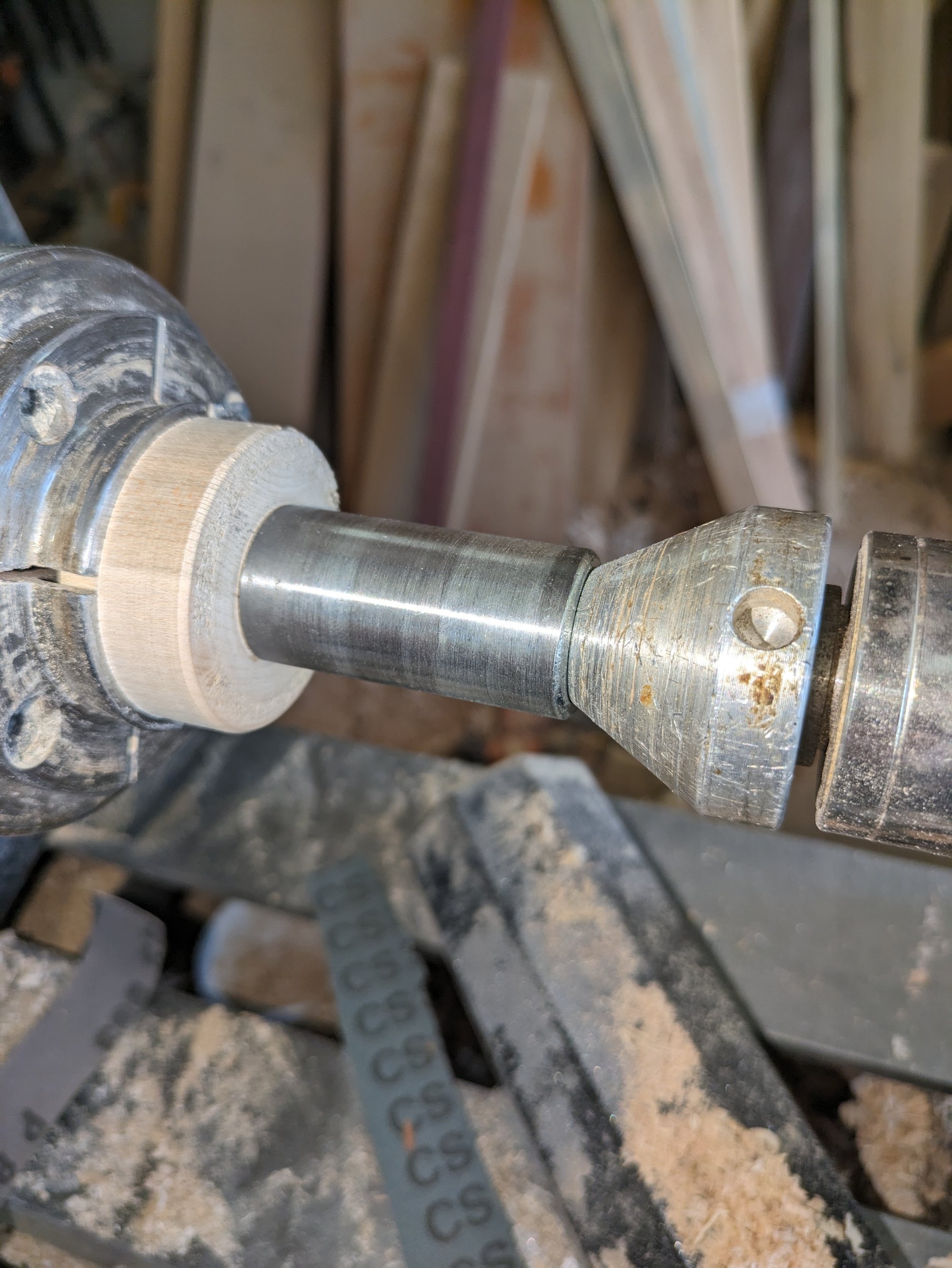

I measured the ID of the bearings and they are exactly 1" so are not going to slide on to a 1" bushing. No clearance. I don't own a metal lathe. Thought about using my wood lathe to spin a 1" bushing and using a file to create clearance. Kind of a frig though

Update: I bought 5 of the 3/4"x1" bushings at Lowes for $1.50 each, so about half of TSC. They were 1" to a few thousandths over so I made a jig on my wood lathe that they would slip over and used a file and sandpaper to get them a few thousandths under 1". I have not gotten around to taking the old wheels off yet but am assuming that axles are a bit under 3/4" and bushings will slip over them but I have a 3/4" drill bit in case.
