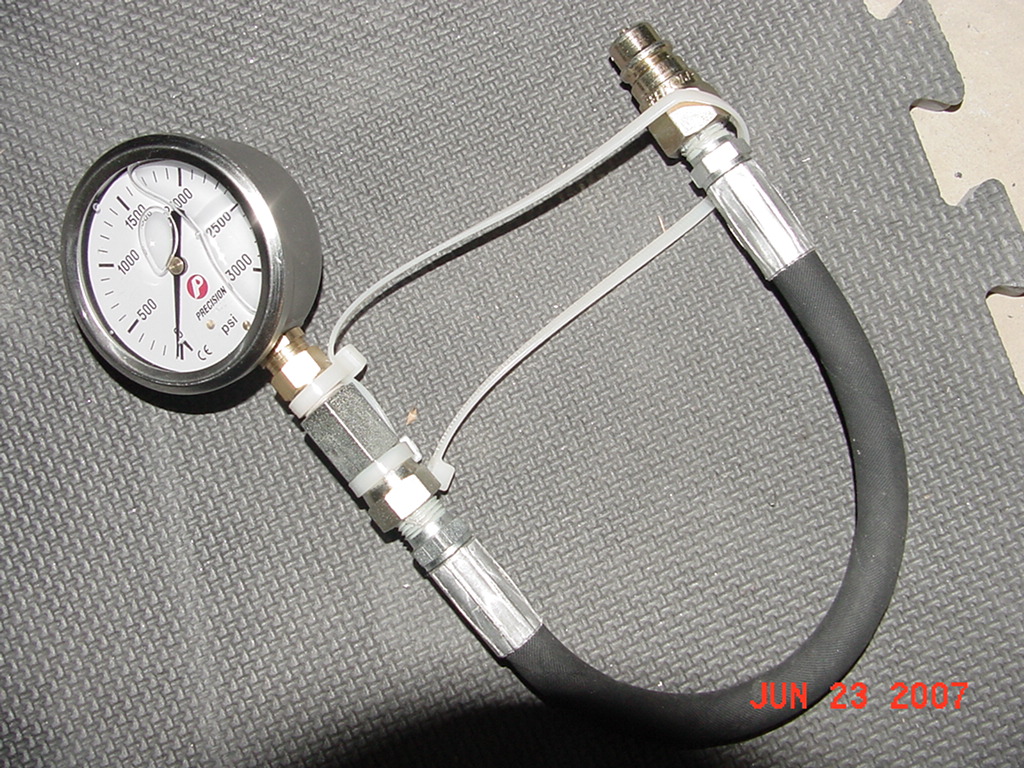

It may be that there is some debris in the relief, and may flush out.
Notice the number of threads showing, and remove the relief , adjust and inspect and clean and reassemble and see if anything changes.
A hyd gage is only about $30 .
Is it an Energy or Prince valve?
