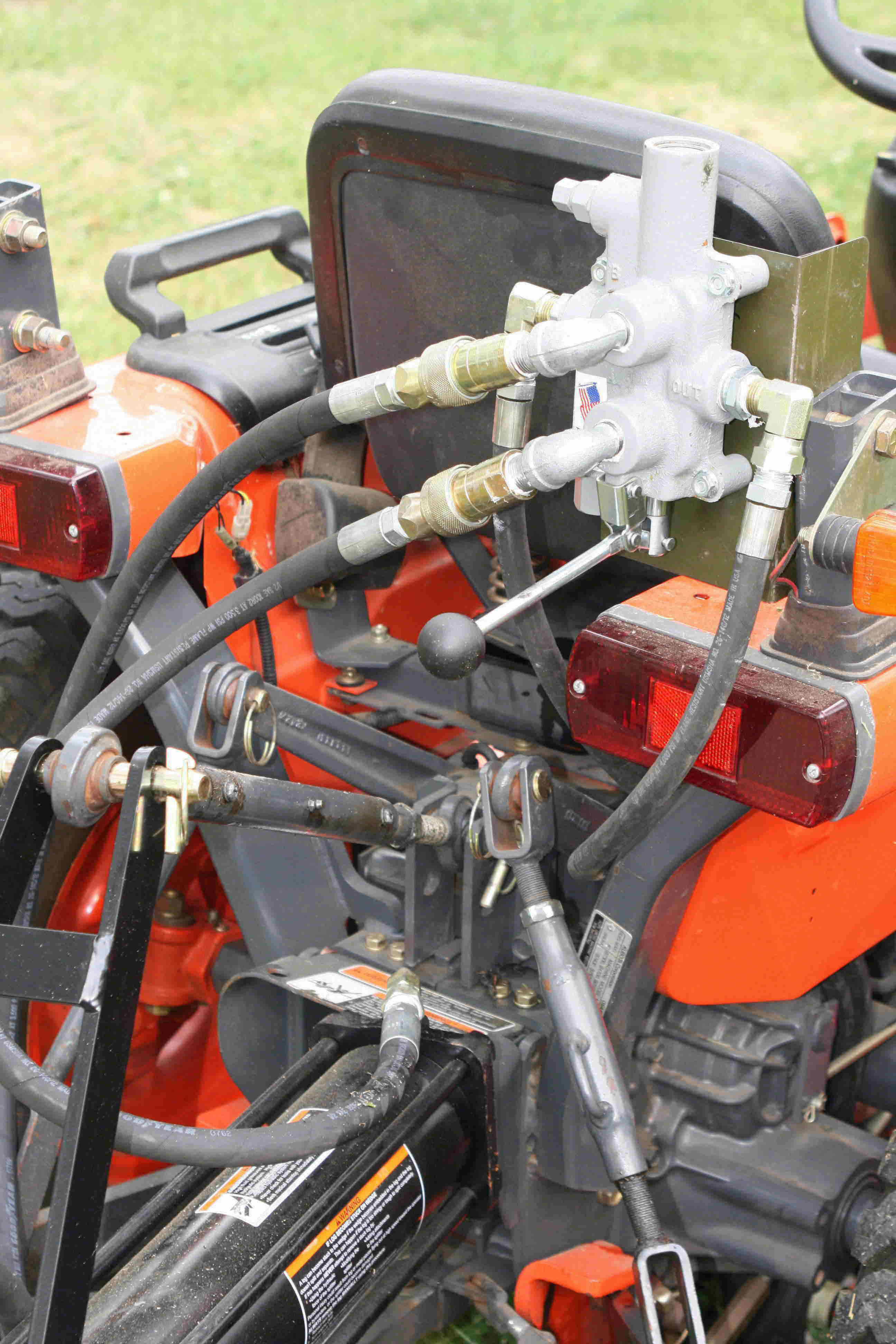

First of all, thanks to all who have posted information about hydraulics. I searched and used the info to determine how to operate a three pt. hitch mounted log splitter that was purchased fro Northern Tools. $400.
I did not want to have to remember to connect supply and return lines (from my FEL "power beyond" and back to the tractor) when the splitter is not in use, or have connections come apart accidently. That would damage the tractors hyd pmp. Of coarse, I first checked that the valve was an "open center" design. So I removed the valve from the splitter and mounted it on the tractor. Now I have a remote that can be used for other implemnts, although I don't know what else I would use. I'll try to post some pics.
Thanks, Scott

Scott,
Wow this is a really good idea
Could you post how you tied the valve into your power beyond (after the FEL).
I have the Kubota L3400 with the FEL tied into the the front hydraulic block.
The valve that comes with Northern Equip splitter is the Prince 3000, it doesn't appear to have power beyond connections to the rear hydraulics.
Thanks,
greg

Scott:
Neat job.
Your valve tank port appears to connect to the inlet port of the three point hitch, which means that the hydraulic fluid flowing through the valve powers the TPH as well. If so, when the TPH lifts an implement, the fluid pressure needed to move the implement will also be present in the tank/outlet section of the log splitter valve. Many valves have much lower pressure ratings on the tank section than on the inlet section, and are designed to be used as the last valve in a series where there are no downstream devices (cylinder, motor, etc.) to put sigificant back pressue on the tank section of the valve.
If these pressure limits are exceeded the seals at each end of the spool which keep fluid from leaking out between the valve block and the spool can be damaged, causing the valve to leak. The valve manufacturer should be able to tell you the pressure rating for the tank section of the valve.
I realize that you are lifting the log splitter with the valve in place, but the log splitter is probably light enough that the pressure required to lift it does not exceed the valve limits. However, a heavier implement, such as a rotary mower or lift platform, could require much higher pressure.

I'm with farmerford.. many valves do not like pressure on the outplet port.. that's what powerbeyond is for..
