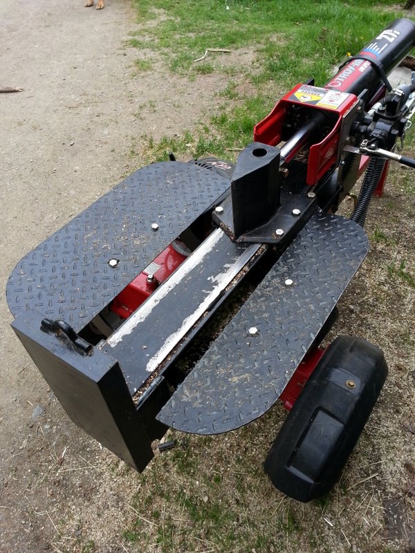

Well, I fashioned a retract limiter out of some scrap stuff. Here's the splitter with the adjustable retract arm -

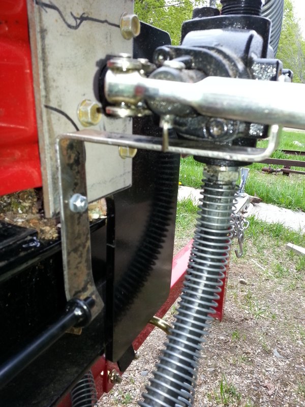

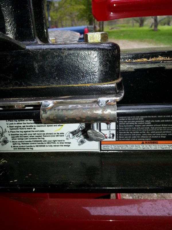

About all you really see here are the two extended wings to form a bigger table for the wood. But the retract limiter is there -

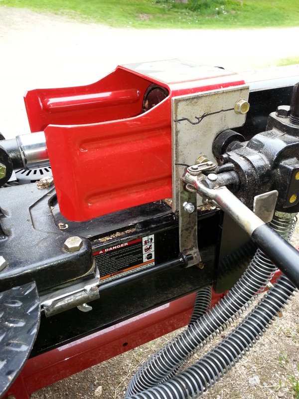

It consists of a length of rod whose position is adjustable via a thumbscrew. As the wedge returns the rod pushes against the bottom of the arm. The arm rotates and flips the lever back. Here are a couple more pictures.
So now I can split my 16" and 18" wood, and switch down to 12" for my neighbor's kitchen stove. When I get into some birch or smaller tops I cut it to 12" for his supply. Works fine. The other nice thing is that the arm can be pivoted horizontally, the rod will miss it, and the piston will retract fully for storage.
