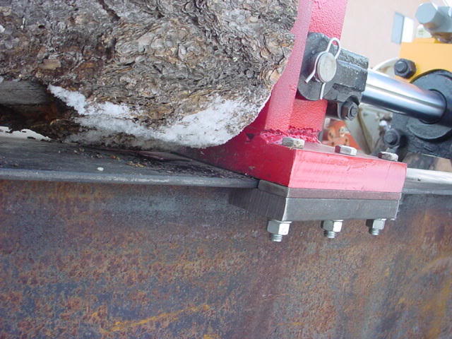

I started my log splitter project last night. What can you guys tell me about tolerances when attaching log pusher to beam? I have the angle cut to size and sandwiched around I beam. Have not drilled or mounted yet. Thanks
I borrowed this image form GuglioLS
   / Log splitter (pusher plate) tolerance #2
On mine its about .002 a little less than 1/32". Seems to work pretty well, with no binding.
