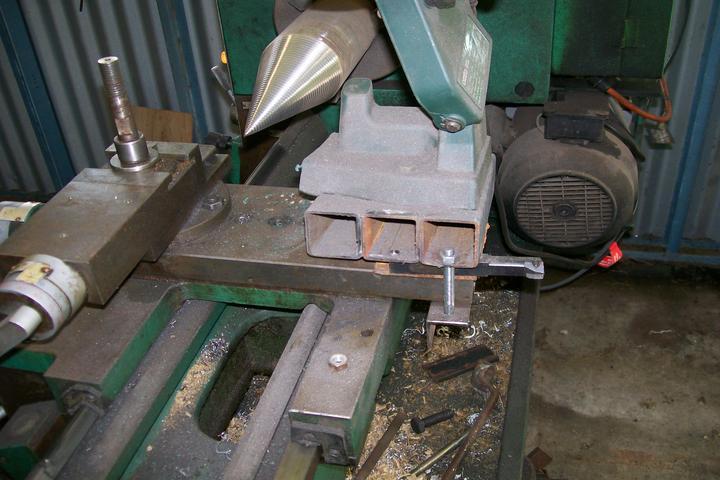

Hello All, I'm building a conical screw log splitter for tough Australian hardwoods.I'm still working on the gear reductions.I had the screw made at an engineering shop but it was not successfull, I believe this is because they used a live centre and could not get close enough to give me a small enough entry point.
I have a small chinese lathe and used a butchered $49.00 chain saw sharpener to cut the thread. This was very slow but I got there in the end.
I will try and post a short video.
Regards Vince

Hello all, Sorry I didn't get the video to work so I'll try and post a photo,
unfortunatly its pretty ordinary.
regards Vince.

Looks sweet, Vince!
Is the idea behind it to turn that into a log until it splits?
-rob
   / log splitter project #4
I just wonder if it's aggressive enough?

Hello paul, Yes, thats it. There are some good examples on the net, one being hydrocut. I must say there are some really scary ones as well.
Hello youmax4, If you mean the depth of cut, I dont think that was the finished item. If you mean angle, thats 15 deg ( x 2 ) and I think I would try something closer to 10 deg. If I was to do another. I have a 10 hp honda
gas engine with pulleys 100 mm to 250 mm then chain reduction 17 th to 57 th and it still grinds to a screaming halt. I intend to put in another lay shaft with 2 more sprockets 17 th and 57 th. when time allows and I reckon that
should do it.
regards vince.

Honda at 3600 rpm, x 2.5:1 belt = 1440 rpm, x 17/57 = 429. I think that's a bit faster than when I ran one on a truck axle at idle. Next stepdown, 429 x 17/57 = 128, your planned rpm unless I missed something. I think that's slower than you'll want it to run, and that would be lower if the Honda is turning slower. Sounds like you may need more power???

If you reduce the engine rpm down to say 600, which is a 6 : 1 ratio, the torque increases 6 times. 540 is the rpm of the tractor PTO conical log splitters, but then again, HP on a tractor is greater. Although you may start to screw the unit into a log/tree, at some point, resistance goes way up and the HP necessary to complete the split, goes way up.
If you get it half way in a really tough stump, and run out of HP, what are you going to do. Do you have a plan to back it out.

Jim, You haven't missed anything. I figured I'd rather it be a bit slow and have plenty of grunt and also something I'm not scared to use.
J.J. In trials with the higher gearing I did get some stuck fast but was able to
wind it out by hand.

Hello Jim, strangely enough a heavy machine mechanic (friend) also suggested I considered a flywheel. I will try everything else first because when/if I hit the kill switch I want to be confident it stops quickly.
I'm still fairly confident It will work because the "thread" is about 8 threads per inch. and this in itself is a form of gearing, so it should make the 10 hp more workable.( he hopes) I work it out at 30 sec + for a 12" log as I expect not to have bore in much more than half way.

Hello Folk, Its time for me to fess up. My cone was no better than the engineering shops. The extra reduction is spot on though.
My "tooth" profile was a bit like corrogated iron, not sharp enough, or deep enough I suspect. I deepened it with an angle grinder and tried to use a tapered file to sharpen it but still not good.
It will go in aways but then just churns out fine sawdust, then starts smoking.
I'm considering buying a cone from U.K or U.S.A. (with replacable tips) but cannot get through to those I've tried so if anyone can get me a contact I would appreciate it.
