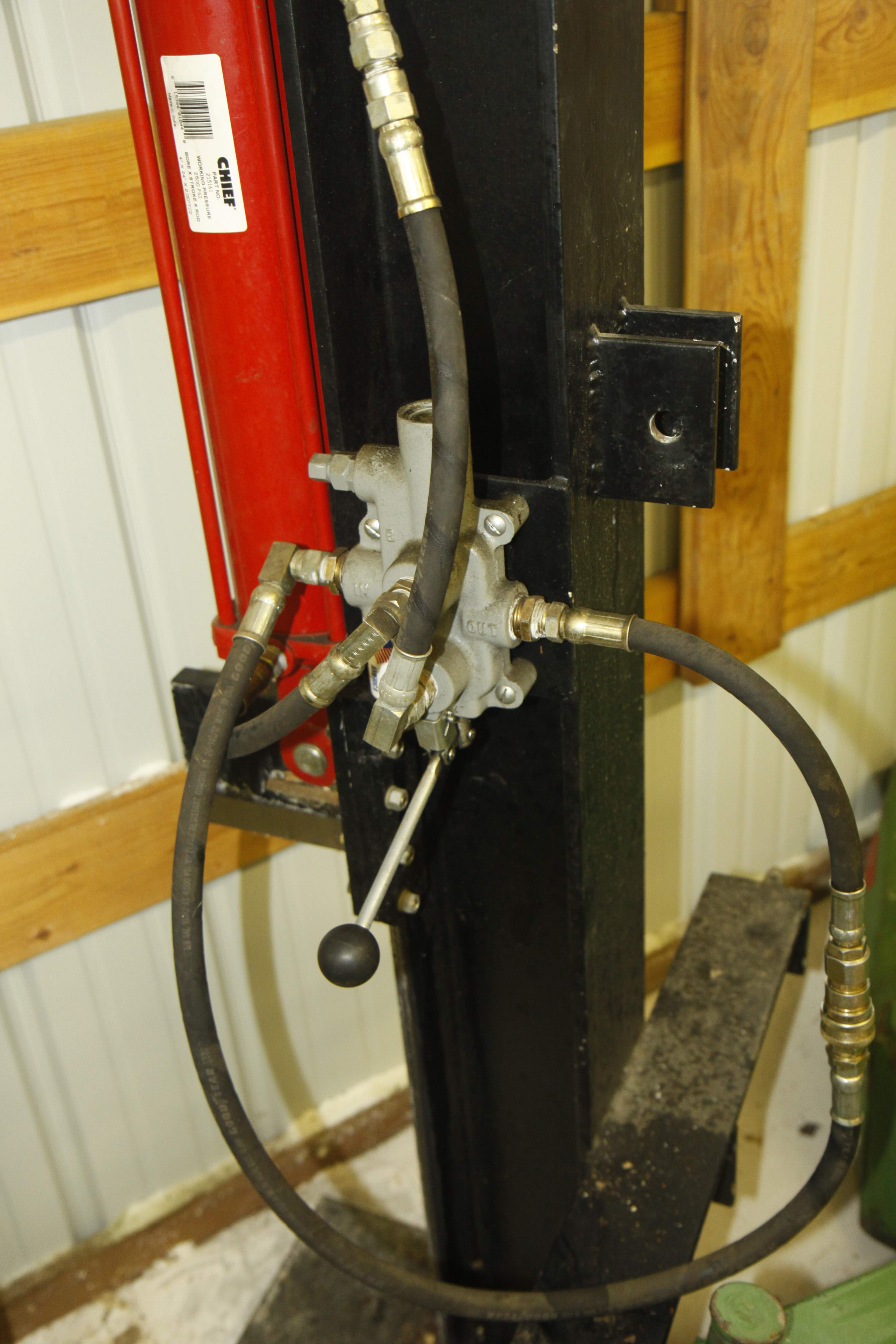

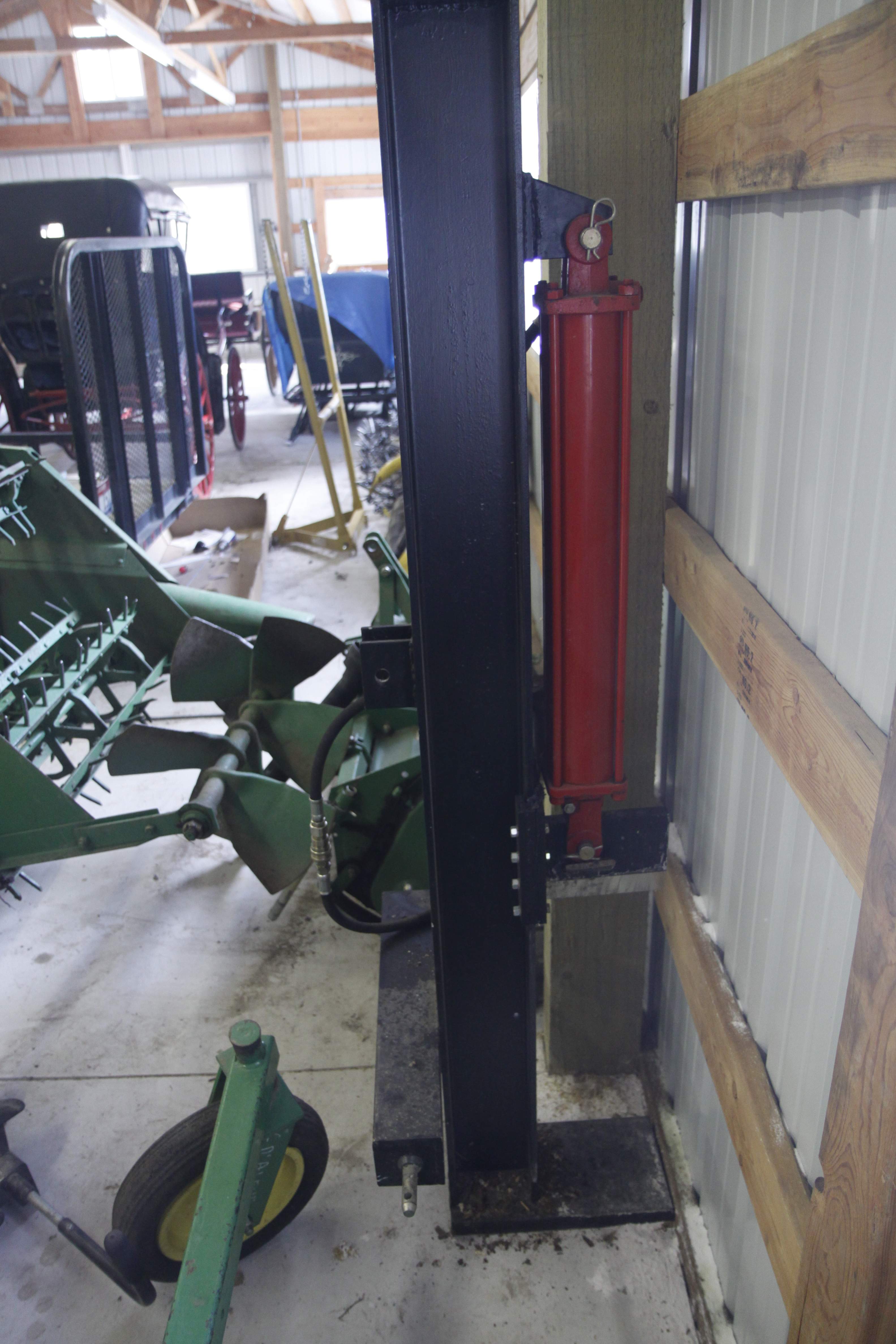

heres my home made version...has worked great for 4-5 years or so...cant really recall when i made this thing. i tried to make it with as few parts as possible........
Do you recall if you worked from a set of prints? I've inherited a twin to yours....Works great
/ LOG SPLITTER homemade 3point linkage #10
ya, i had a pic/plan for it i got from a friend. then did some mods on that. dont recall where those prints are anymore.

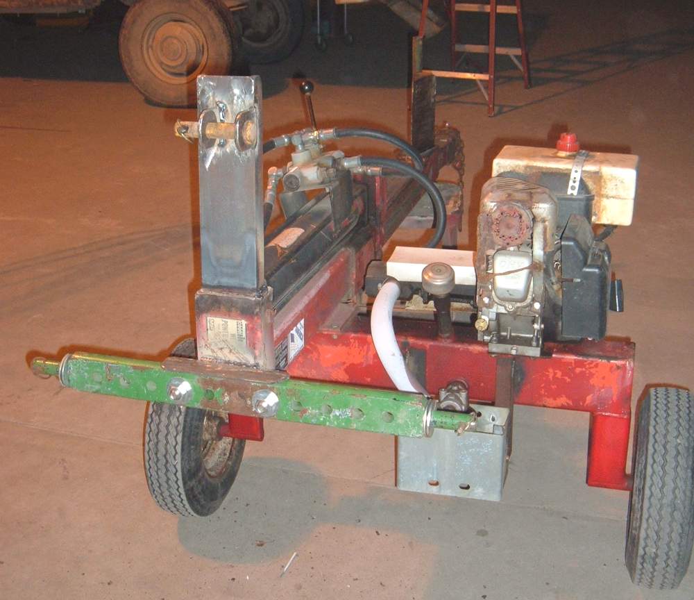

I added extensions to make it taller and to be able to bolt a bar on to make it 3 pt
