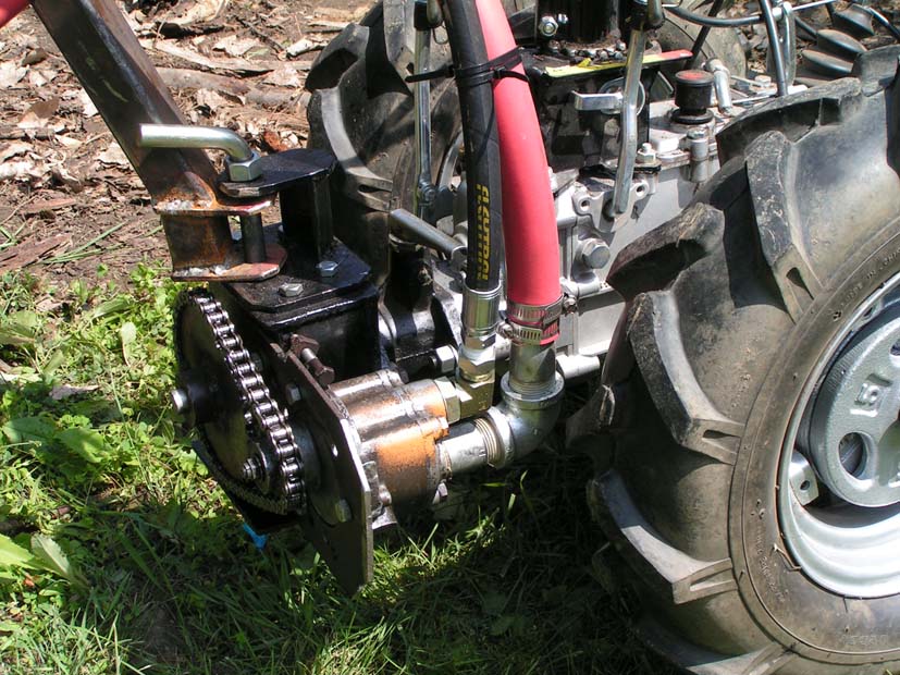

HI! On some two stage pump you can adjust the first stage pressure. At 3000lbs your two stage pump give about 4 gpm . But with no load 13 gpm . Is your valve a 20 gpm . or less. For suction you dont need high pressure hose. Short and large is better. I add a pict Good Luck Oldmech

yes I think it is either an obstruction in the lines, or the pump is stuck in the 2nd stage ( low flow) I know I didnt need high pressure for the suction, but I wanted something reinforced and petroleum rated and they had aleft over/ cutoff at the hydralic shop for 5 bucks so I picked it up. . Honestly had looked at clear nylon reinforced hose from lowes used for water lines, etc. but it was not petro rated. The suction intake on my pump is only 1 inch or I would have went bigger.
Looks like you have a pto driven pump on your tractor. I just use the 3pt t pick up my setup, it is basically a normal small engine powered setup without wheels ( intentionally, so it will never get borrowed while I am gone) so it must be moved with a tractor
