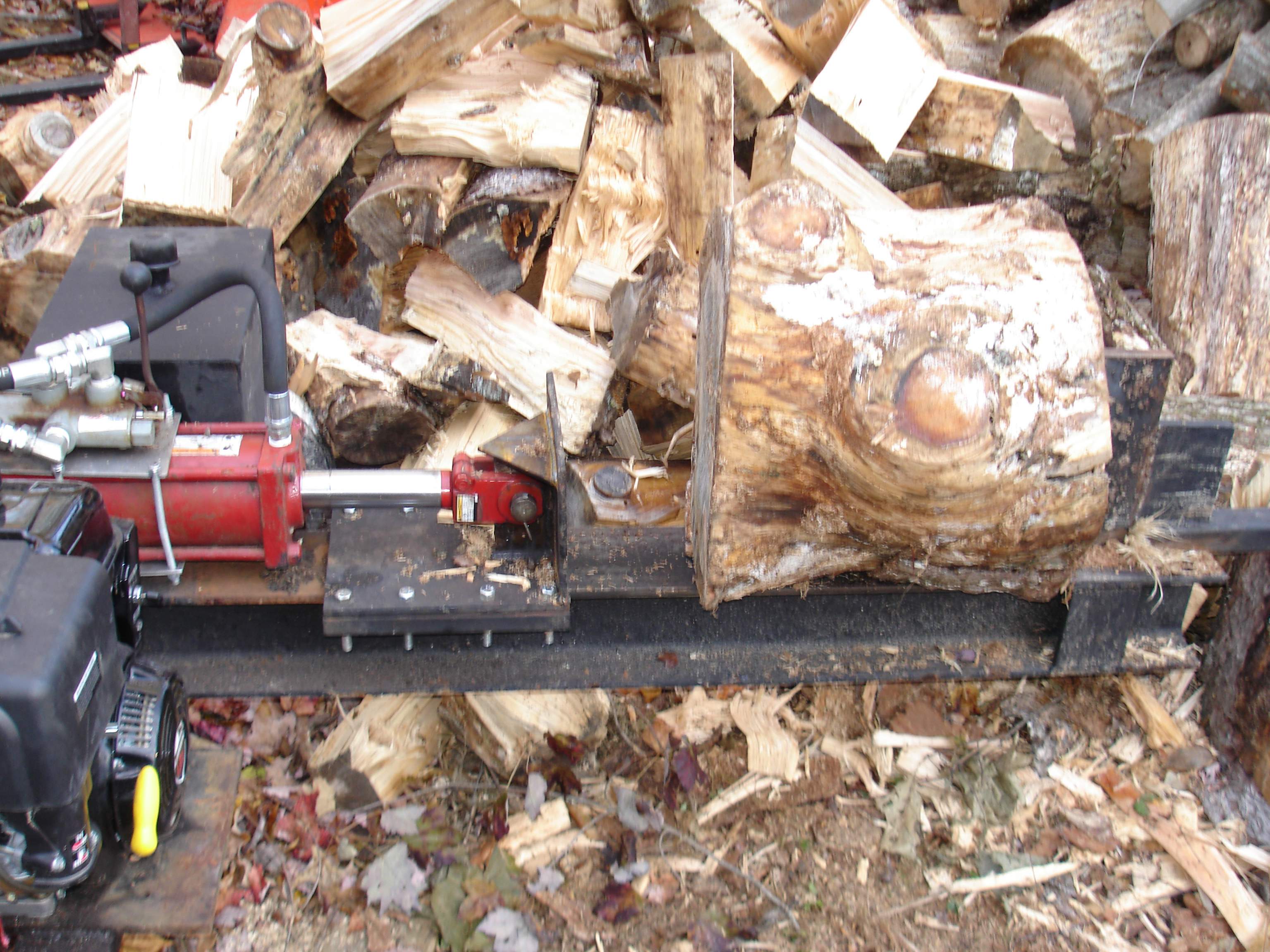

I built a home made log splitter, 13 hp 22 gal per min pump with a 5" cylinder and a prince detent valve all 3/4" ports. The hoses are 1 1/4" intake and 3/4" all the rest.It splits well and the speed splitting is great but it does not go back on its own with the handle in the center and a slow as heck when I pull back to return. I tried to turn up the relief pressure but it is still slow and does not go back on its own. My big concern with it is it was a valve that sat around for years and was rusty. I had to soak it in pb blast to get the valve to move. Is there any way to repair it or is it shot?

Pictures of the valve and hoses?

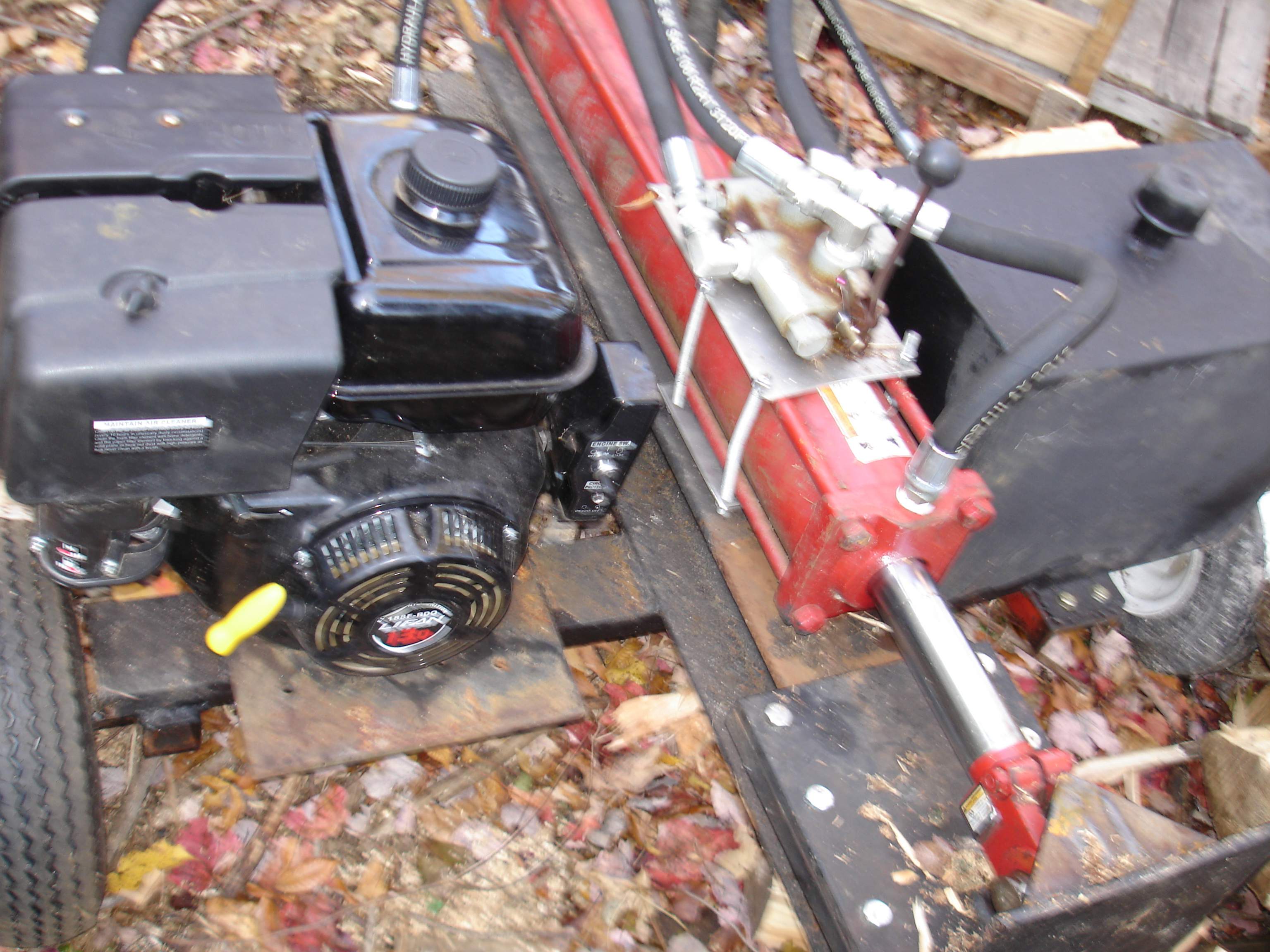

This is the first run for this. I am using it now but as said it is slow coming back, fine going forward. I could take the valve apart and see if I can find any stuff built up in there. As I said I had to flush it with PB Blast to get it to move. It sounds as if it struggles on return, engine revs up as it comes back. The tank is over 10 gallons. This was a project that sat a few years before I finished it, money was tight and it sat in back until I decided this year to finish it. 027.jpg028.jpg
/ Log splitter detent valve #6
I dont see a filter, is there one? The return for the extend and retact is in the same oil galley inside the valve. If the return was blocked it should effect both extend and retract. I am thinking you are not fully engageing the valve handle in the retract mode. A piece of trash or rust could be preventing the spool from fully shifting. Depending on where that trash is, it would allow the valve to fully shift in one direction and not in the other. I would take the valve apart and make sure everything is clean, I would also install a return filter if you dont already have one. You can try just pushing the lever a little harder and see if it will fully shift, but you risk damaging the spool. I would also check the return relief, some trash could be holding it in the open position and that might also explain the engine reving up on return. If it cant build pressure it wont lug down the engine.

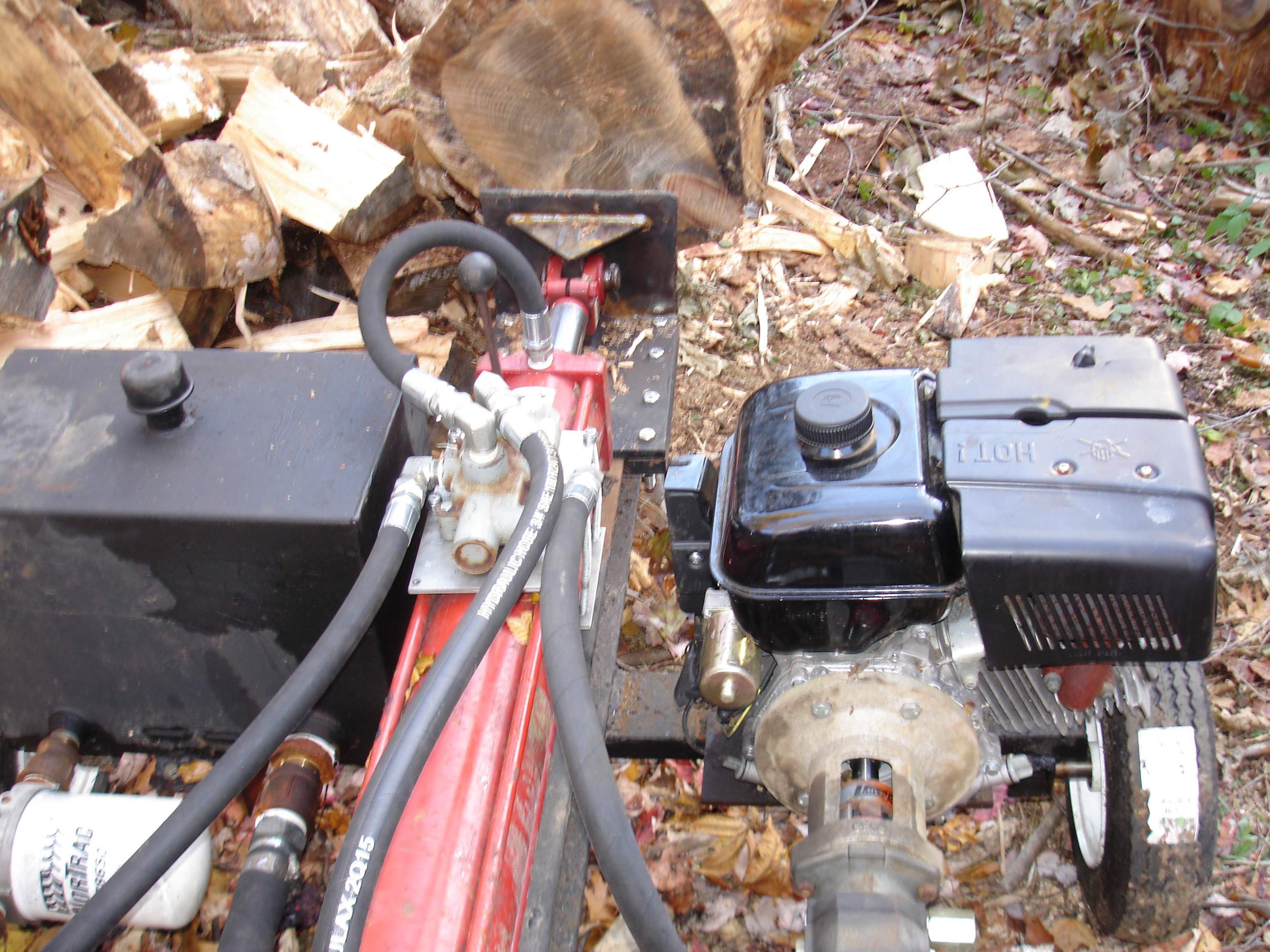

I have a large volume return filter and even a pick up screen on the suction side. With my luck the tank cap would come off and something would be sucked up. I will try taking the valve apart to see what's026.jpg up.
/ Log splitter detent valve #8
Try swapping the hoses to opposite ends and see if the problem changes from retract to extend. That would be a good sign there something wrong with the valve. You would have to loosen your fittings on the valve to make the swap, but if it is the valve, your going to have to take it off to disassemble it any ways.
