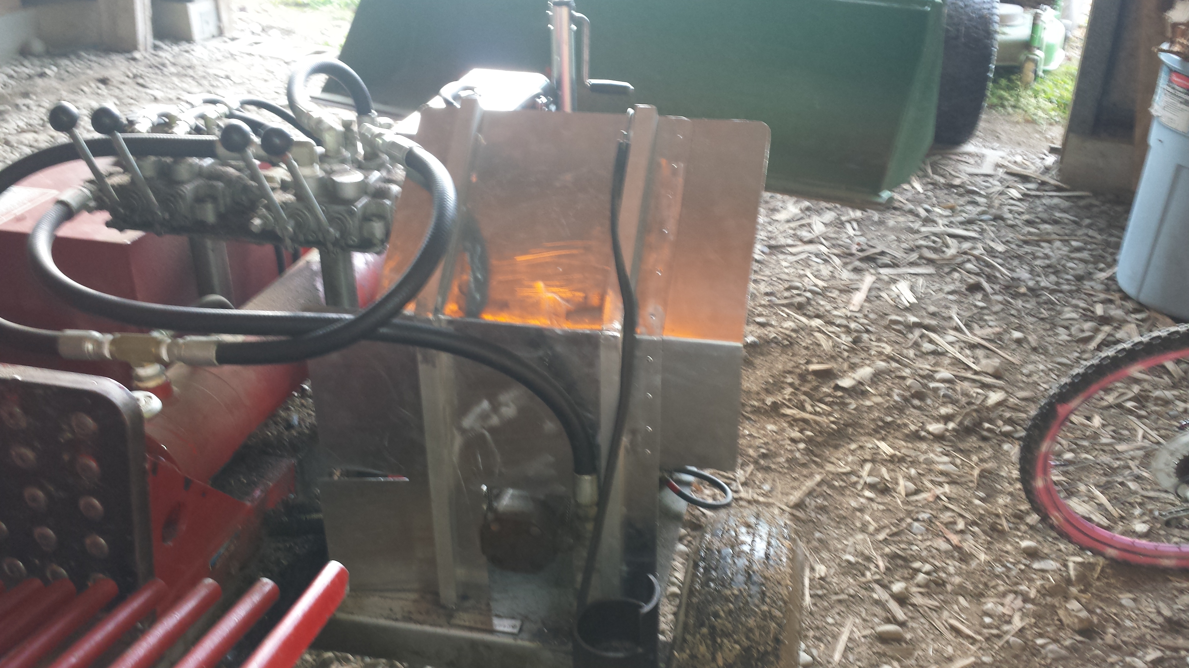

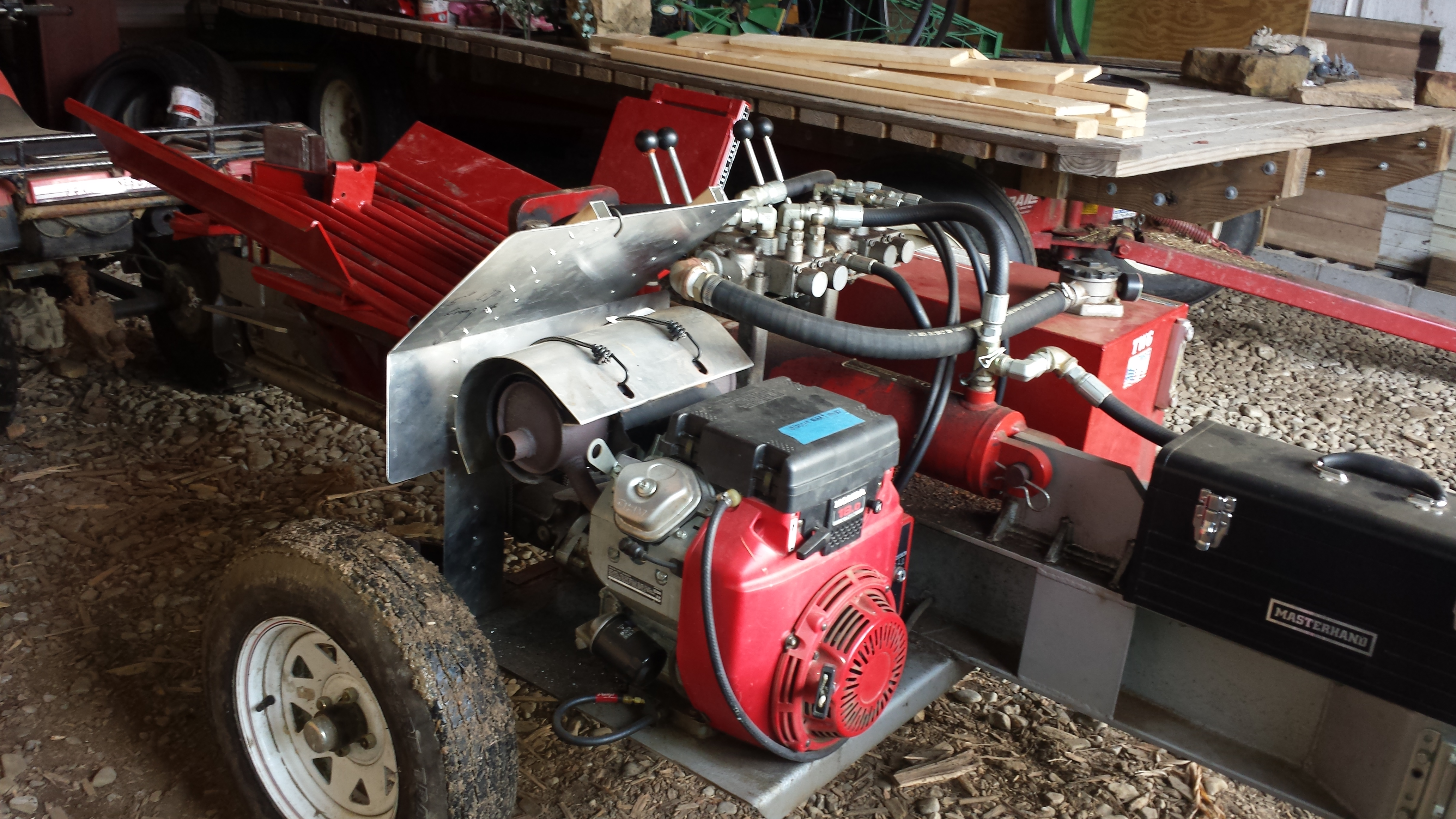

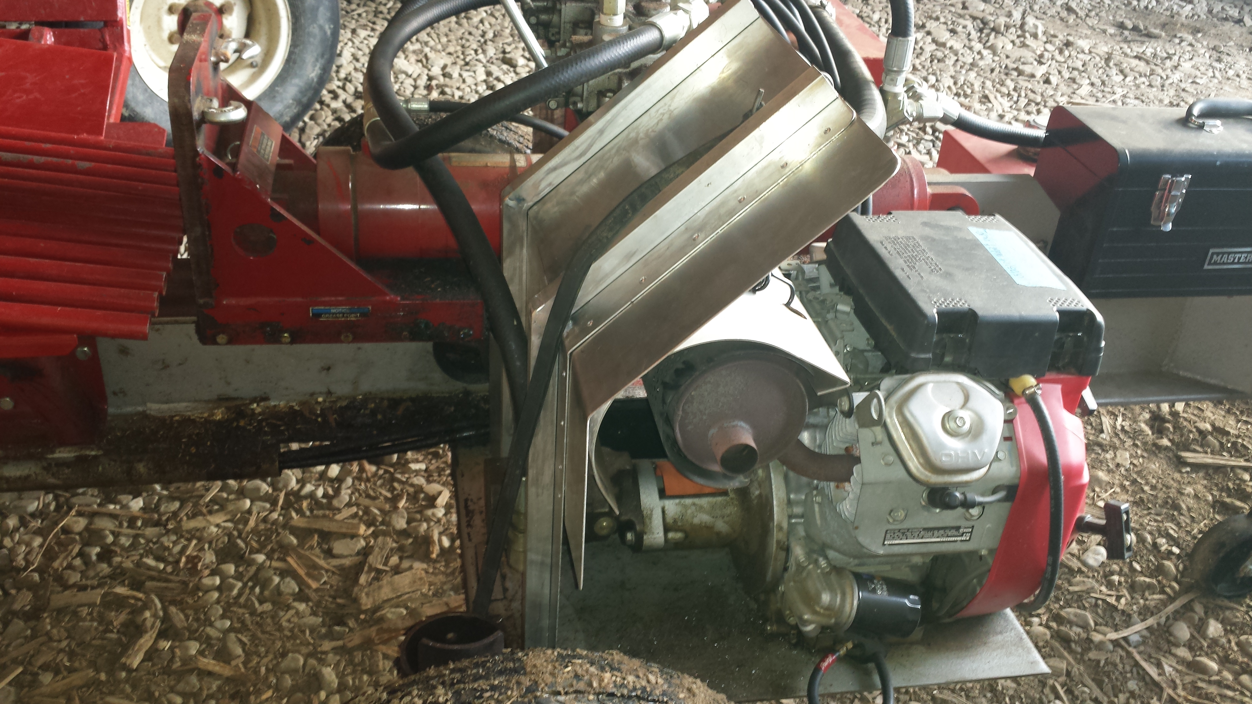

I had a good friend neighbor that had a tractor hydraulic powered 3 point splitter.
One day, as a Christmas present, I went to his house, "stole" the splitter,, and converted it to a tow-able splitter with its own engine.
The tractor delivered about 3GPM, I used a 13GPM 2 stage pump.
Well, after I returned it, to his garage,,, with a bow on it, the neighbor was super happy.
THEN,, three days later, my neighbor called,,, his church group was all UPSET!!
It seems that the group of old guys would get together, and, using the tractor powered splitter,
spend all day splitting two pickups full of wood for the old widows in the church,
When he showed up the the converted splitter, the old guys split 4 pickups full of wood,, in 3 hours.
It turns out, the guys used to enjoy standing around chatting while the slow tractor splitter cycled.
The tow-able splitter worked the old guys almost to death,,, and,,, they did not get to chat,,,, AT ALL!! :laughing:
I showed him how to slow down the engine,,, that helped a little,,
You never know the real intent of some people,,,:confused2:
:D
He did really like it,, and still uses it to this day,,,:thumbsup:
