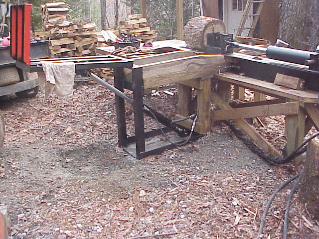

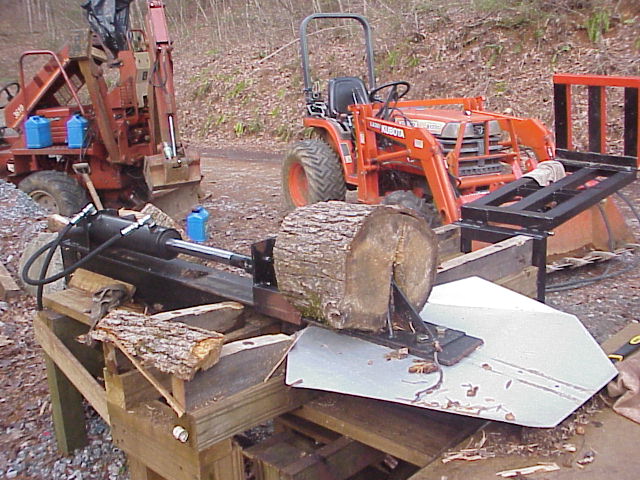

Just for some diversity (*I'll be reviving my thread on the topic soon*) so just a couple of pics +...
+: I set this up temporarily as a stationary unit...I'm currently running it off my Ditch Witch* or tractor...my plan is to make it a mobile unit...along with a knuckle boom arm that will either attach to the mobile rig or to a 3PH...I made the log lift to use before I get to the knuckle boom...and I made it vertical (not just to be different)...so it is entirely out of the way when extracted...I could not ask for a more ergonomic rig...either with one or two people splitting...
