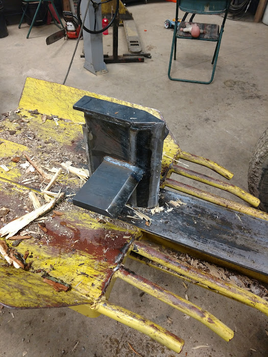

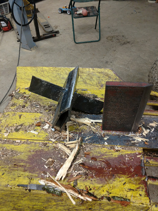

I’ve been splitting some wood lately and have revised my opinion on a 4 way wedge. On the right sized rounds I like it. It’s a little more critical you hit the round dead center with a 4 way or you end up with a piece that’s too big. It’s just slips off and on so easy so why not use it.
On really large rounds, I just quarter a bunch of them with the single wedge. When my work table fills up with those pieces, I put the 4-way on and re-split them with that. For rounds that aren;t quite big enough to do that process, but still oversized for a nice split one time through the 4-way, I will intentionally line up the log off-center on the four way so the vertical split is something like 1/3 - 2/3 rather than right down the middle. I'll toss any pieces that are small enough to burn, and run any other through the 4-way. (This one goes better with a helper who can pick out pieces for re-splitting appropriate for the wedge I have on at the time, but I do some of it on my own as well. If the sorting gets to be too much of a pain, I just revert to the single wedge, and double stack the re-split pieces when I can.)
