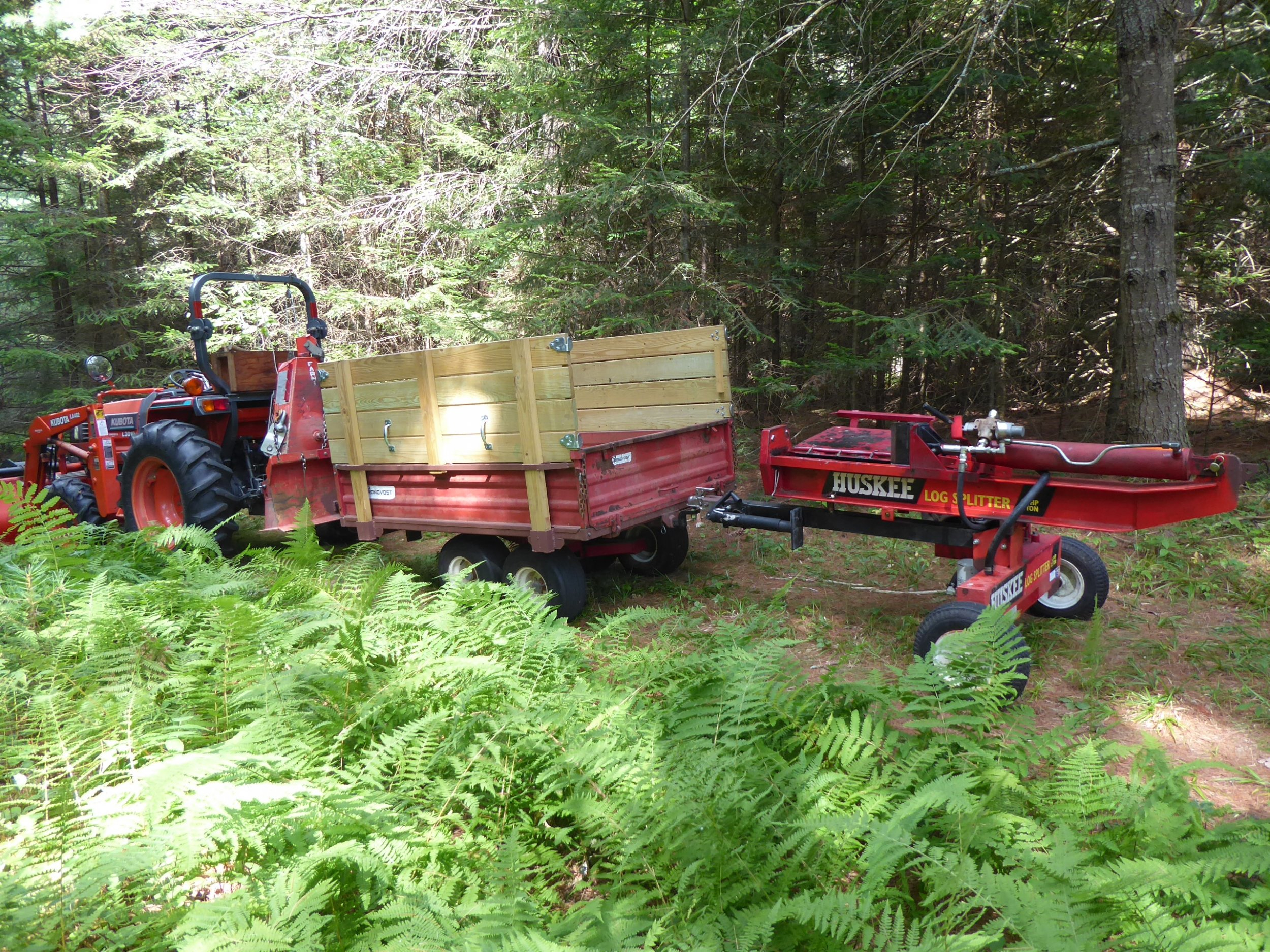

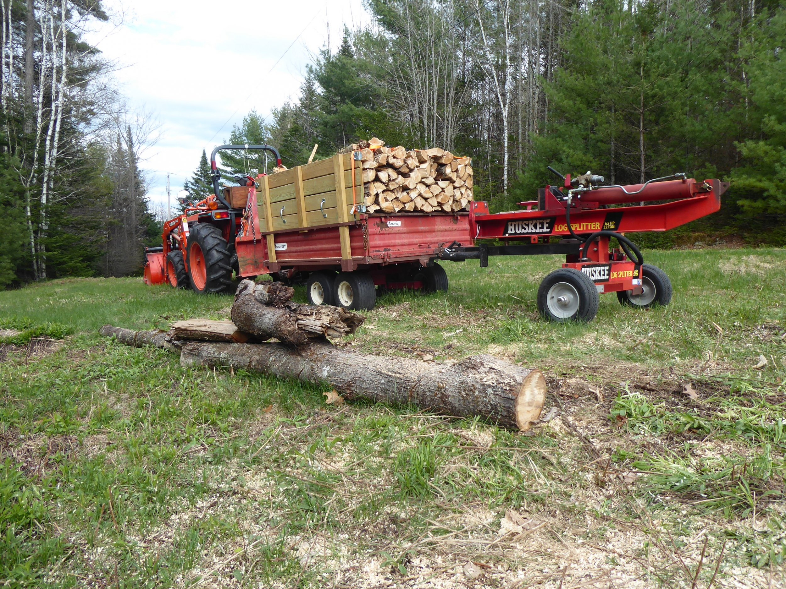

It sounds good but how far do you really get pushing the splits into the trailer. Not far I would guess unless you can load the trailer from the top. Other wise the splits will just start spilling off the table onto the ground when they meet some resistance. You won't get past the first layer before you have to start throwing it up front to make room. A waste of time. Look at SR's set up. He has the splitter jacked up high and the trailer is low to the ground but it does work. Not something easily done in the woods.
I work right at the back of the trailer and just flip the splits in and don't have to chase around the table and in the trailer separating finished splits from those needing splitting again. And those have to be carried back to resplit. To much moving around in my book.

Nice setup!
I really like your trailer and would like to find out little more about it if you don't mind?

Nice setup!
Thank you ! Don't mind at all. It's a Pronovost dump trailer model P-503 made in Canada and bought used and modified over time. It is spec'ed for 3000 lb capacity but will hold more. I added a 1-1/4" Reese hitch so I could pull the wood splitter.
I added some stake pockets and rub rails. And made some side boards. Also the front, side, and tailgate panels are removable on it.
That made it pretty versatile
