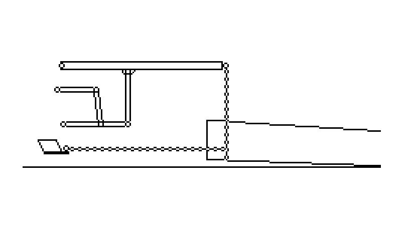

Any pull force applied to an object that might become immoveable(log hangs up on stump/root/rock) should always be from below the rear axle.
I have not had good luck with tongs and dragging. They like to pull straight. my pulls usually involve turns and negotiating other trees on trails. Using tongs, the log rolls around and the tongs frequently work loose.
I use a boom like mentioned to lift the log a bit to get chains on and off, and also to lift the front end over obstacles when dragging(see attached pic shown in lift position), but the pull force comes from well down below the axle on the drawbar assembly, and the boom is normally lowered to allow slack for turns without putting any side load on the boom. I also very rarely have a chain come loose from the log when dragging. The tongs might be handy for lifting, and I havn't tried that, but I don't think they would stay on very well during the drag if left slack.

The problem with using the lift arms is that the actual vector of forces back thru the hitch if the log hangs up, is somewere between the lift arm attach points and the toplink attach point, well above the axle. This can be dangerous.
They put that drawbar hitch way down below the rear axle for a reason...
As mentioned, The lift arms are not going to be very tollerant of side loads, such as when turning while dragging. They were just not designed for that.

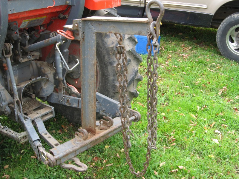

flIntlock; you can build something like this, It lifts the log off the ground just a bit and still keeps the center of gravity at drawbar level. The downside of the log will still drag on the ground, but it can still be cut without getting a lot of dirt on the sawblade.

Pretty neat piece of equipment. Not sure that it addresses the center of gravity issue and risk of rollover, though.
