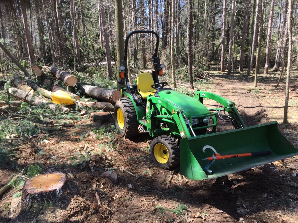

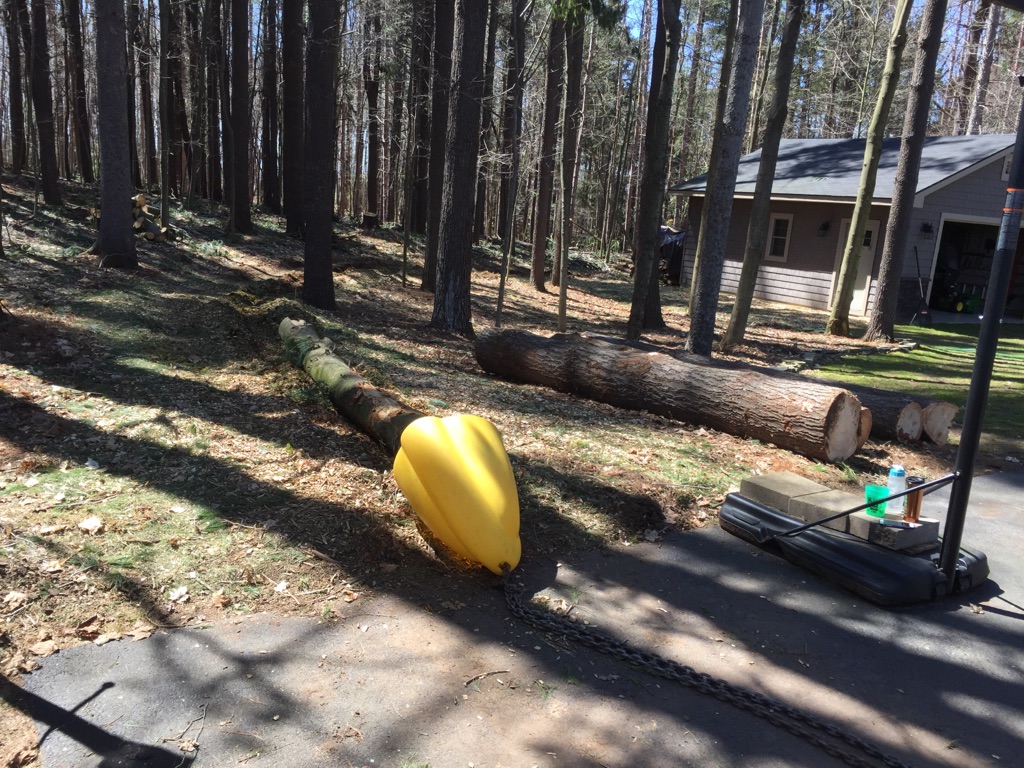

Tried out my new skidding cone today. Ordered it online about a week ago and received a nice discount with an online coupon. It was well worth what I paid for it already. It slid right around trees and stumps and made the job easy. As we've all said on here one time or another, I run out of traction long before I run out of power. I tried pulling a log without the cone once just to see the difference and it was obvious right away. A skidding plate would be nice but I'm out of storage room so I went for a chain and a cone.
